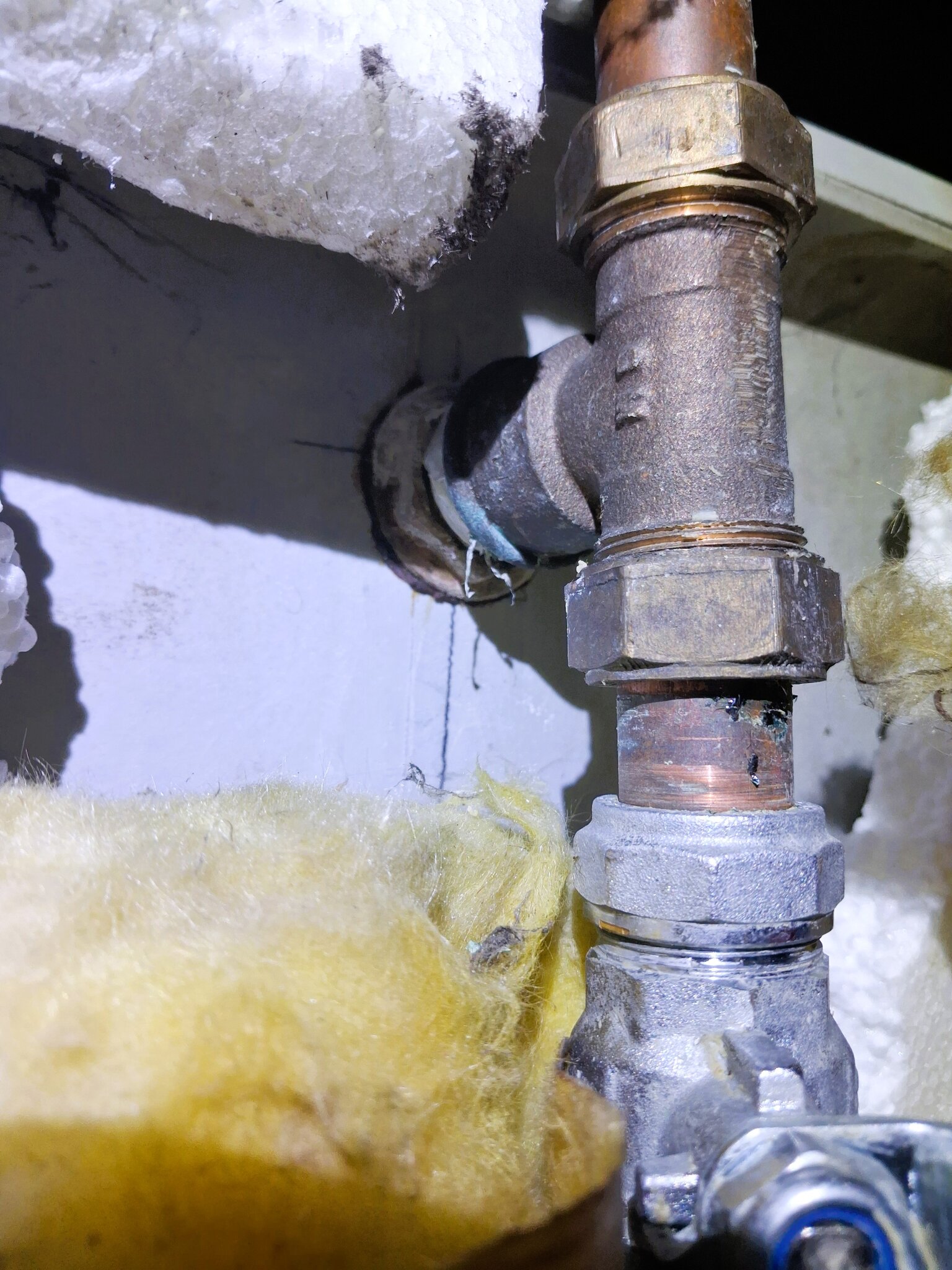

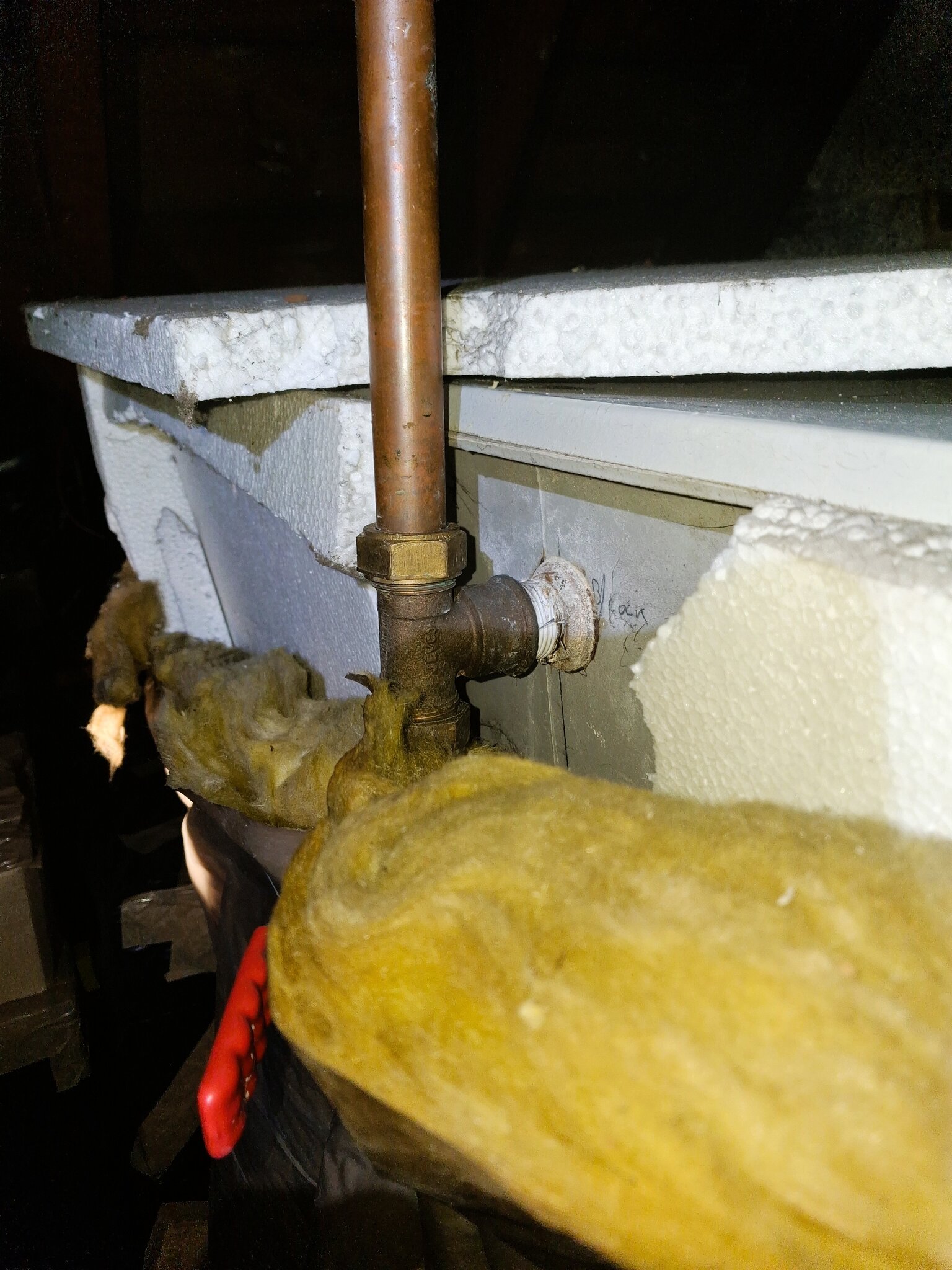

I am having another look into this old ball valve. The fittings and how it is installed into the water tank is not quite common or conventional.
Which tool would be best for releasing and taking it out? The nut outside of the tank which joins the T- connector in the pipe is very thin, and no wrenches I have can grab it, and apply force into it before slipping out.
The ball valve unit could be turned with a large monkey wrench or spanner, while grabbing the T-conntector? Or the nut? Which is better option here?
I am not also sure, if the T-piece outside of the tank is standard sized threading either. It is T connector, but the centre bit is not usual nut in the bolt. It doesn't move. Would new ball valve fit onto the T-connector?
Would it work if one wrench grabs the T-connector, and the other wrench turns the ball valve in the tank? Or the nut has to be turned first?
I would disconnect what you call the t connector from the copper pipes and the unscrew that off the ball valve. Once that’s off you should be able to get a pipe wrench, adjustable spanner or something onto the nut on the end of the ball valve and then unscrew the ball valve out of the nut.
More to the point, why do you need to remove the ball valve? Is it leaking?
Yes, two wrenches is the right idea. Hold the tee steady with one so you are not twisting the tank fitting, then work the valve body itself rather than forcing that thin nut on its own. If it still slips, take the tee off the copper pipes first like Lower suggested, then you should get a proper grip on the valve nut once it is clear.
Yes, the old ball valve leaks. Needs a new one. Thanks for the idea and advice.

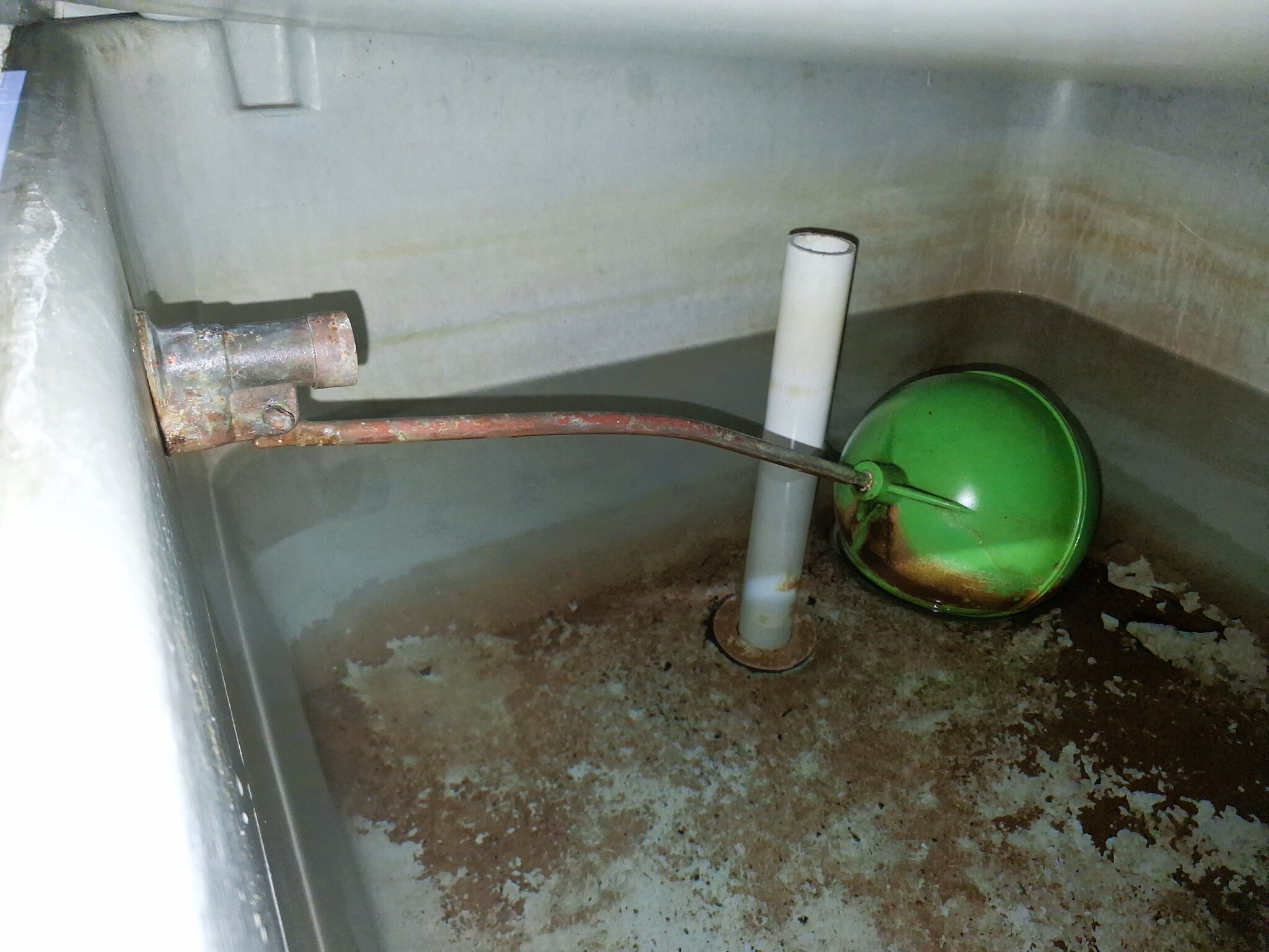

Why dont you just change the washer to stop the leak?

If it's just the washer, which it most likely is, you don't need to remove the valve. Withdraw the split-pin and remove the arm. Unscrew the end cap and remove the plunger. Depending on the type, you might need to unscrew the bit that holds the washer.
