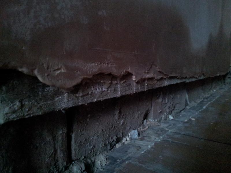

That is an example of what the walls look like now.
Well, that's pretty ropey! I suppose I'd consider knocking the snots off, possibly adding a packer strip (say strips of 4mm plywood with 1in oval nails) to the original grounds if they're any good, fixing a softwood rip to the wall at floorboard level (ripped or planed to match the upper grouund) and attaching skirtings. Any new stuff is better fixed with grip adhesive , broewn plugs and #10 (5.0mm) screws - you need 2-1/2in or so. How do the architraves look, or were they removed as well?
In one corner of the room there is a hole that could not be plastered because there was nothing behind it to plaster onto at the base of the wall. This hole extends about 8 inches above the floor, so I was planning on getting 8 inch skirting boards. This would also put the wood pretty much right in the middle of the skirting.
The plasterer could have made up a small frame from slate lath (2 x 1in rough sawn timber), boarded over with 1/2in PB then skimmed that as well. I have to ask why didn't he?
What you really should have done was to fix the skirtings first and the plaster could have plastered to the new skirting line.
I'd have to totally disagree with you there. Plasterers will tend to make a right royal mess of the skirtings if you do that, a mixture of snots, water run-off (from the polishing) and possibly trowel marks (damage) on the timber not to mention possible swelling and/or warping of the timber leading to cracking at the joint between the skirting and the plaster at a later date when the timber dries out. Skirtings are ALWAYS fixed after the plasterer is finished and the plaster IF AT ALL POSSIBLE. The rule was, AND STILL IS, wet trades PRECEDE joinery 2nd fix and THE WALLS MUST BE ALLOWED TO DRY OUT
If I can simplify this the battens are not for fixing the skirting boards, they were originally put on so that the plasterers had a straight line to follow for the backing coat.
The skirtings were then fixed using the timber plugs at the same points where the battens were attached.
Then the final skim coat was applied.
In other words your fixing points are already there, to fix using any other method is just creating unnecessary work.
Which book did you read that in? As an apprentice we used to put in skirting grounds just like the one illustrated, fixed onto propellor wedges (which the apprentice used to cut with a hatchet) - although the grounds looked like a ladder and were made up in long sections in the workshop and delivered to site; I suspect that when the OP's skirtings were taken out the lower batten simply went with it, if it wasn't rotted away completely (common problem). The plasterers worked to the ground and ALWAYS did their finishing coat BEFORE we put in the skirtings. The affect of allowing lime plaster (or even gypsum) wash-off in a final coat to run off onto an unpolished oak skirting would be to FILL THE GRAIN WITH WHITE LIME - a disaster which would result in the skirtings being "pulled" by the polishers/varnishers. And prior to WWII it was ALL lime plaster. It still is on many (listed) renovations and some better quality houses

Quite right! Were I starting that job I'd have pulled out the remains of the original grounds and propellor wedges and filled the gaps with a strong compo mix. I'd then have replaced the grounds fixing with modern screws/brown plugs before letting the plasterer loose. I'd also have given the plasterer very specific instructions on how to finish to the grounds. This isn't news to decent, trained plasterers - some better quality construction firms have us joiners build plasterers frames in door and window openings from plywood so that the plaster reveals will be near perfect - absolutely essentialwhen installing architrave-less casings (especially the ones with plaster shadow gaps). This plasterer possibly didn't know what he was dealing with because grounds like those are rarely used these days
