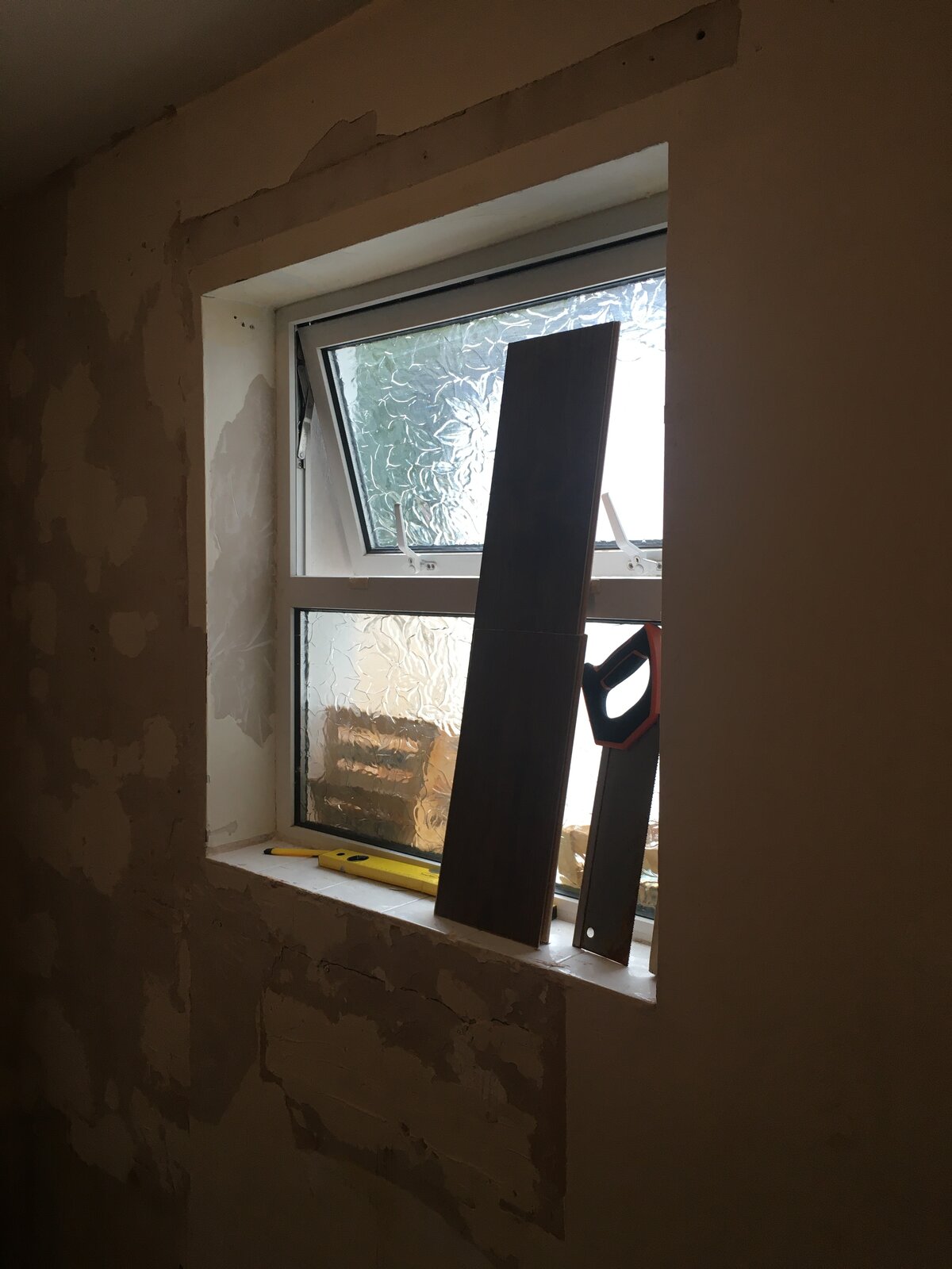

I’m getting a window fitted in another wall which is garden facing in this room which used to be a bathroom. Is there a way I can board over this existing window as I plan on wallpapering the room and don’t want 2 windows (it’s frosted and facing an ugly wall and serves no purpose)
I was thinking something like this with batons top bottom and either side then a sheet of ply/MDF?

Not a wind up no. I wouldn’t be using driftwood. It would be a sheet of ply/MDF board. That image was just to show the framing.

You leaving the existing window in place?
If it's a permanent measure you should do as advised by plastic peanuts.
Thanks. I was quoted £800 to remove window, brick, render remove sill etc. That’s not something I can afford. If I ever come to sell I can remove the board and have the window showing.
Frame and insulate on the inside, finish with gyproc tape and filler.
Leave external as is.

The way I read it he has cut out a new window in another wall.
He just wants the existing flushed off for decoration, reinstate if he ever sells.
