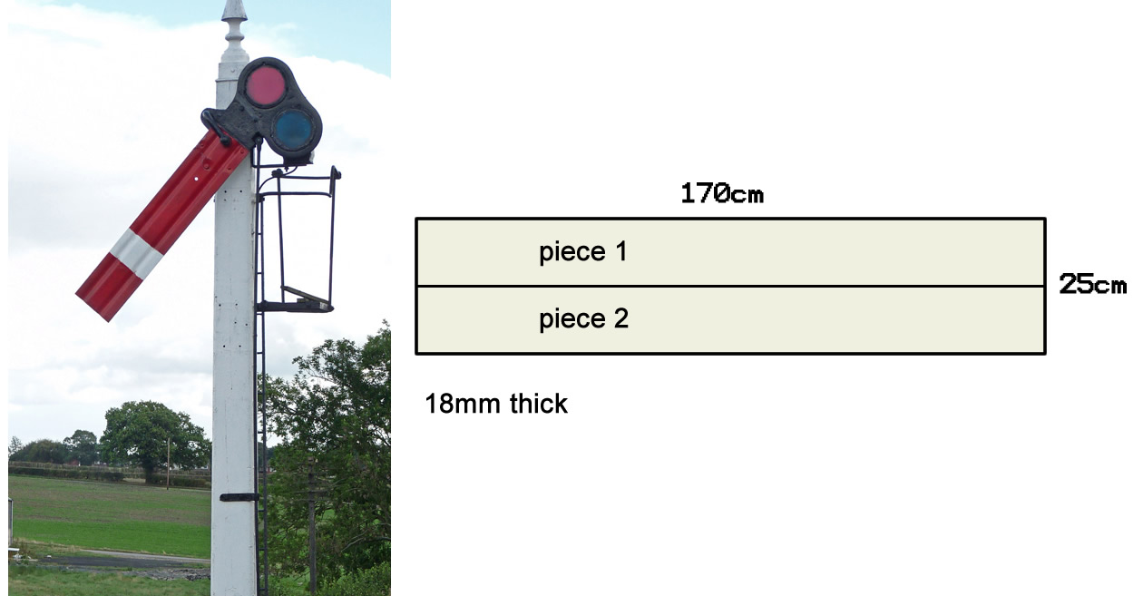

I am recreating an old railway signal arm to replace a rotten one.
Due to the size:
Length 1700mm, width 250mm, thickness 18/19mm, I need to use two pieces of cedar. Joined at the 19mm edge (1700mm long)
What would be the best way to join these together, taking into account the forces that it will be put under. As its a signal arm it goes up and down, and when it drops it bounces a bit, so a bit more stress perhaps. See image attached for context.
Would just a butt glue joint be ok, or is it advisable to do something else, like dowels? I don't have a biscuit jointer, but plenty of other workshop tools.
And is there a best glue people recommend for this application? It will be painted all over afterwards.

You don't need a biscuit joiner, you can make a tongue and groove with a table saw if you have one.
Do you have a table saw?
Why not buy a 250 width piece of wood?
Are you recycling? (Nothing wrong with it, just curious)
Hi and thanks.
I do have a table saw yes.
Also, I wasnt able to source any 250mm wide cedar. Max seems to be 200-220mm from about 15 places I tried.
I keep reading about how wood glues are super strong, so hopefully the join will be good, but any help to make it stronger to make it last would be helpful maybe? Or is it even worth it or is a basic glue join ok?

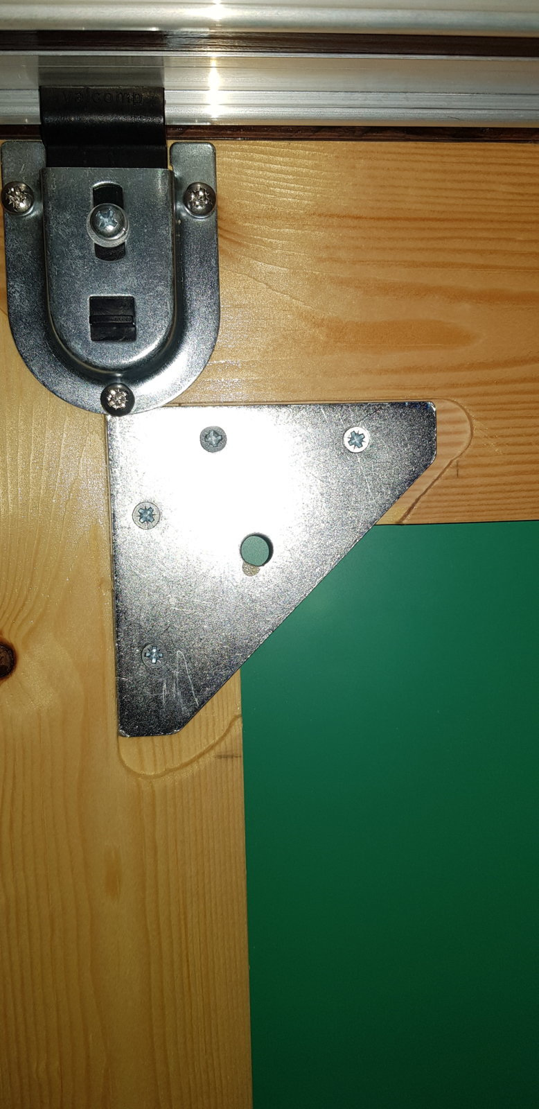

If only one side is for show, you could use metal plates on the underside, recessed in the wood.
Don't you love chiselling?
Actually I have seen a metal plate on the rear of some signal arms. As you can see on one end, the 'pivot' end is encased with the metal bracket, so the metal plate would be good for the other end.
Something like this.
This is the inside of a sliding wardrobe door, not extremely neat because nobody would ever look at it (1000mm doors).
Hopefully it's clear.
Your of course won't be an angle, but straight plates.
