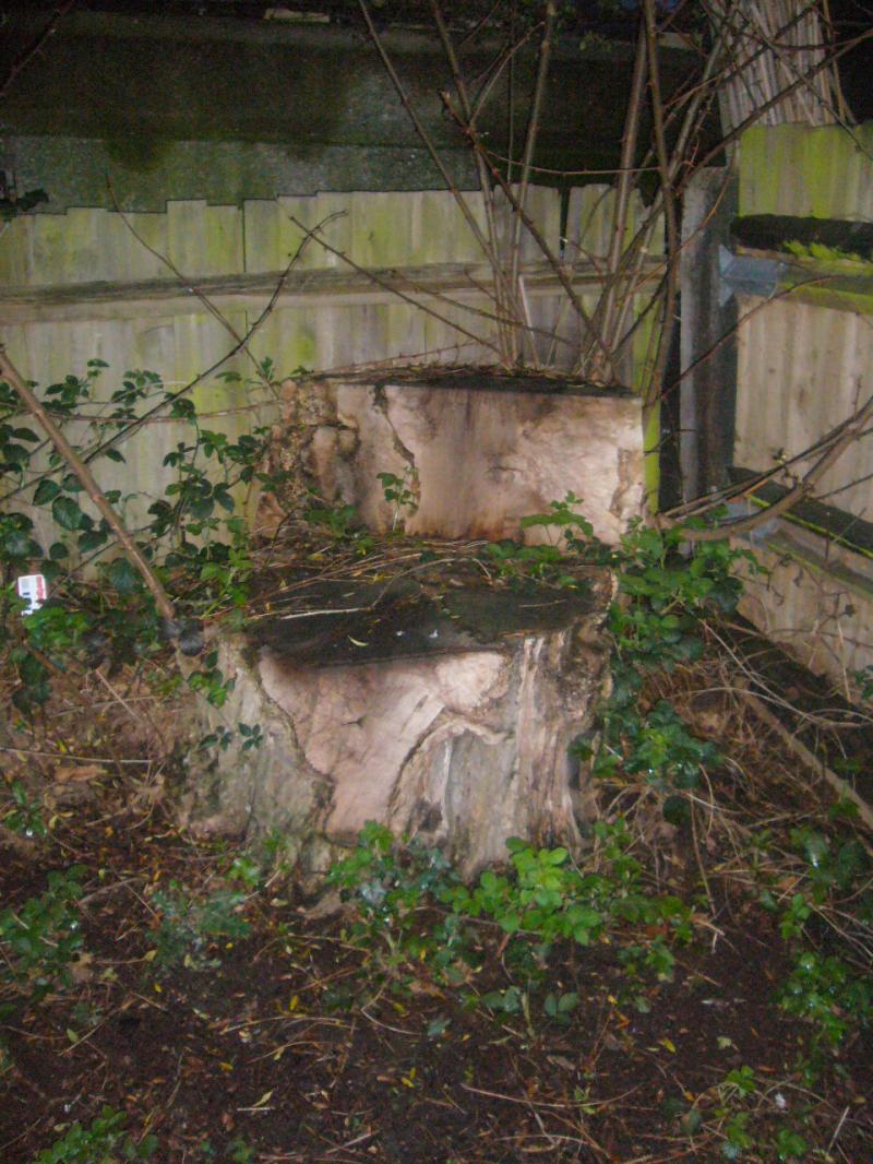

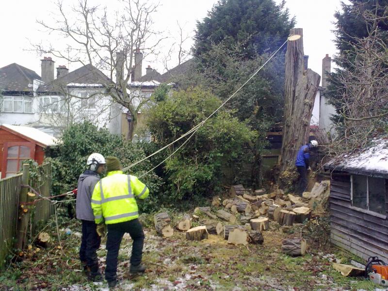

We had a large, dying/dead Robinia tree felled about a year ago. The tree surgeon couldnt remove the stump with his saws and said we needed a grinder. The problem is we only have access from the side alley for 60cm width, the machine is 90cm wide and I am reluctant to bring it through the house - he says the grinder can weigh 2 tonnes and I dont know if the floor can handle it.
Can anyone offer any helpful suggestions/advice how best to deal with it? We want to level the garden (it slopes a lot there) so ideally we want to get rid of it. However, it is in the far corner of my garden, so if too expensive/problematic, we could leave it as it is. Thanks a lot.
The stump is about 90cm high, diameter about 110cm and circumference about 340cm.

They did a fair job of getting that down in a small area - not the easiest trees to work on either.
You can get smaller stump grinders, much like little rotivators. They'll just take longer.
What about cutting it into a chair shape with a chainsaw? We've done that for a good few stumps and the householders like it (not so much a year down the line when it's covered in slime, but they can always put a cushion on)
And you /can/ grind any stump out with a chainsaw if you have skill and patience - and a crap chain you don't mind losing. Or just cut it as close to ground level and stick a pot plant on top of it.
But would these smaller grinders be able to handle a stump as high as 90cm? I thought they were only for much smaller stumps...
That's exactly what they did - have a closer look at the picture. I was hoping to see the back of the whole tree, however...
