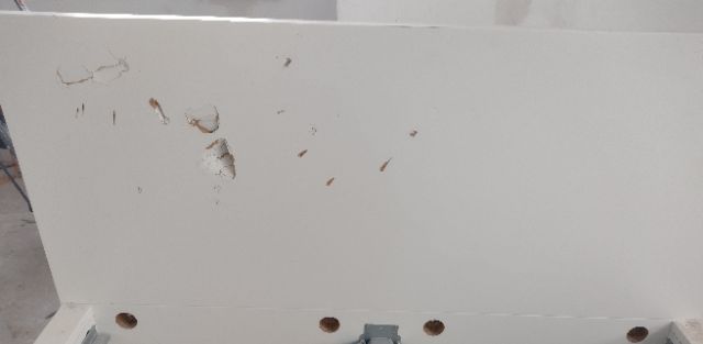

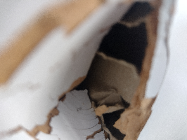

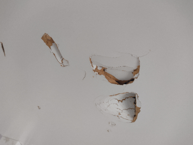

Ikea Malm bed has impact damage on the headboard and I wanted to know the best way to repair/salvage this.
The headboard is constructed with the following
- Particleboard,
- Fibreboard,
- Plastic edging
- Honeycomb structure paper filling

It could be filled and then sanded and repainted though I think you would need to fix something to the rear of the front face in order to get the filler to attach to something. Much as you would for a hole in plasterboard. Or as mentioned might just be easier to reclad it. If memory serves these types of Ikea panels are much like very cheap doors with a chipboard surround and honeycomb inside, terrible really but they work OK on the proviso they're not abused in any way, as is evident.
A piece of melamine cut to size and the glued over could work and be a lot easier than trying to fill etc
Thanks lads. Some great suggestions.
Think the easiest/quickest way will be to just clad it with something like 9mm Ply or melamine.
Cover it with fabric, or IKEA sell replacements
