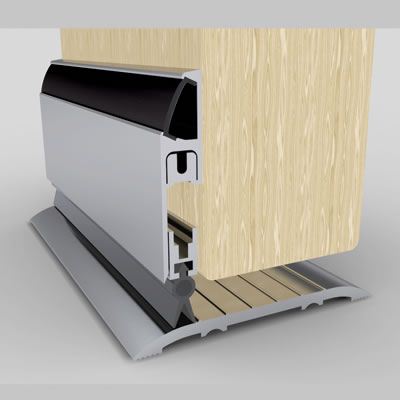

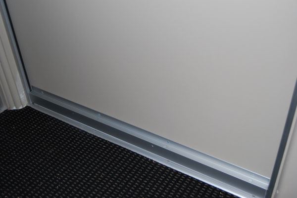

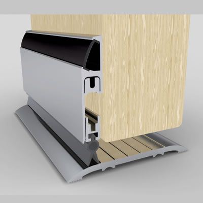

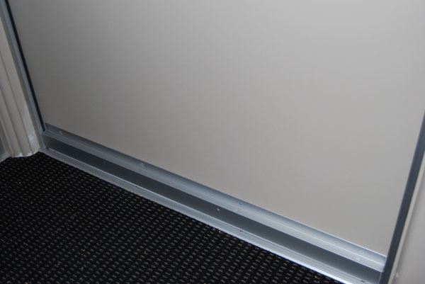

Buy a new 44mm FD30 door. Install acoustic strips to top, sides and bottom.
