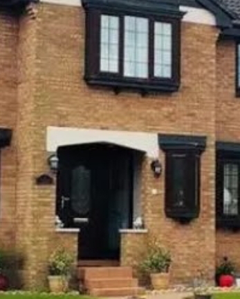

Hi all,
Our house is about 35 years old and is cold. Some of our radiators are full of sludge (I think) and although one room gets extremely warm within 30mins of heating going on, the rest of the house remains cold after 4-5 hours of it being on (12°C).
We're happy to spend money but only if it makes it better. I've ran Sentinel x400 through it but the difference is marginal at best.
In your opinion...
1. Get a power flush done
2. Get new radiators for only the ones that don't heat
3. Get all new radiators
4. Get a new boiler (approx 15 years old)
5. Put on an additional front door (realise this isn't plumbing but want to give the option) to make a porch at the front rather than just one door as the hall is always very cold. Image given.
What is best value?
  • Screenshot_2023-02-19-08-54-44-496-edit_com.google.android.apps.photos.jpg

What's your insulation like? That's a good starting point.

We definitely have insulation (there's wee grey balls everywhere at times ) but its something we can definitely look into. I took a wall lamp off today in the lounge and the draft through the small hole for wires was crazy - it felt freezing!
At 35 years old it is very unlikely that the walls are cavity filled. The loft insulation could do with doubling as well. Seal all holes around outside pipework entering house. At least then the home will retain heat longer.
