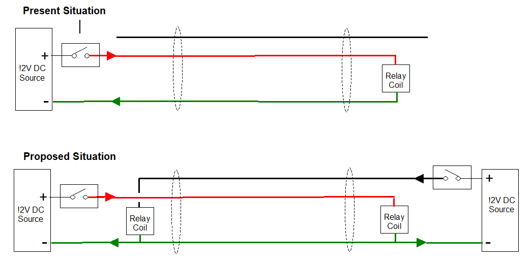

Hi there,
This is pretty basic! However, although I don't recall having thought about this before, I think I need some help in getting my thinking straight about what Mr Kirchoff would have to say about something I'm contemplating.
I have a control circuit which sends 12V DC to ('very') distant relay coil. I now need to add a further similar circuit, going 'in the opposite direction' between the same two locations, but routing a new cable would be a major mission, involving, for a start, extensive lifting of floorboards on two floors.
However, I note that the existing circuit uses just 2 cores of 3-core cable (flex), so I was thinking that I could simply use the 'spare' core for the new circuit, with one of the cores being common to both circuits. The present and contemplated situations are illustrated in the diagrams below.
The thing about the proposed arrangement is that current in the 'common' conductor would be flowing in opposite directions for the two circuits. If (as is far from impossible) both relays were activated simultaneous and if they were drawing the same current, the net current in that common conductor (the 'return path' for both relay coils) would be zero. I am therefore trying to get my head around the question of whether it would actually work.
A similar question would arise if we were talking about AC, but it's easier to think about with DC (and, indeed, DC is what I've got).
I suppose it would be very simple for me to get the answer 'by experiment' but, in the meantime, can someone help me get my thinking straight? Thanks!
Kind Regards, John

I don't see an issue provided both supplies are floating.
Nor did I when I first contemplated the arrangement, but then I started thinking (perhaps too deeply?) about what current would (or would not!) be flowing in the common conductor. Time to 'conduct the experiment' to satisfy myself that my thought processes were being silly, I think!

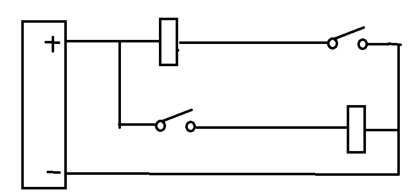

I think you are thinking too deeply. If you labelled the green line 0V at each end and at intervals all along then it suddenly looks clearer IMO.
<a diagram>
Thanks, bernard, but I am guilty of having 'over-simplified' for the purpose of asking the question!
Despite what I drew, the actual situation is not that there is a 12V PSU, with a switch on it's output, at both ends. The reality is that what is actually switched (by other things) at both ends is at mains voltage, and that switched '230V' feeds a 12V PSU, the output of which is permanently connected to the interlinking cable. For that reason, your 'single PSU' approach obviously cannot be used.

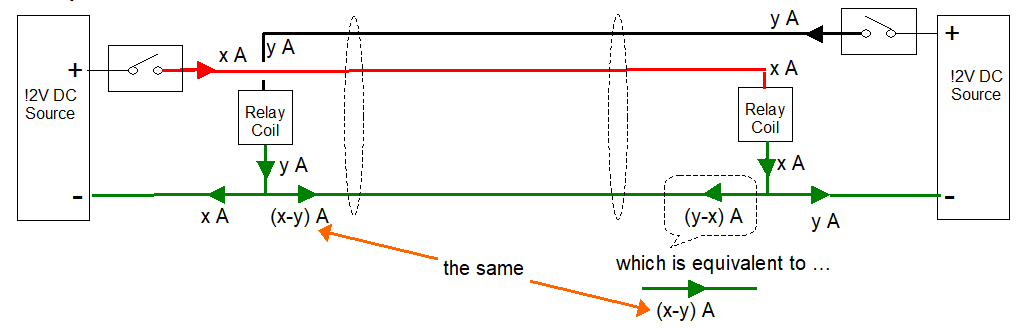

Kirchoff said that the sum of current at any node must be zero. It is in your case. The hard bit is to visualise why the current travels in the correct direction. If your 0V line was a ground plane on a pcb you would not even be able to draw it in a confusing manner.
That's very true - and is the very reason why I was initially perfectly comfortable thinking of 'everything green' as simply being "0V" (i.e. in effect thinking of it as a 'ground plane'). I'm going to think and scribble a bit more, and then will probably show my face again.

OK.
But divide it into 2 questions:
1) Will it works? YES
2) What happens on the common bit of wire? Are there 2 different sets of electrons each going in opposite directions, or do no electrons at all flow in that piece of wire? Or...
OK. But divide it into 2 questions: 1) Will it works? YES ...
Indeed, and that's what I have assumed all along - it's when I started "thinking too deeply" that I got onto the "Why" (theoretically-speaking) question.
... 2) What happens on the common bit of wire? Are there 2 different sets of electrons each going in opposite directions, or do no electrons at all flow in that piece of wire? Or...

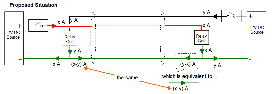

No electrons moving at all, I presume (assuming relay currents are identical). I think I've now convinced myself about the theory (see diagram below). When relay currents are zero the, per Kirchoff, the flow into/out-of either end of 'interconnecting conductor' is zero, hence presumably no reason why any electrons should have (net) movement.
Kind Regards, John
