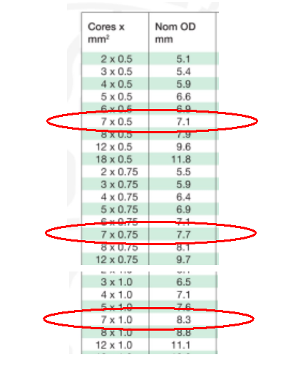

≥6-core flex?

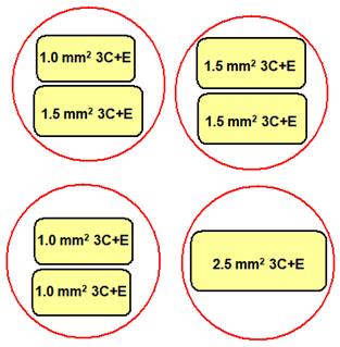

I dont think you'll do it it looks similar to my house and those conduits are about 16mm, ok for a twin and earth but not much more.
Are you talking about the (black-cored) TLC YY? If so, the 0.5 mm² and 0.75² versions are seemingly tiny and more than adequate (even if perhaps arguably 'non-compliant'), but even 1.0 mm² is only 8.3 mm OD. Are you really suggesting that might be a problem? ....
If you had it on a bench possibly no problem, installed reaching under floor etc not so easy but....
All you can do is try....plenty of yellow 77 might help
