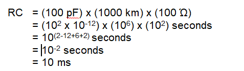

Quite so. Apologies for any diabolic errors from hasty mental arithmetic, but at a first try ...
... assuming 100pF per metre and a (!2V) relay coil resistance of about 100Ω, I reckon that the stored charge in the capacitance would keep the relay 'held in' for approximately 10 μs per km of cable - so for about 10 mS with a 1000 km cable (London to Edinburgh?).
Kind REgards, John

Yes, that will obviously depend on voltage. For example, if it were 'mains' voltage, it would probably be more like 2,500Ω. However, if my calculations were correct, that would still mean that the energy stored in a 1000 km cable (on reflection, probably "Lands End to John O'Groats", rather than London-Edinburgh!!) would only hold hold the relay in for about 250 mS (quarter of a second).
I therefore suspect that there is some other explanation for what you observed, although I don't know what!
Kind Regards, John
For the record John, my spice simulation bears your calculation out. You didn't take inductance into account, but I can't see it making that much difference. Who knows what was going on.

Thanks. However, given the easy numbers I picked, it was far from rocket science - simply multiplying together various powers of 10 (i.e. just adding together the powers), which even I can usually get right in my head :) ... (pasted in, since the forum software appears not to understand the [sup]...[/sup] BBcode construct!) ...

It could - or lower. I obviously had to pick some 'ballpark" figure for my rough calculations (and chose a nice round one!).
However, don't forget that my illustrative calculations were using ridiculous cable lengths (1,000 km) and, even then, were resulting in extremely short discharge times. To store enough charge to keep a relay 'held in' for just a few seconds would need the capacitance to be tens or hundreds of thousands of times greater than 100pF per meter (i.e. maybe 1-10 μF/m) with sensible cable lengths (and quite probably an order of magnitude higher than even that for any cable length that was 'sensible' in the context of a DIY forum :) ).
