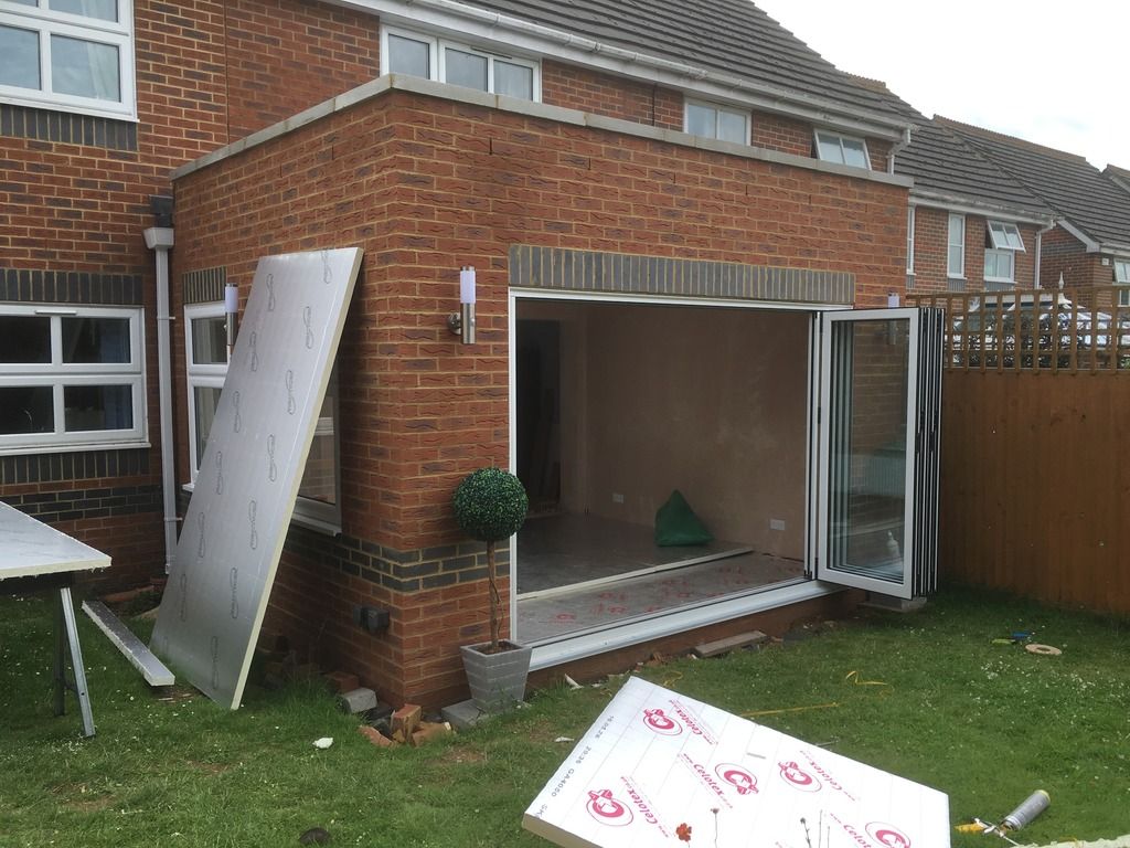

Im just in the process of having some 5.5m Ali bifolds fitted by a local company who have a very high reputation in our area for quality , they have used this company www.prefixsystems.co.uk (which use smart Aluminium bi folds) to supply the doors . Id never heard of them through all my searches for bi folds , but i know this install company will not use inferior products so they must be good.
looking at the doors and the fittings that have arrived they all look brilliantly engineered and good quality .
one thing i will say is that its not just door quality as i think most ali systems will be a good quality..... its the quality of the install and the team that are doing it and the opening that the doors are going in to counts more than anything.
that looks very nice. How do you find the aluk kit?
