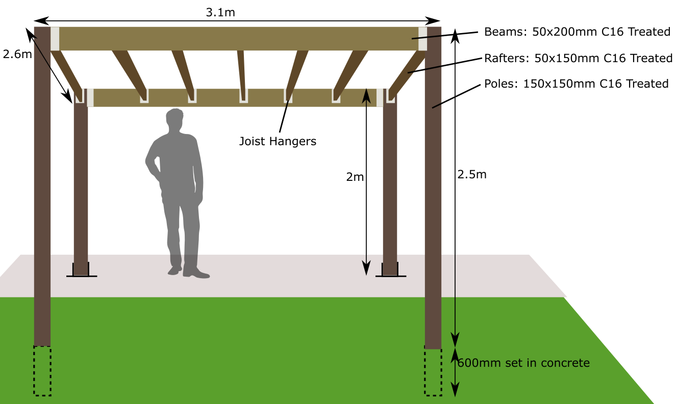

I'm building what you may call a BBQ shelter - it's 3mx2.6m and is essentially a roof held up by 4 poles.
I want to check with someone if I'm doing it right, will it stand up to storm and snow?
It has a mono-pitched roof with 10 degree slope running from 2m up to 2.5 meters. I'd like a greater slope, but can't within UK permitted development and I need to be able to stand up under it.
Picture attached showing what I'm planning to do.
Any advice or gotchas I need to be aware of?
There will be a roof on top that I didn't draw on the below picture - probably ply and felt.
Looking at this picture after posting it - would angled braces where the poles meet the beams allow the beams to go down to 50x150mm?
Defiantly add some bracing, either timber or metal strapping, it adds a lot of strength.
If you put the posts deeper in the ground it makes it a lot stronger - probably doesn't actually need it though
I've built bigger structures using smaller sized timber, and they're still standing. Currently almost finished a patio/bbq roof which is 8.5m x 3m.
