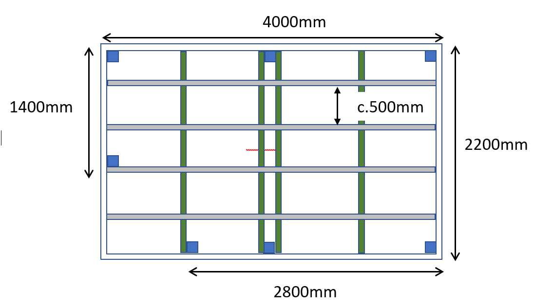

I have an outdoor cooking area with a BBQ and Pizza Oven. It generally only gets used in good weather as preparing pizza dough when it's ******* down isn't a good idea.
The area I'm looking to cover is 4m wide by 2.2m deep. The roof will slope on the short length. I intend to cover the roof with 2440mm x 840mm Corrapol Stormproof Low Profile polycarbonate sheets.They need to be fixed at 500mm. I'm not looking to build a shed so the sides and front will be partly open.

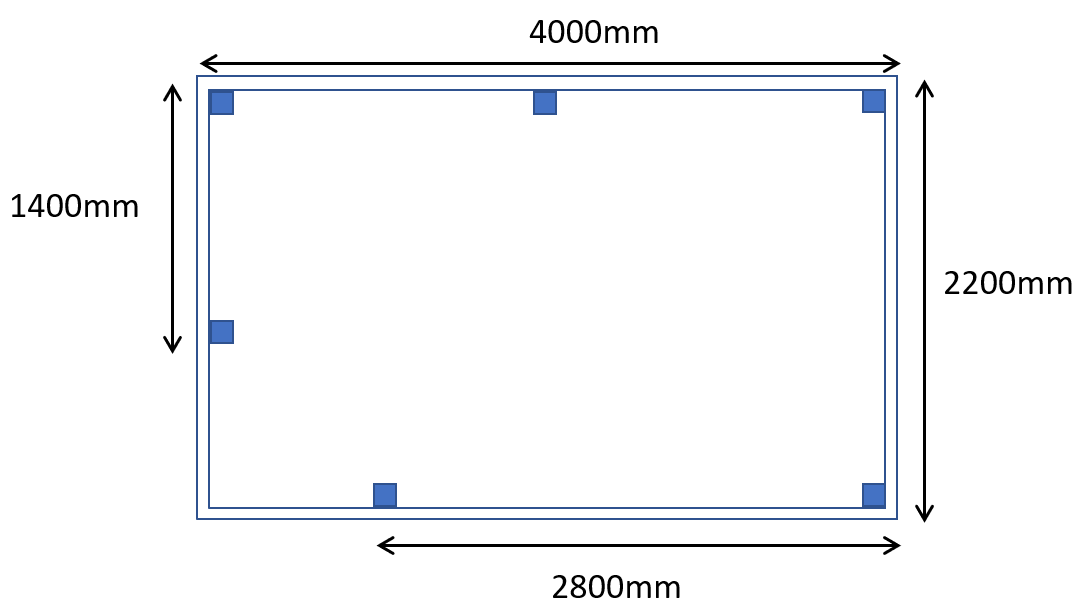

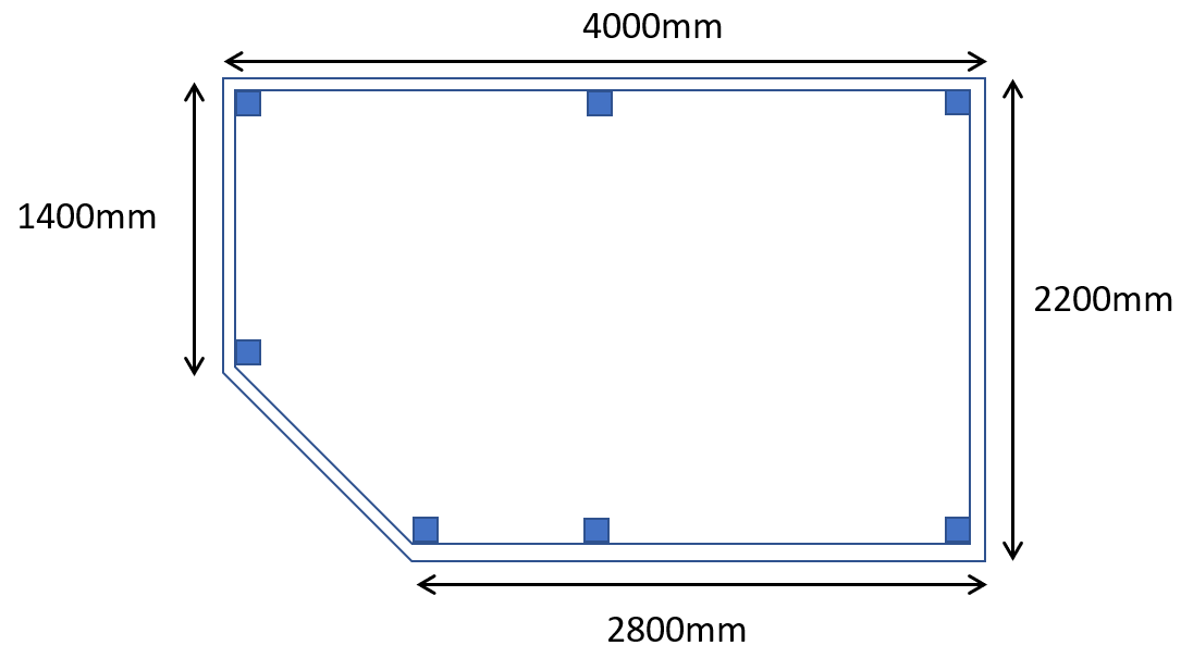

I'm guessing that given the width I'll need 3 4x4 posts along the front and back. However, due to the current paths (I'm not planning on changing the layout) I will be taking a notch off one corner.
This is what the roof 'could' look like but I may be giving myself more work than necessary.
NOTE: these drawings are not to scale.

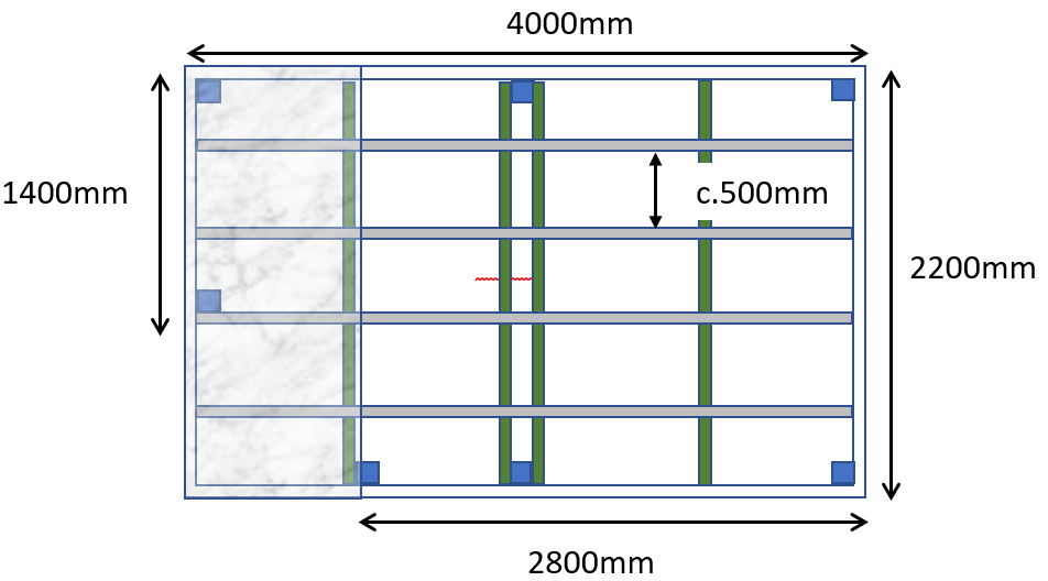

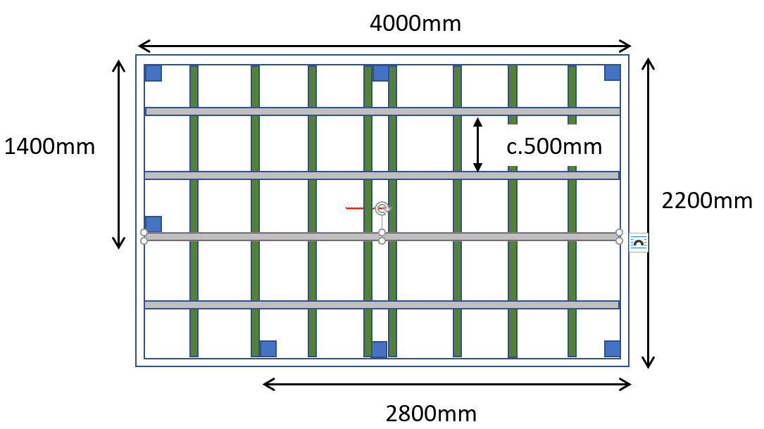

So I see the roof as being more like this:-
As I need to be able to fix the roof sheets every 500mm I will need 4 cross beams. To act as the main roof support I think I'll need jist/rafters at c.600mm spacing.
The questions I am hoping people more knowledgeable than me can answer are:-
1) Do I need the middle posts or could i do a single span across?
2) Do I need as many main beans (in green) as I have shown or could I use less?.
3) What size of timber will I need for the frame and beams? I had thought of 6x2 for the outer frame with 4x2 running 'vertically' (green lines) on my drawing with 2x2 running horizontally (green lines) at right angles on top of the 4x2.
I do have the option to make it a 4000mm x 2200mm and therefore remove the need for the 'notch'.
Am I over-engineering the roof or am I risking making it very heavy and it collapsing under its own weight?

It sounds like you're over engineering it.
Lets pretend it's a first floor in a house, so you might want to put a bed on the roof, maybe a wardrobe.
http://nhbccampaigns.co.uk/landingpages/techzone/previous_versions/2010/Part6/section4/appendix.htm
If you did joists going across the short span, 2.2m you'd be looking at something like 6x2s with 600mm centers or 4x2 with 400mm centers. In practice you're not going to be walking on the roof so you can probably drop that down to 4x2 at 600 and still be overbuilt.

My concern was that it was over-engineered and I think you agree. ;)
As the roof only needs to support itself and the Corrapol polycarbonate sheets I think I can cut down the number of joists/rafters to have approximately 1000mm centres but I'll still need the same number of pulins as the sheets need to be fixed at 500mm intervals.
I think need to keep the double joist/rafter in the middle as I can't find any 2x2 longer than 3000mm .

Do you need 2x2? Looking a the sales brochure it looks more like you just need battens than structural Purlins.
If you want longer lengths of wood then your friendly local timber merchant may have some. Also, rather than double up the beam you could just butt the two purlins against each other on the central rafter.
Slating battens (25 x 50) will do for the 'purlins' as will 50 x 100 for the rafters, 50 x 75 would probably be OK, that sheeting looks fairly stiff (should be at £12/sq m, you could put cement slates on for £13/sq m). Don't rely on the DIY sheds for timber- look at builders merchants and/or timber merchants. 4800 is the standard length for most construction timber.

DiscoGaza, just found this thread and it saved me a headache!! I had 8 joists/beams then got wobbly thinking it may be too heavy and over engineered so based on info here i now only have 4 joists. How was the roof sheets to handle? any tips? Have you finished your project and was it a success! Just wanted to say this thread helped me out
