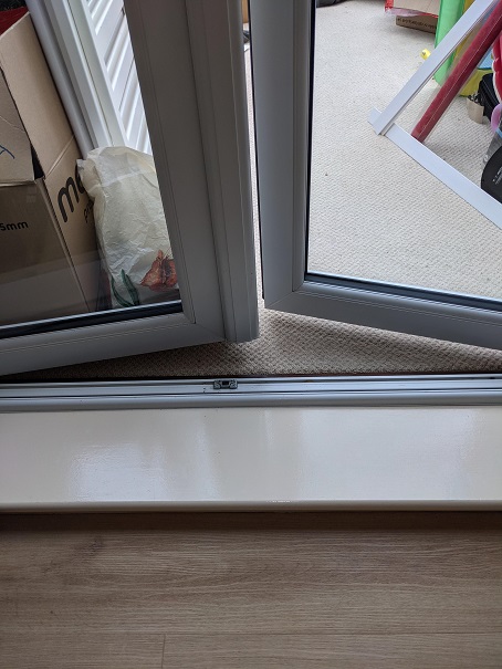

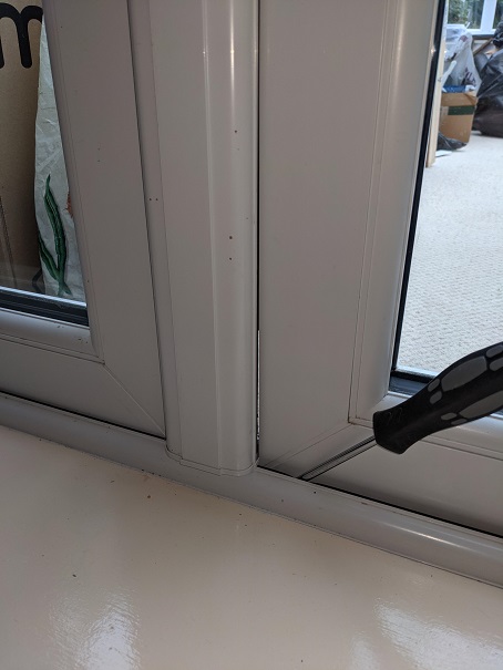

Apologies in advance as I know this is a common issue. I did search previous posts and it gave me some things to try but i'm a bit stuck.

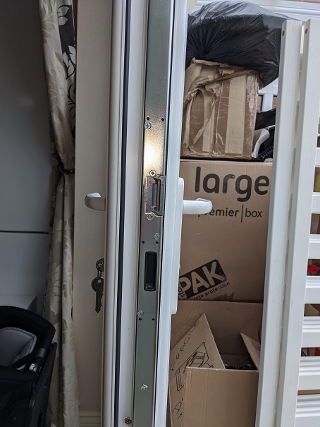

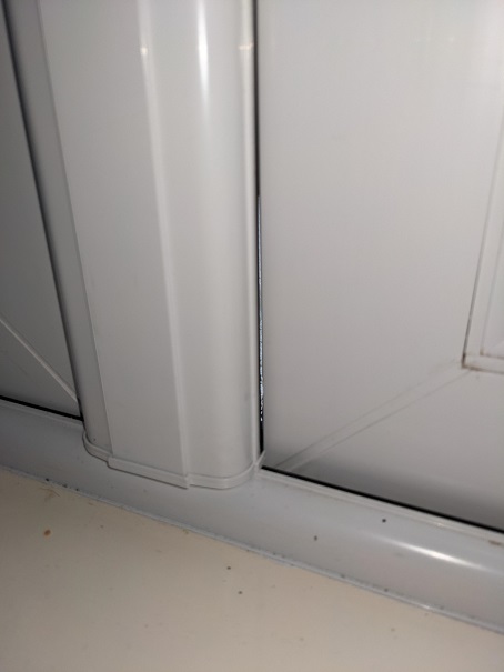

My kitchen has double pvc doors leading to the conservatory. The right hand door has a gap at the inside bottom, big enough to see through. There is no centre post, what appears to be the centre post is attached to the left hand door and swings out.
The middle of the door is very tight, and the top of the door is not as tight, but neither does it have a gap big enough to see throuh. The issue is the bottom inside corner.

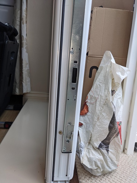

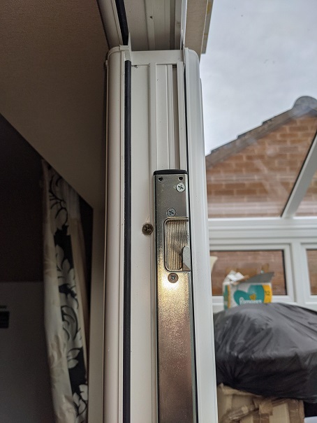

I've tried adjusting the keep and i've pushed it in as far as i can. Any more and the door won't latch. The keeps at the top and bottom do not really adjust much. I've also tried adjusting the keep under the fake centre post, I've had no luck.
If anyone can suggest anything I can try, that'd be great.

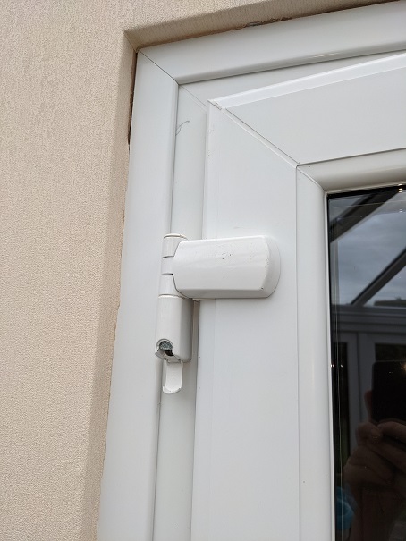

It could actually be the ' slave door ' that needs adjusting , rather than the ' master ' . if that doesn't work then look up ' toe and heeling ' a upvc door . If you think you can do it , give it a try , if not I'm sure there must be a local ' guy/comapny ' that does repair work
