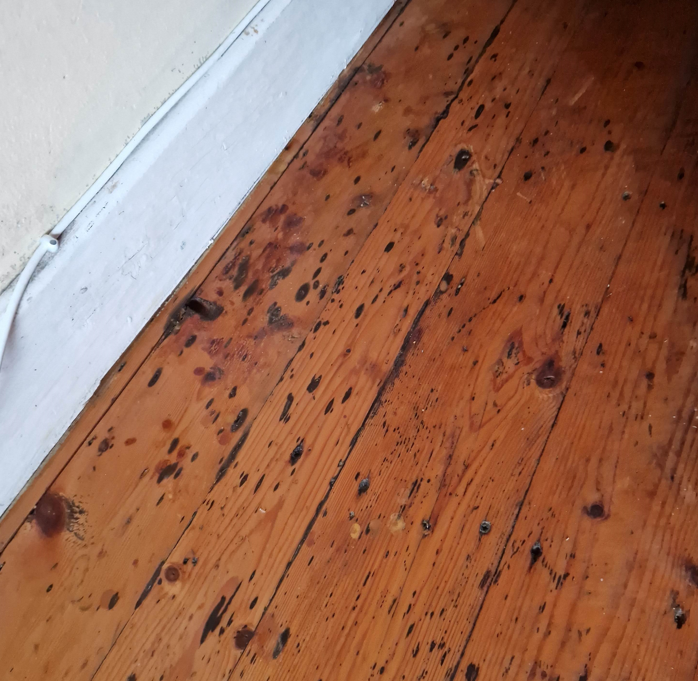

Anything to worry about with these floorboards? I'm not aware of water damage but a coal bucket may have been stored in this general area over the years.

some of those marks are where rust and tannin has converted to ink in the pine. Oxalic acid will clear those. any tars spilt or rubbed in would stay put.
