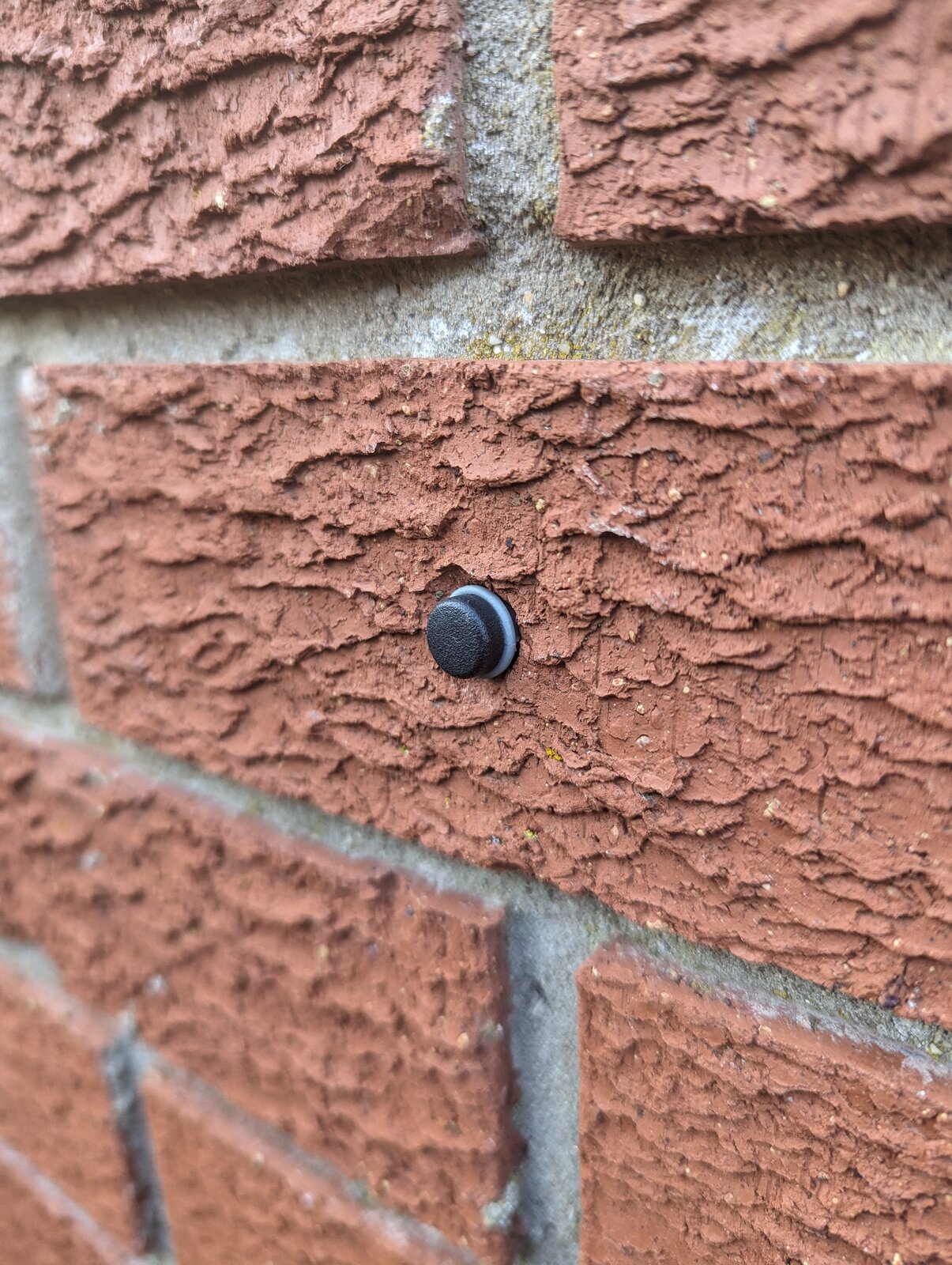

T tsutton Joined 20 Dec 2007 Messages 63 Reaction score 3 Country 13 May 2024 #1 Does anyone know what this is? Only one of my whole house (built around 2006) Thanks. Attachments PXL_20240513_172430080.jpg 439 KB · Views: 139
R RandomGrinch Joined 15 Jun 2021 Messages 7,419 Reaction score 3,037 Location Wales Country 13 May 2024 #2 Do you have a satellite dish mounted nearby?
T tsutton Joined 20 Dec 2007 Messages 63 Reaction score 3 Country 13 May 2024 #3 Yes, I've taken it down. So you're saying the dot just gives you the location of the satellite dish (Sky) or letting you know it's up there in case you're carrying a ladder?
R RandomGrinch Joined 15 Jun 2021 Messages 7,419 Reaction score 3,037 Location Wales Country 13 May 2024 #4 Health and safety. It's a hole and plug for a temporary eye bolt to tether the Sky installers ladder. I.e. here's a working at height ladder safety kit... Last edited: 13 May 2024
T tsutton Joined 20 Dec 2007 Messages 63 Reaction score 3 Country 13 May 2024 #5 Ohhh now that make sense! Thank you.
