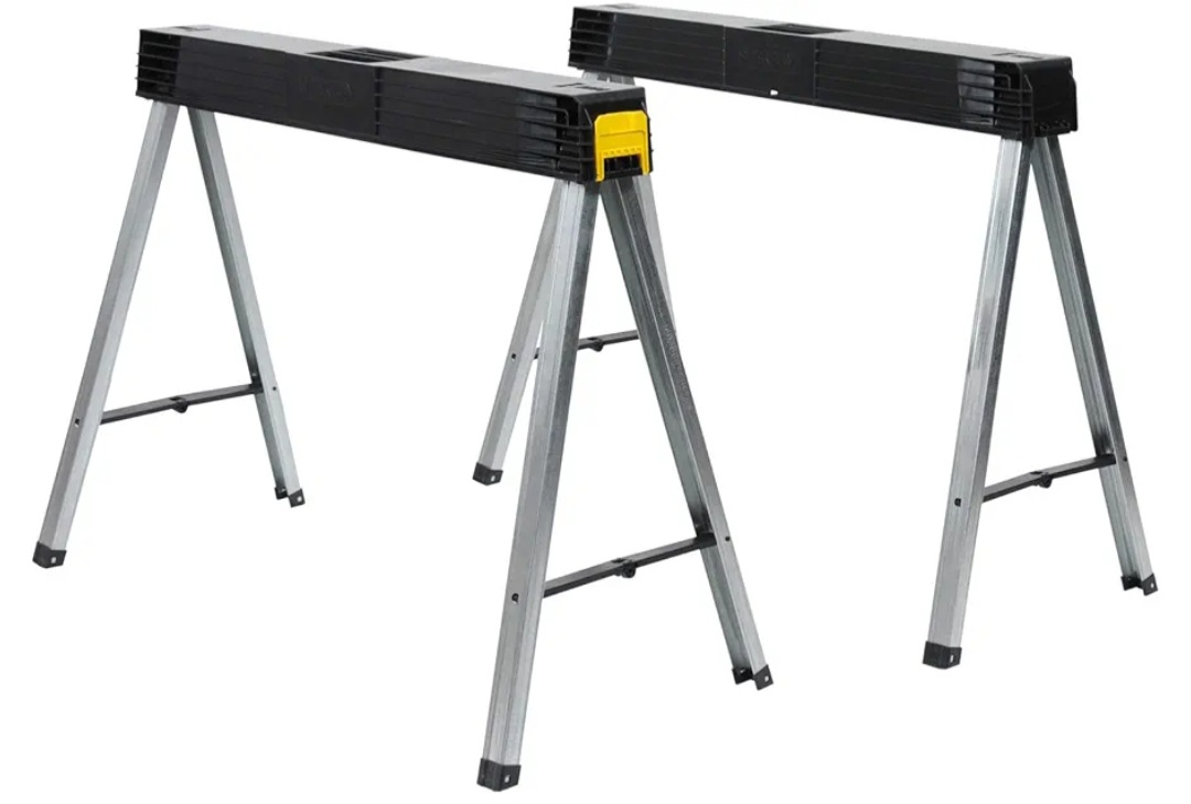

I use these at £72 a pair they're not cheap, I have wrecked 3 pairs previously, when I found them again on Amazon £40 for 2 pairs I snapped them up and am determined not to wreck them.
