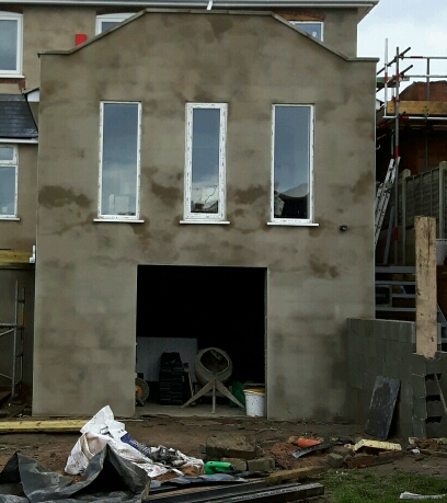

Our kitchen extenstion has a room underneath it as the garden is about 9-10ft below back door height and we built up from ground level.
The floor is block and beam, am I correct in thinking I can use 50mm celotex etc inbetween the beams and attached to the blocks by low expand foam stuff then use full sheets across this with either plasterboard attached or attach plasterboard later
Ta Ray
Photo below, the 3window bit is kitchen and the bit below has french doors in the big gap

He intends on doing a continuous layer of insulation beneath the beams. Or do you mean at the ends? Presumably there is cavity insulation to prevent that?
Put in a false ceiling, and insulate between the joists; then you've got something to plasterboard on to.
The builder did it like this, I would like to completly cover it with insulation, that would also become the ceiling of the garden room
