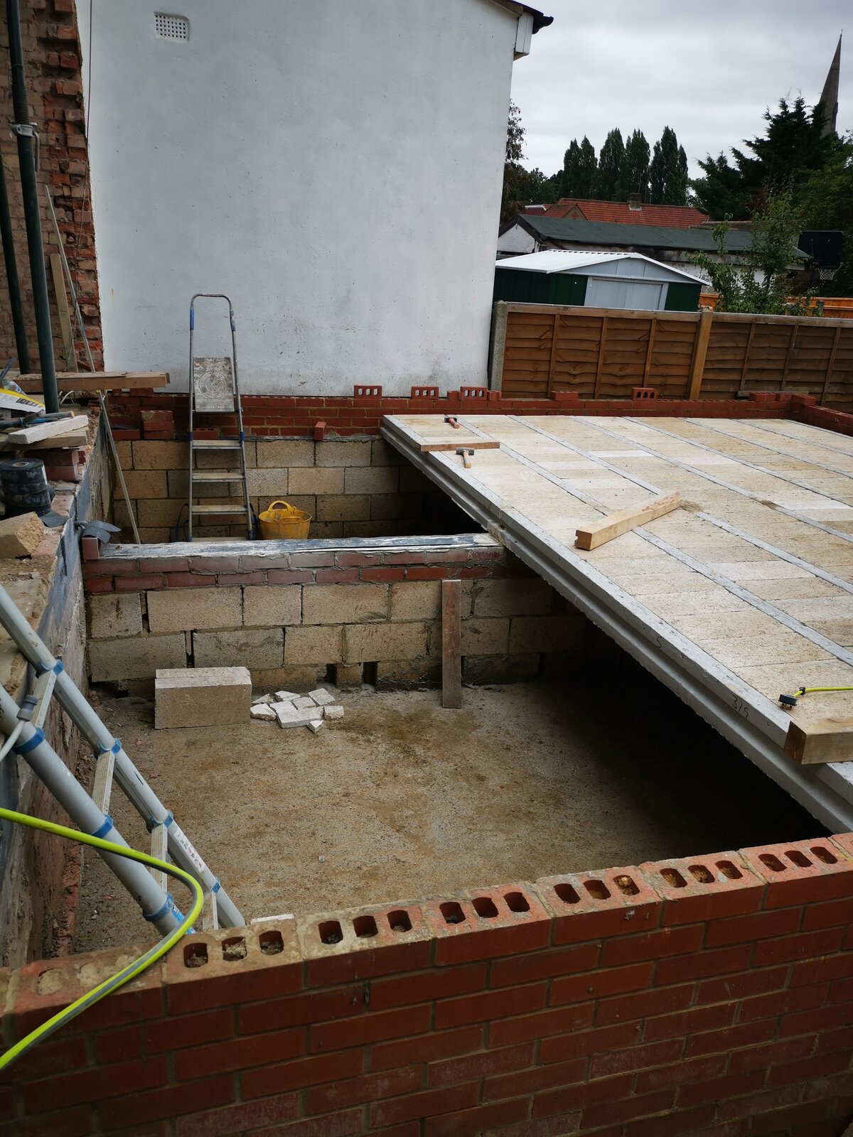

Thoughts on this please
Span of approx 5.3 but beams cut and abutted end to end to end on a sleeper wall. Roughly 2.7 and 2.9 length
Would you do the same or stagger the beams?
Any comments on critique welcome

The floor beams needs to be installed in accordance with the manufacturer's guidelines. So check what the manufacturer states on the permissible bearing, some have differing requirements.
Will ask but not sure they got a plan for this apart from ordering from selco!
How will you stagger them if the main requirement is to land on the central wall?

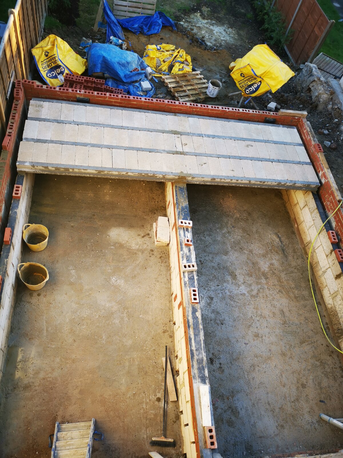

Please see attached pic
Builders are not planning to use end blocks on the ends around the whole perimeter. Say insulation around the cavity is enough of a seal. Is it not necessary?

Again, the manufacturer's guidance should be followed, not the builders do what they like.

Fundamentally, the issue is that your builders are not building properly - either by ignorance or incompetence, but regardless it's not right and you are surely not paying someone to do work that is not right nor do you want work that not built correctly.
The inner block wall leaf is built on the floor, and the wall should not be built on unsupported floor blocks
To be fair I asked the architect BC and he said air gap is also an accepted method but clearly some choose to have it.
Of course the beams are supported on block work but there is a void due to the 50mm recess profile of the beam
Nah that's fubar, they're fobbing you off though I don't know why unless you're paying them to oversea the work? As woodhead mentioned each unsupported block is acting like a mini lintel, you really think that's OK? Would you allow your builder to support the head of 350 wide window with a block on its side?
