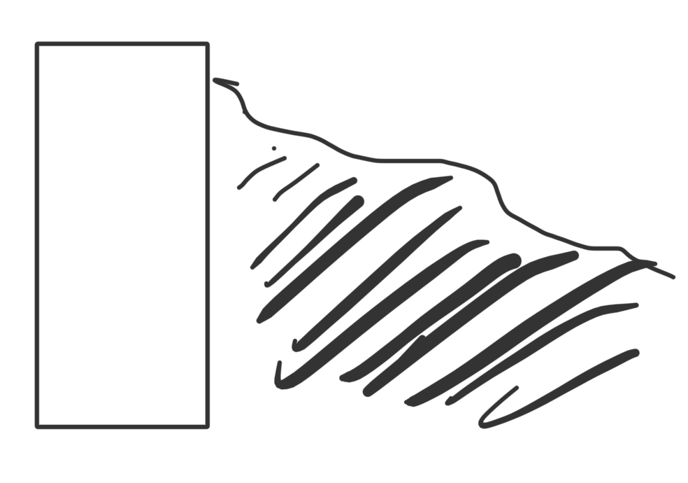

And the profile of the soil is it level with the top of the wall, sloping down as it goes away from the wall or sloping up as it goes away from the wall?
It's about 2 courses shy of the top of the wall. Everything runs down hill so wall will probably need supported unless block on flat can contain it safely. Thanks
The soil runs down hill away from the wall?

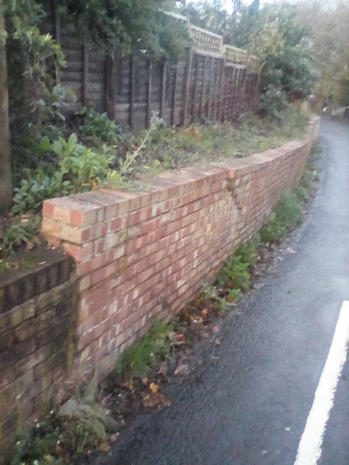

A 9 inch retaining wall can fail in certain ground conditions. Here's one I priced up about that height in heavy clay and the the ground running up from it.
The traffic control made it really expensive.
Best to overdo expansion joints, especially as you know it's going to be saturated wet in winter, shrinking to bone dry in summer - this is far more demanding than a house wall.
Put two in, at whatever block units gives you something near to thirds. Slightly more work than one, but the penalty for using one could be a massive crack through the thing.
