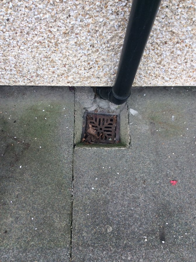

Hi,
I've just won 2 packs of red block on eBay for £20, I've spent all day moving them.
Now here is the questions I should of asked before.
When I pull the current flags up, how far down to I dig for the base?
How do I go around a drain? (See pic)
Thanks.
They normally lay a single row of blocks along the side of the house and simply square them out around the gully.
