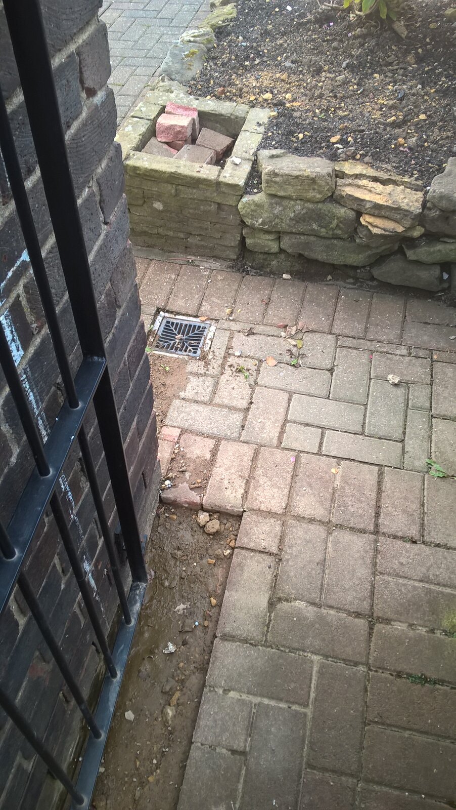

We inherited a fully block paved/flagged back/front garden.1960'S house.
Where it runs up the side of the house where the garage and utility room are, it sits a brick and a half below the DPC, but the issue is that the garage floor is below the level of the DPC so, as the water tends to pool slightly against the brickwork we end up with damp bits of floor stretching about 6 inches across the floor in the garage.
The block pavers are at right angles to the house on the last "course", so we've taken them out and removed some of the sub material, so at least now it's below garage floor level.Now we just need to remedy the drainage issue and then replace the pavers so they're not sitting against the wall.
Question is what's the best thing to do?
There's a surface water drain just where the side path emerges at the front corner of the garage (unfortunately the block paved path is sloped all wrong so water never makes it into this drain, unless we sweep it in) which I'm guessing could be used if we put some sort of drain in, or maybe an alternative would be just to dig down to 6" below garage floor level and fill with gravel? Not exactly sure how you go about putting a drain into the side of the surface water drain as we've neevr done it before.
The utiltity room FFL is a good 6 " above the garage floor level so just to say below the DPC,so we only get very minor damp bits at the moment, but we're in the process of insulating etc, so we've put DPM around the perimeter of the external walls, up the walls and across the floor about 2 ft.

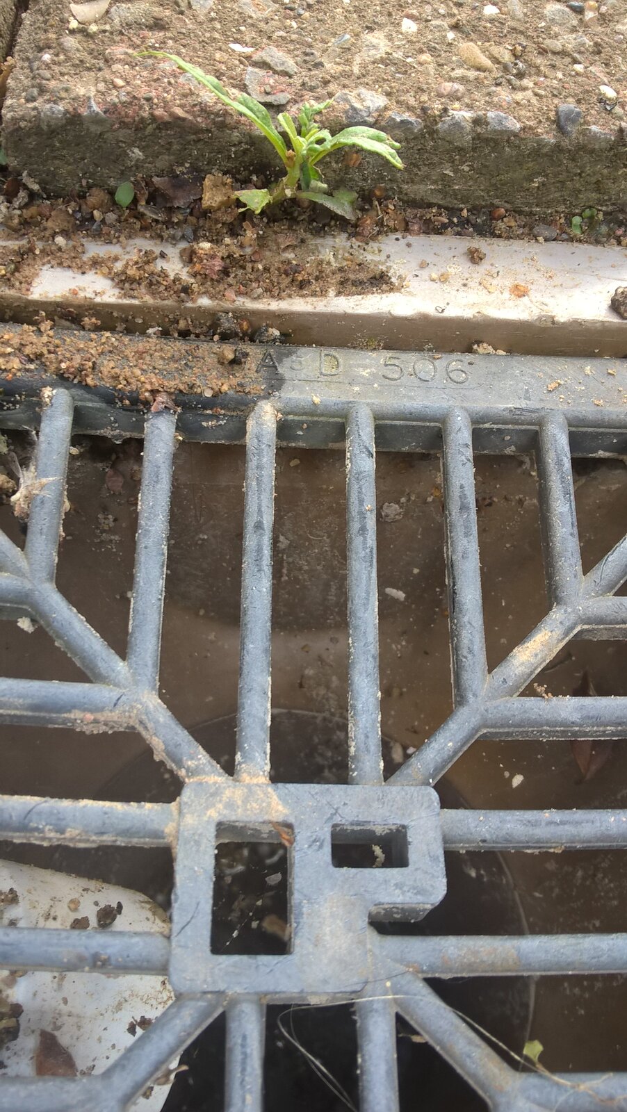

Agreed. Looking at the surface drain there's round bits on the side that look like they could be cut out with a hole saw. Presume you can get some sort of connector/adaptor that would go in the hole?
Thanks for the advice.
Yep, they should be, post a pic

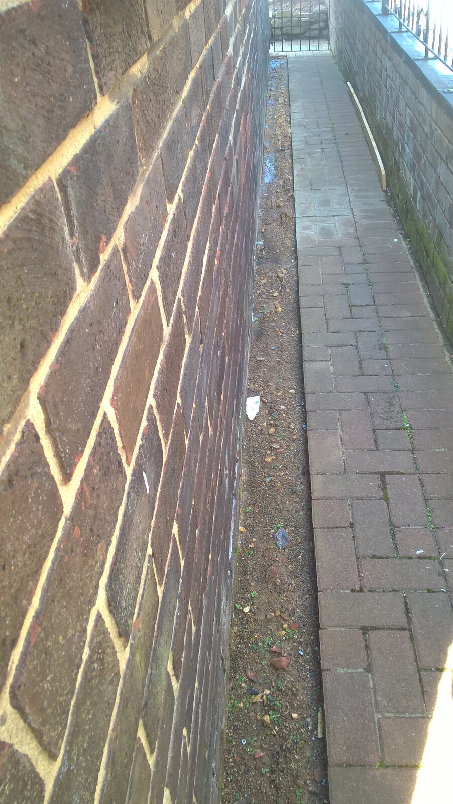

Issue we might have is that the gap is 200 mm. Pavers are 100 mm as they were jammed right up against the house wall-took some brute force to get them out. There's a piddly little concreted channel against the retaining wall on the other side which maybe was meant to act as a drainage channel, but slope is all wrong so probably just the way it turned out!
Will we manage to get the 100 mm drain in and replace a row of pavers?
Yes dig out more than you need, so you get a fall- there are diy videos on YouTube showing the process.
You could replace the pavers, or cut them a bit smaller if they do't fit.
Or fill the gap with concrete. A much harder to achieve finish is to cut a line in the existing pavers to make room for a new row of edging.

Looking at other properties, I think it was previously concrete. No traces of any concrete underneath now. The height of the paving is OK ish at about a brick and a half below the DPC, it's just that the garage floor is below the DPC level.
Haven't got the heart to remove them all and relay! TBH, its on the north facing side of the house, and there's a nasty brick retaining wall on the other side of the path, so it's all a bit nasty really! The retaining wall is very wet and covered in moss as there's no drainage in it.
