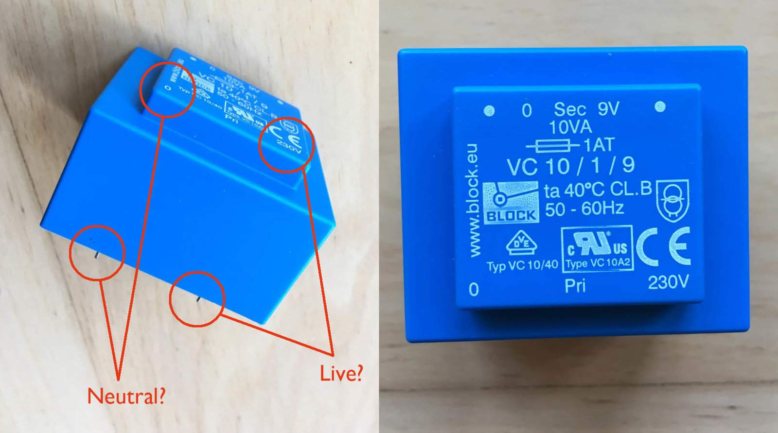

This may not be exactly household related, but I thought there might be an electrician here who knows the answer? Hope that's ok, I couldn't find another suitable folder.
I need to know which pins on this transformer are live or neutral. Looking at the information on the back, I'd presume the live pin on the primary corresponds with the '230V' marking directly opposite and the neutral is the pin opposite the '0'?
Any help greatly appreciated!

Input doesn't really matter which way around but use the side marked '0' as the neutral. The output won't be referenced to earth so there's no neutral as such.
Thanks so much for the reply @fluorescence So are you saying that theoretically speaking, I could essientially wire it either way (as long as the secondary side adheres to the same polarity)? I've seen a video where someone seems to do just that, which was what was confusing me.
The secondary side doesn't need to be the same way around as the input. What you have is an isolated transformer meaning there is no physical electrical connection between the primary (240v) & secondary (9v) sides so there will be no reference to earth on the secondary side, hence no neutral.

@fluorescence Thanks a lot for your help and that video! It's really informative, he's a very engaging teacher! I'll definitely be checking out his other videos and subscribing.
