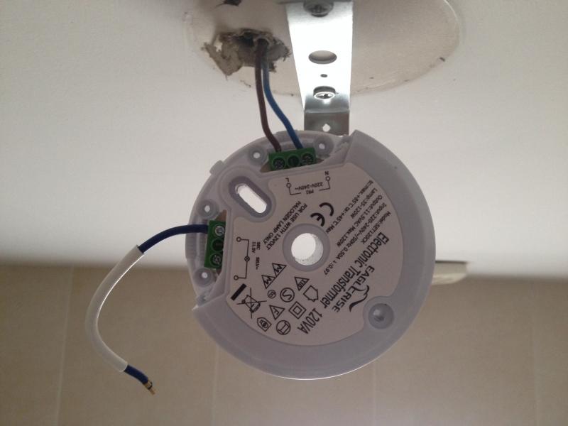

Please see the image. I have connected the Live and Neutral supply wires into the corresponding Live and Neutral terminal blocks of the transformer. The transformer came with a wire attached to the output part of the transformer as shown in the picture. The light fitting that came with the transformer has one brown wire which I presume goes into the other output terminal? What the bloody hell do I do with this short wire? Do I need to connect that into the terminal with the brown wire from the light or is just a spare output in case I wanted to connect to something else?
Any help much appreciated.

There should be two wires from your light fitting. Connect the two wires to the transformer. Any way round, any colour, it just doesnt matter.
Could we have a picture of the light fitting as well please?
The OP has indicated that the light fitting is provided with only one wire (brown) and given that there must be a return path somewhere I would suggest that there must be a terminal somewhere on the fitting to accommodate that short blue wire from the transformer. (Is it possible that the manufacturer has decided to use the metalwork of the fitting for the return connection?!? I suppose that is considered acceptable practice for SELV?)

Yes, of course, my speculation was that the brown flying lead attached to the light might attach to the presently vacant transformer terminal providing a supply and that the blue flying lead from the transformer might attach to a fixed terminal on the body of the light to provide a return.
I agree that it seems to be a far from ideal design and without seeing the rest of the fitting it's pure speculation but it would be a possible explanation for having one flying lead attached to the light and one to the transformer.

Sure, but is it possible that there is an 'undiscovered' (or, at least, not so far mentioned) terminal on the light fitting (connected to the lamp, not the body of the fitting)? People are calling them 'flying leads', but the one we can see (at 'transformer') appears to have a screwed connection to one of two terminals. If it were the same at the light end (i.e. two screw terminals), it could just be that, for whatever reason, for the purpose of shipping they disconnected one wire at the 'transformer' end and the other wire at the light end?

It is NOT a transformer, it is a switch mode power supply, it is wrongly labelled. That said there are 2 output terminals one with a wire already connected. The 2 output terminals go to the 2 connections on the light.

I am with you there John the power supply may be Class II but that does not mean the lamp is Class II. Unless there is a
sign on the fitting then earth is required even if the electronic unit inside the fitting has a
mark on it.
