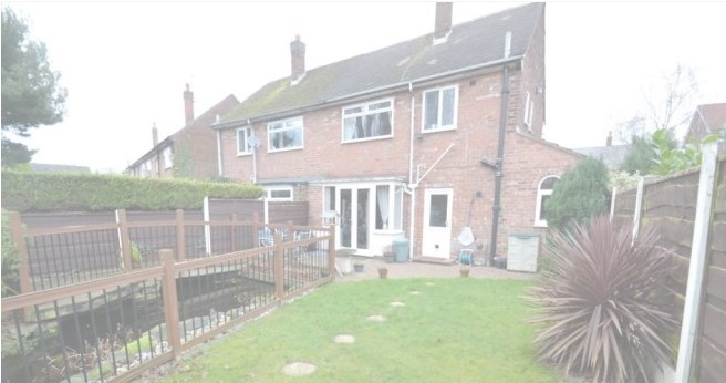

Where is the soil pipe from your WC?
I ask because you say it is a 1960's house and so it may have been built with separate foul and rainwater drains.
Which may put a very, very different complexion on your problem.
It's to the right of the photo - didn't get it into the shot. The toilet isn't backing up though, wouldn't that be the sign that the foul drains are the problem?

Show us please.
I'm back at work, but found the photo on Rightmove from two years ago when we bought it - hence the slightly hazy image!

It looks to me like those plastic pipes on your house have been run to the rainwater gulley after the house was built.
Look at other similar houses nearby to see how their drains run.
Your iron soilpipe is so close to the corner of the house that the drain probably runs down the side of the house to the sewer in the road. Is that a side addition or was it built from new?
Quite possibly yes - the neighbours on both sides are similar though.
The only addition to the original building is the bit that sticks out at the side (on the right) is a kitchen extension - so where the soilpipe is running would originally have been the edge of the house.

There are plenty of houses of that era with combined drainage, it was nearer the 70's when separate systems became commonplace. Chances are the original rainwater goods, and hopper were asbestos cement. I would also hazard a guess there's a manhole on the property somewhere, with the main run passing though and 2 laterals from the gulley and soil stack going into it, which some clown has decided to bury under that paving.
Give the gulley a good plunging, if that doesn't solve the issue, report back.
