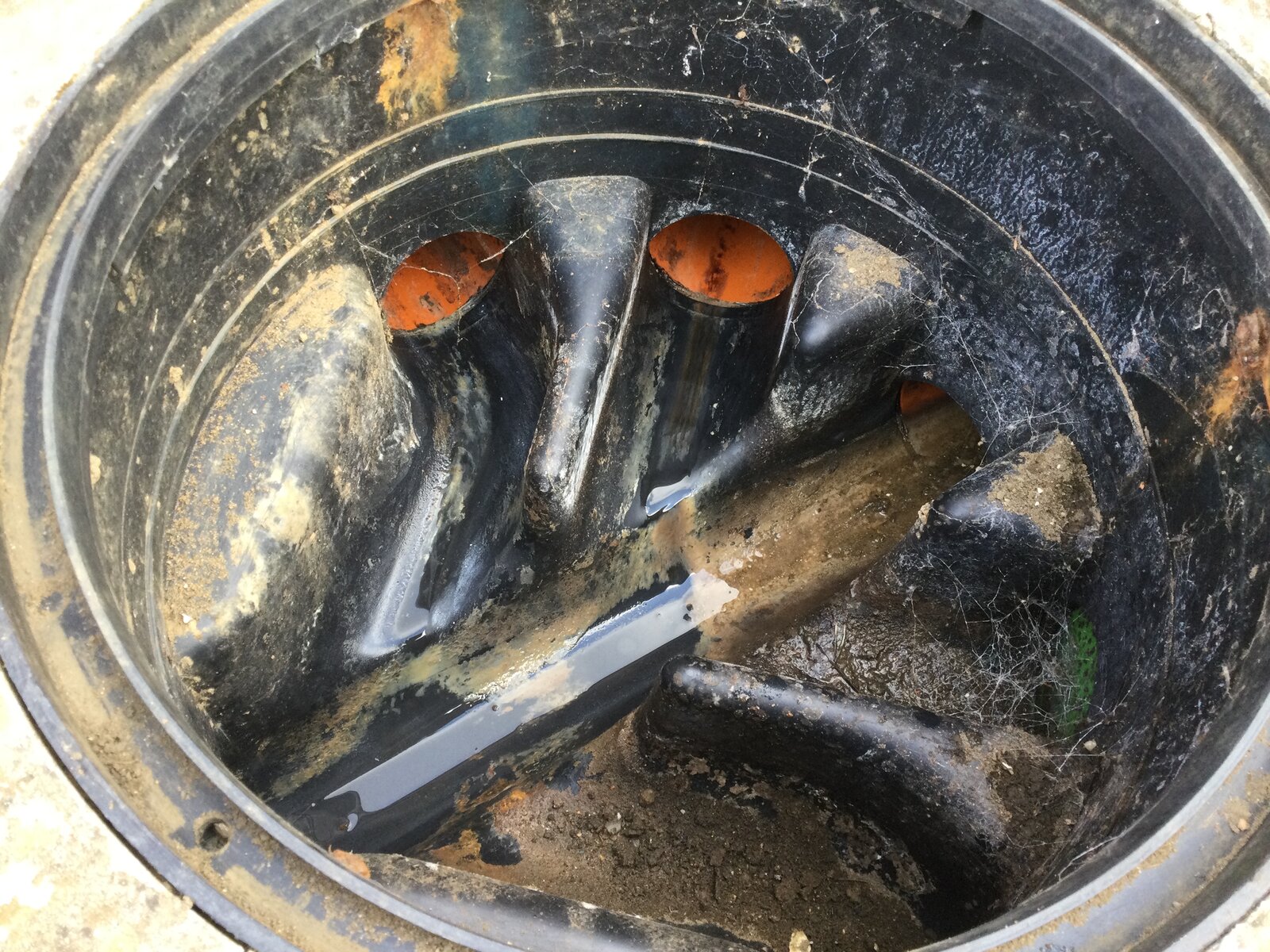

2 kettles of very hot water from great height went in beautifully, no backup. Flushed away perfectly too. 2nd flush backs up. Outfall in inspection hatch is a trickle.
Outfall joins another loo somewhere back up the line. That loo is perfect.

Air Admittance Valves do what they say on the tin, they let air in but wont let positive pressure out. If you're only getting a trickle through at the manhole (Inspection Hatch?), then the pipework is blocked further up. I wouldn't advise a hose from the top, unless you've someone in the bathroom to ensure it doesn't backflow out the shower and flood the place.
Ideally, stick some drain rods up from the manhole, and see if they find anything.

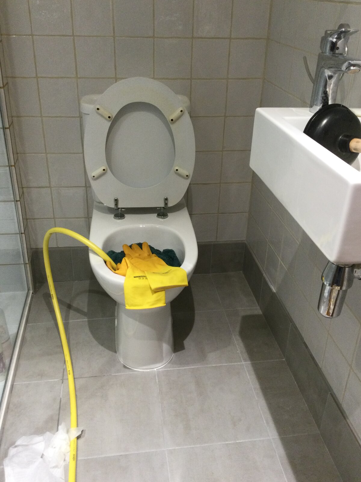

Hosepipe trick downwards hasn’t worked. Will give it one more go. Obviously haven’t got enough pressure.
Have stuck another hosepipe up as far as I can go, probably 6ft which takes me to the bend I would say.

pic 1 drains, 2nd from left is the offending one which is also ano loo. 1st on left is ano loo. Right is kitchen. Others are blanks. Outfall is left obviously. All nice and clean.

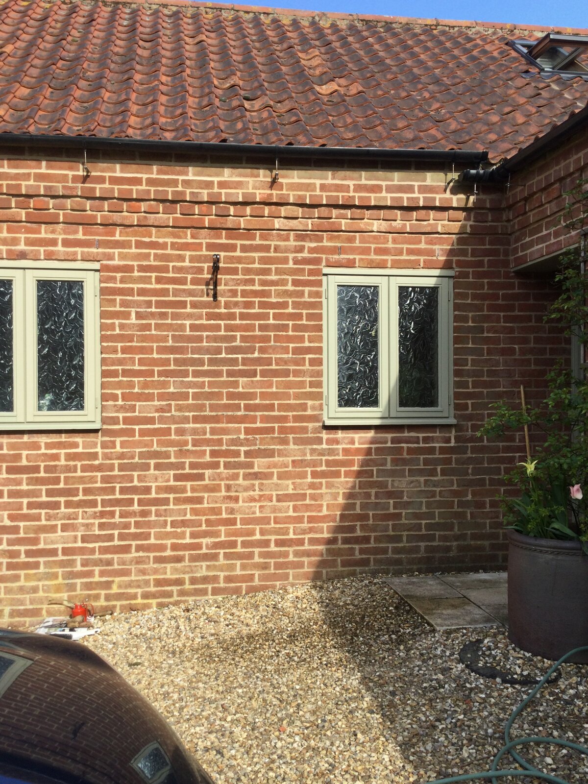

pic 2. Loo is on first floor to left of open window, in eaves.
pic 3. Scene of the crime

No apparent vent through the roof, which indicates likelihood of an AAV on the top of the stack. Have to wonder now how much horizontal run there may be under the eaves, which could be where your issue lies. If no joy with rodding the drains, I'm afraid it may be time to bite the bullet and get someone in.
