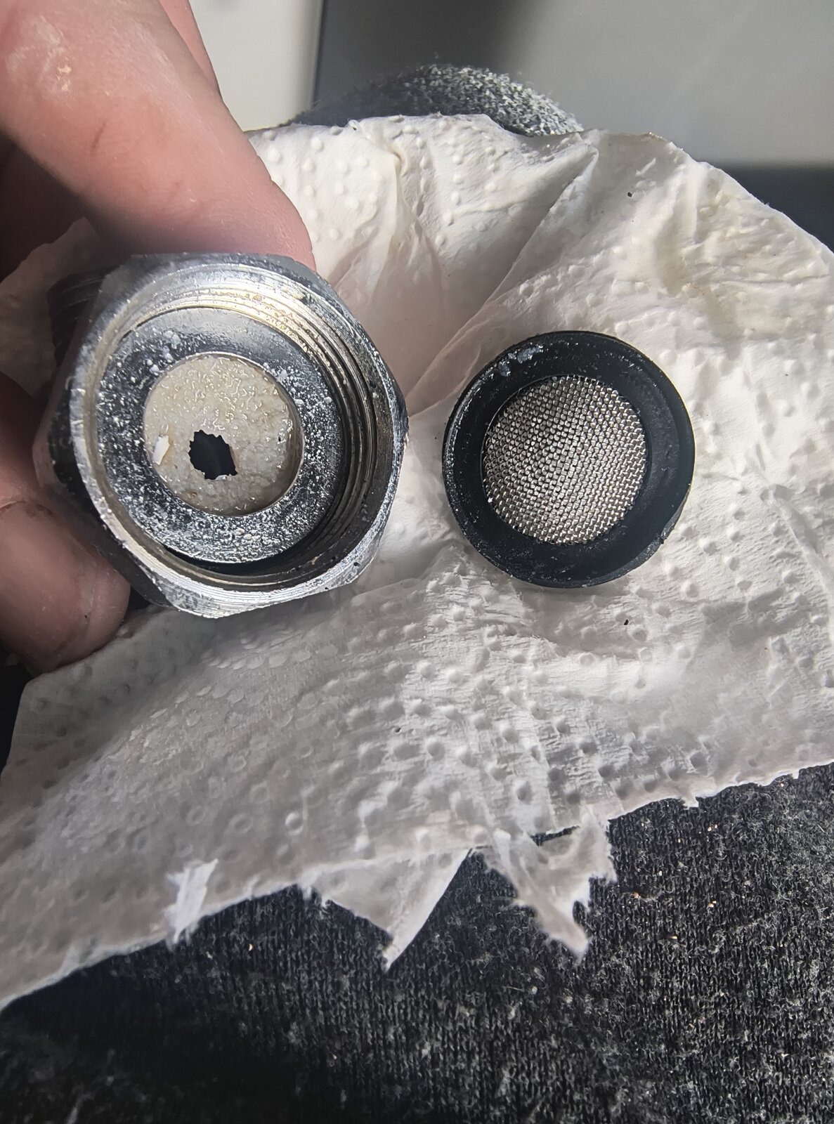

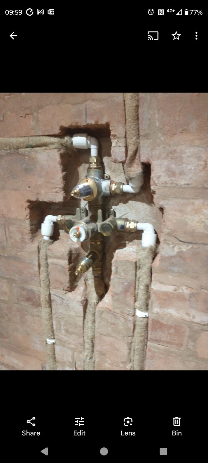

The baffle in my megaflo is disintegrating and the debris has blocked the hot water inlet strainers in my concealed shower valves - one is a Marlow and one a TS1503. Accessing them will involve some serious hole bashing. I know it's probably a silly idea, but has anyone managed to clear them via the supply pipework - sticking a hoover on the end of something? I'm guessing they'll have check valves so removing the cartridges and reverse flushing probably isn't an option either?
Only way to do it properly and be sure they're clear is to get to the filters and flush them clean.

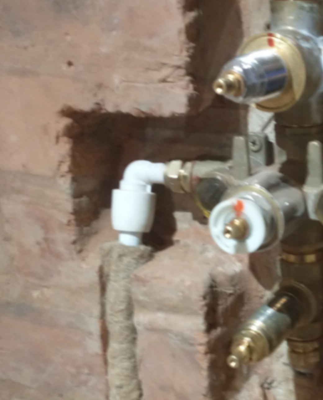

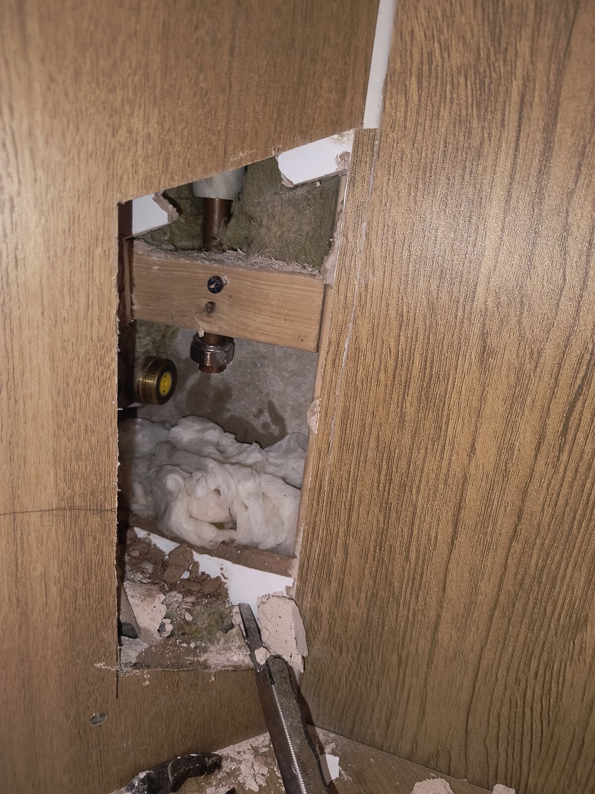

I've done the first one - side of fitted wardrobe and a bit of plasterboard - I thought there'd better be something in there and I wasn't disappointed. I've heard the stuff described as Kendal Mint Cake and it was - quick shake in a glass of water and it was gone.
Second one appears to be sorted now, it's inside a brick wall so access would have been from the back, coring a hole through from the adjacent bedroom!

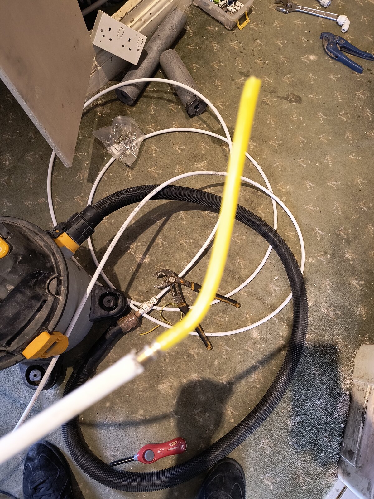

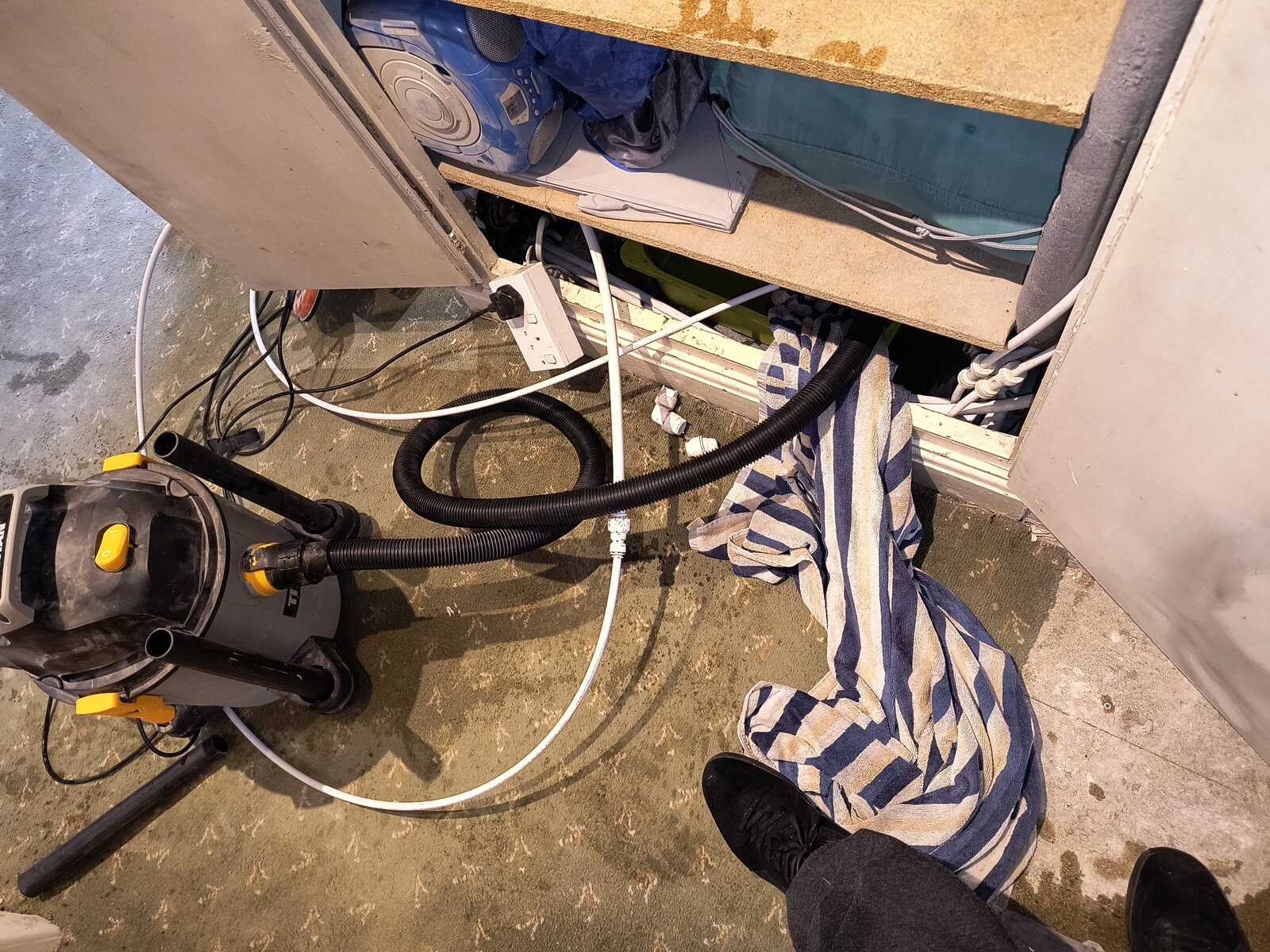

Anyway, as the stuff seems fairly soft and just lightly packed against the back of the gauze, I thought I'd take a chance and rigged up a jetting/hoover arrangement - because it's piped in 15mm plastic I was able to insert 5m of 10mm
plastic pipe inside it all the way to the elbow on the valve, connect this pipe to the hot water and "jet" the back of the strainer - I alternated this pipe back and forward with the water and then sucking with the wet and dry vac and fingers crossed have managed to suck most of it out.

I still wasn't 100% happy with the flow from the inaccessible valve (more the rain head and bath filler than the shower) so I added something to the end of my 10mm jetting pipe (this is why I keep a garage full of junk) that would get round the 90° elbow and poke the stuff loose off the back of the strainer - a bit of poking and I felt it go round - now it's virtually as good as it was before.
