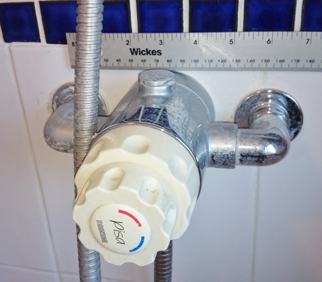

Need a bit of help replacing an old leaking exposed shower valve, specifically finding something to replace it with.
It's a round type of valve (old Bristan Pisa) rather than a bar-shaped valve, see attached pic. The inlet pipe centres appear to be about 155mm.
I bought a new valve before but the pipes in the wall were too big to fit the new valve. Foolishly, I didn't take photos or notes at the time, and now I'm coming back to it a few months later, I can't remember what size the pipes were either in the wall or on the valve that I bought.
I'm going to assume that the valve I bought had 15mm inlets, as that seems to be that standard - it was just a cheap one from Screwfix.
1. As long as I get my inlet pipe sizes and centres right, can I replace a round exposed valve with a bar-shaped one? I guess the round valve is probably screwed in through the tiles so I'll have to fill the holes in the tiles? Any other issues that I'll need to address?
I'm not too familiar with plumbing so I've been reading up about different pipe sizes online. I'm guessing that the pipes in the wall are either 3/4" (19mm?) or 22mm.
2. From what I've read online, 22mm seems like the more common size than 3/4". Does that sound right?
3. Does anyone know about the Bristan Pisa exposed valve, specifically what size inlets it uses, and what pipe centres? I can't find anything about it online at all.
4. So, I'm thinking I should buy a shower valve that uses 22mm inlets. If it turns out that the pipe is only 3/4", can I just pop a 22mm olive on and it'll work ok? Or is the size difference too much, and it won't seal?
5. Pipe centres: My research shows that most (all?) valves are based on 150mm centres. I've measured repeatedly and I'm pretty sure the existing one is at 155mm centres. The wall is masonry, and I don't want to remove any tiles. Is it likely that I'll have sufficient "wiggle room" to fit a valve with 150mm centres?

do you have access to the pipes on the other side of the wall ? pics would be good. anyway a few things...the hot and cold have to enter the new valve on the correct side, so establish what you have .as you look at it say hot to left cold to right. most horizontal bars need this ,at 150 mm centres and 15mm supply pipes. when removing existing valve there are screws thru tiles, fill holes with silicone. screwfix do bar valves for about 70quid ,I would also buy an easy plumb kit as the fittings that come with most bar valves are a joke.
Yes, confirmed existing is hot on left, cold on right.
Ok, great, so sounds like ok in theory to swap from round valve to bar.

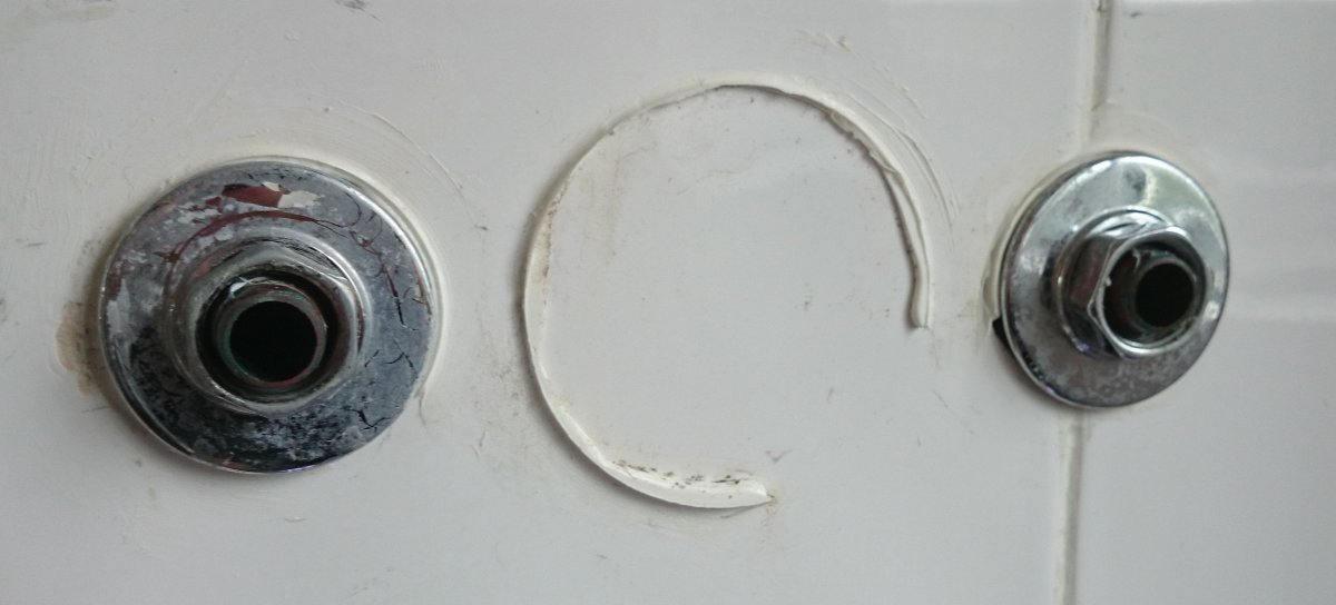

Resurrecting this thread as I've re-removed the shower valve and remembered what the problem was.
As you can see from the attached photo, after removing the valve, I'm left with pipes with nuts. The nuts are held captive by an olive. The pipes are 15mm, but the nuts are the wrong size / thread for the new valve that I bought.
So, my problem / question is - how do I remove the existing nuts and olives from the pipe, in order to be able to fit new ones? There is no movement on the pipes, and I can't push the nuts back far enough to expose any of the olive.

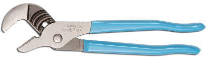

Have you got a pliers like this one ?
IF you have then stand in front of the pipes grip a nut at top and bottom and gently rock the nut up and down and gently pulling on the nut,it will pull off the olive and you will fall backwards.
i assume the chrome behind the nut is free to rotate behind the nut .is it metal or plastic chrome plated ? you will almost certainly have to get that off .can you lever it away ,gently ,from the tiles .maybe two wide bladed scrapers as levers. if its plastic just cut it off. once off ,the nut should go far enough back to expose the olive.

Should be here by the weekend so I'll have another go at the nuts & olives then. The discs are plastic, so I will also cut those off and see how much olive that exposes.

Use an olive puller.
Jon
Success!
OldBuild was right - the existing nuts are identical to those supplied with the new valve. :):)
So no need for olive pullers or cutting.
New valve is now on and working. Just need to "soak test" it for a couple of days to make sure no leaks.
