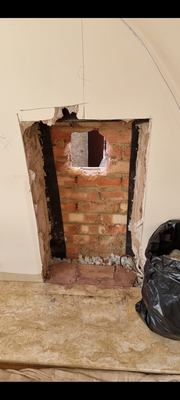

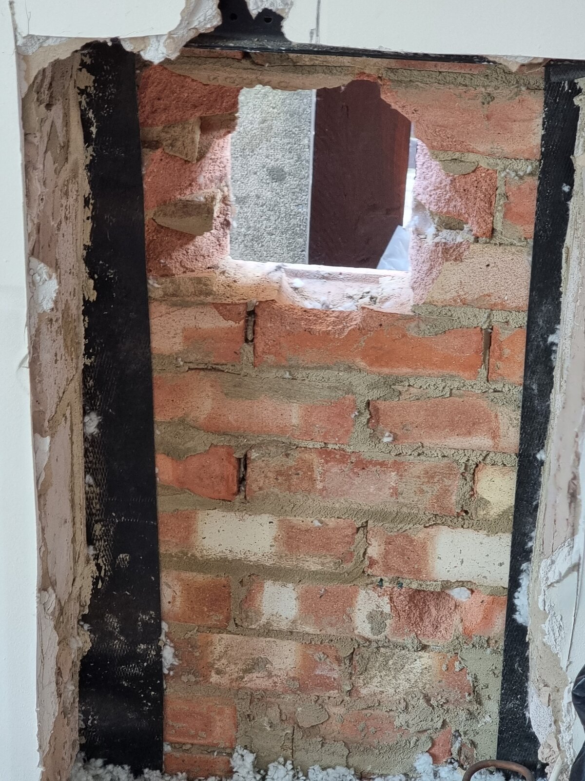

So i need to breezeblock up inside where an old gas fire was in my house, the gas fire basically went all the way back to the single skin wall so a section of breezeblock was cut out to fit the whole fire at the time.
Im now left with an opening that only has a single skin brick to outside, size is about 80cm by 1 metre high, there is a lintel above the opening obviously put it at the time the fire was.
The gasman said they dont do brickwork to that extent as it would need tying in to the exising breezeblock.
With the opening having a lintel above it, would it really need tying in to what is already there? To be truthfully honest what is already there is a mess anyway its hardly straight or even.
Im tempted to do it myself thats all but if its a job for the pros fair enough, he said something about putting damp proof membrane behind it aswell. Ive attatched a picture to the thread.
THERE IS NO CHIMNEY BREAST THIS FIRE WAS VENTED DIRECTLY OUTSIDE INTO OUR SIDE ALLEYWAY
Cheers

Well it is supported if it has a lintel, I would be tempted to just brick up the hole matching the bricks on the outside as well as possible then put a timber frame in and a sheet of plasterboard on the inside with some insulation between. look carefully at the join between the existing brick and blockwork to see if there was any kind of vapour barrier in the original construction. I guess the black is just that so yes replace with something similar.

There is a vapour barrier yes, its that black stuff.
So could i just cover the brick with that vapour barrier and then put loads of foam insulation in and then stud frame and insulated plasterboard?

it would probably benefit from some kind of insulation in the cavity. If it is ventilated to the flue it should not suffer from damp.
or is the hole for an old type of balanced flue, with no chimney above?

There is no chimney sorry forgot to say it vented directly outside into our side alley (via a vent of course)
I would avoid foam , messy stuff. Get something like Rockwool or nicer to work with the recycled plastic bottle stuff which is non itch. Celotex would be easy to use too. Ordinary plasterboard will be fine inside. Some vapour barrier sealed to the existing with a sealant or maybe flashing tape should suffice. I guess at a push a bit of roofing felt would do.
Brill ill go with that option then, trying to keep costs low, so adhesive DPM to the brick, then fill the cavity with rockwool/celotex etc then stud to the breezeblock, attatch plasterboard to the studs then skim coat?
When you refer to celotex do you mean stick that to the brick (on top of the dpm) as it comes in boards, or fix that via studs and then plasterboard on top leaving a gap between celotex board and external brick?
Just cut the sheets to be a push fit in the hole, as you need to buy a full sheet a thinner one cut into several sandwiched sheets will be more economic than getting the really thick stuff with loads left over.(y)
