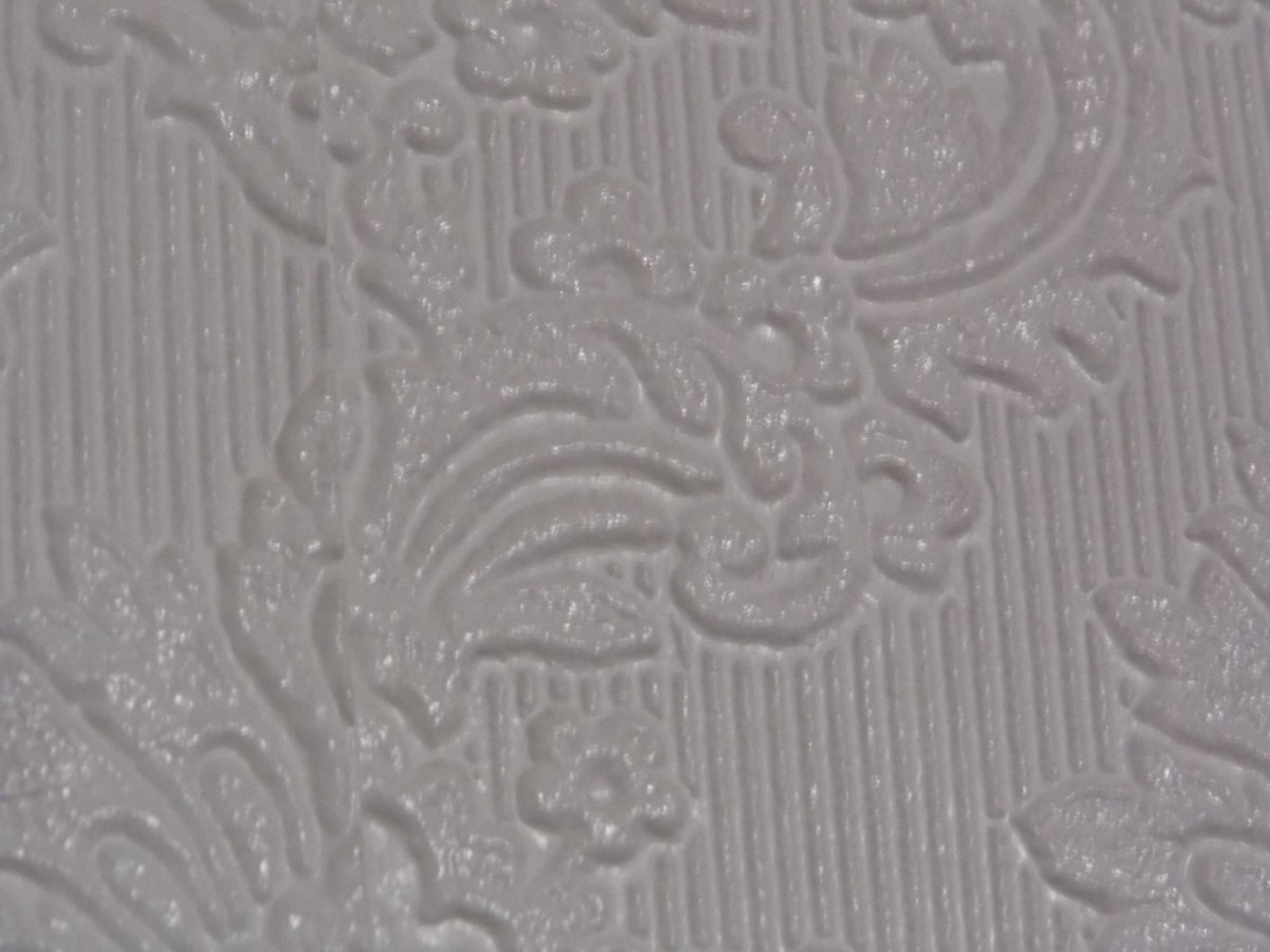

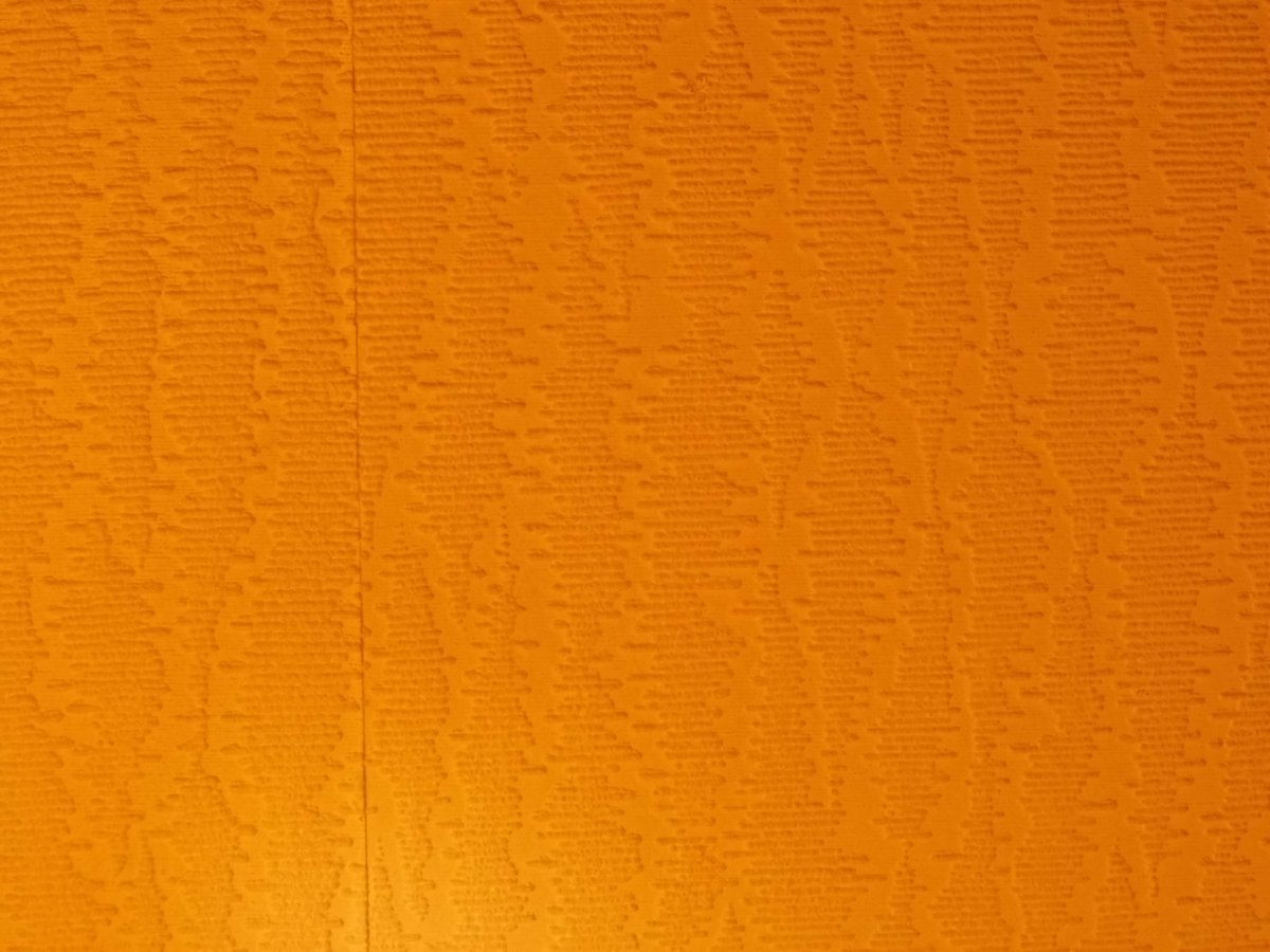

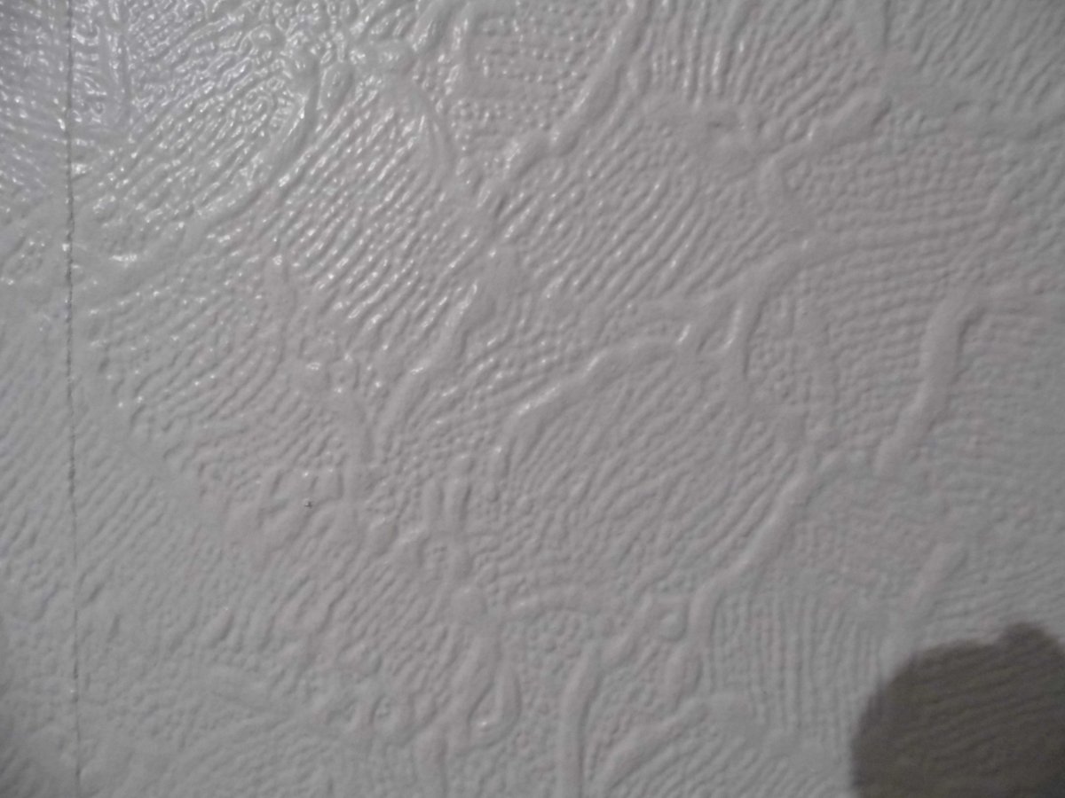

here's some pictures of 2 of the rooms. In the first two the wallpaper has definitely been painted over but the walls are all shiny so I don't know if someone has painted them over with gloss paint instead of emulsion. The final 2 pictures are in the living room and this wallpaper has not been painted over, so am I looking at blown vinyl or amaglypta. The stuff in the living room can be picked off and is spongy so I take it that it is blown vinyl?

Picture 1 is definitely Anaglypta and picture 3 is definitely a blown vinyl. Picture 2 is a little trickier but I think it's a blown vinyl that has had a few coats of paint.
The shiny paint is probably just a vinyl silk emulsion which can be painted over again. The issue you could have is, if you want to change from the silk to a matt, the paint could craze (tiny cracks all over the paint film that looks like crazy paving) as it dries. In most cases on wallpaper when I have changed from silk to matt, it has been fine, but there has been the odd occasion where crazing has occurred. An extra coat usually hides the problem though, so be prepared to use 2-3 coats.
The blown vinyl is a bit of a funky colour for it not to have been painted already - most are either just plain white or have coloured patterns. I personally haven't come across that particular paper, but others here may have. Are you certain it hasn't been painted that colour with a matt emulsion?
thanks Misterhelpful. Picture 1 and picture 2 are both in the same room but on different walls and both used to be pink!! the third one is in the living room and it's maybe just the lighting that makes it look a nicotine yellow :( It's kind or more of a cream colour during the day and thanks for the info

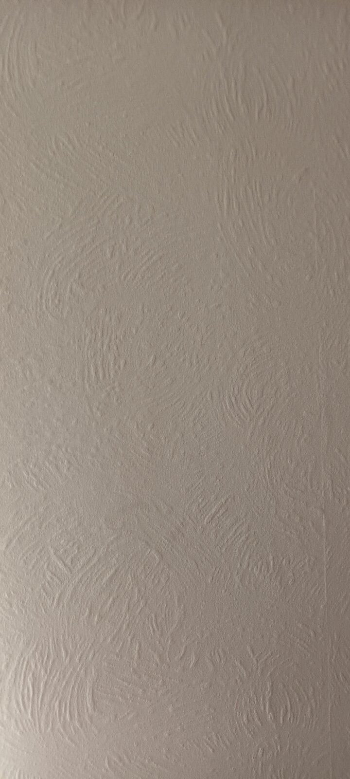

Hello I've moved to a new flat in Huddersfield and trying to trace what style this blown anaglypta wallpaper is it's for the lounge on a wall by the looks that's either been damaged by the previous tenant or some electronics work has been done installing the cable T.V. Antenna I would rather try and get a couple of 16ft length to render it rather than re paper the whole 3 rolls in a different style of wallpaper as I don't have no experience in wallpapering I've only painted in my previous 3 flats I lived in here's a photo of the paper style lines on the wallpaper I were thinking at 1st it was superglypta Richard or Belgravia pattern style.

Sourcing old papers is extremely difficult. I wish you luck.
You mean to say it would just be simpler to re paper the entire room depending on if the anaglypta style paper I need is no longer printed or obsolete.
Perhaps, but if you are going to the trouble of doing that, why not just use lining paper?
