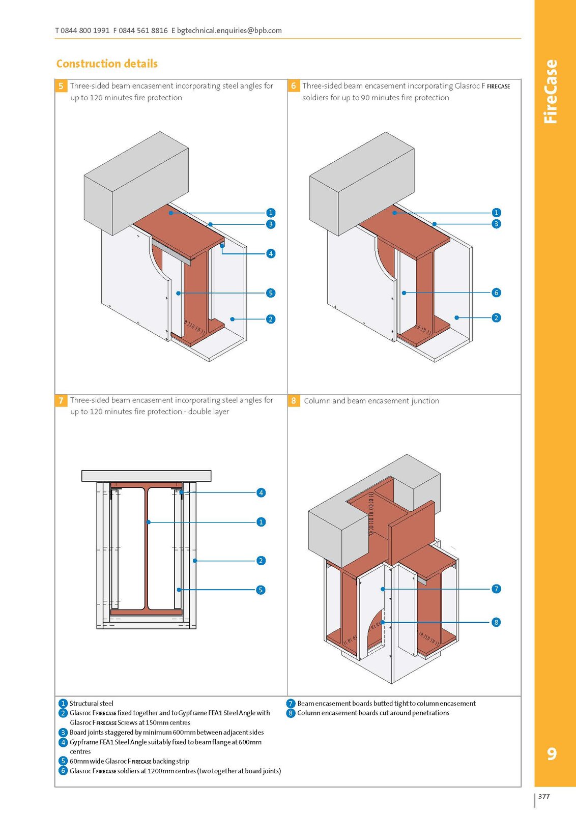

Ideally you would avoid using any timber in steel encasement, using lightweight metal angles (Gypframe FEA1 Steel Angle) fixed to the beam into which you screw the boards.

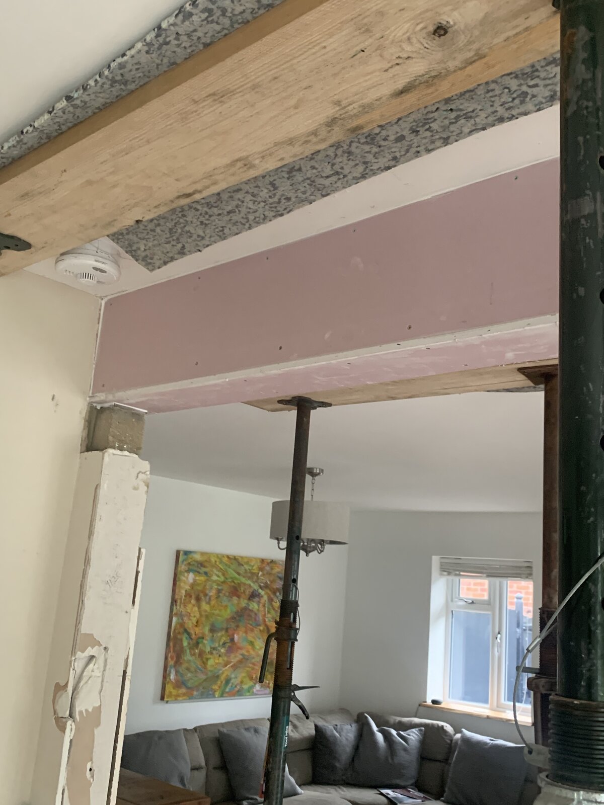

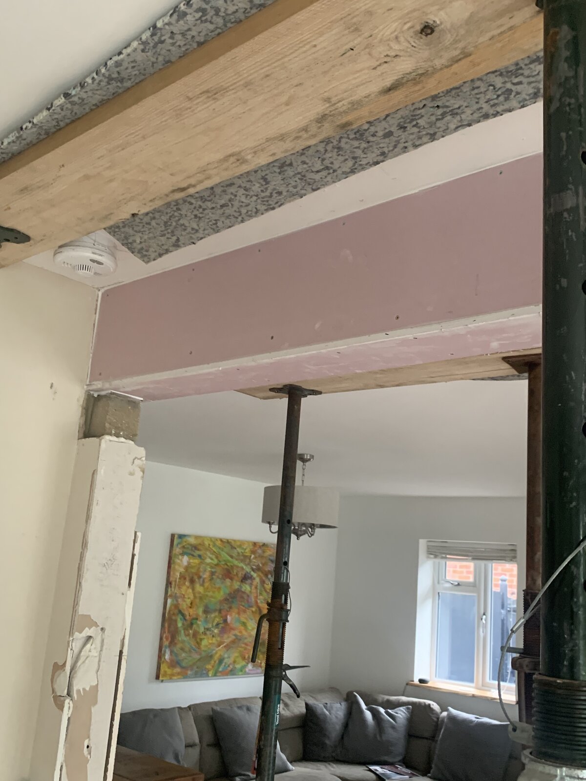

I cut correct size and screwed and glued to steel .The screwed and glued plasterboard .

In the event of a fire when a beam is protected by board on timber battens, the timber battens will expand and twist/deform at different rates to the steel beam as the whole thing heats up, potentially causing the boards to be forced off, the threads on the fixing screws holding the boards on can char the timber and loosen and pop out too, realistically it's not quite so important on a dwelling where the loads/risks are lower but these days post Grenfell everything ought to be done by the book. Commerciallly they've come down on this in a big way since. Only tested methods are acceptable.
Alternatively use Glasroc F boards of the appropriate thickness that needs no framing and the boards can be fixed into each other.

Glasroc F Firecase boards are also fine for this method. I daresay people will carry on using timber because they're misinformed/uneducated.
