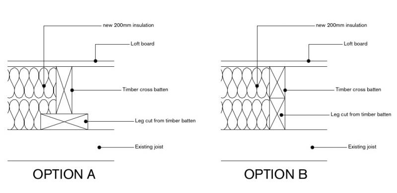

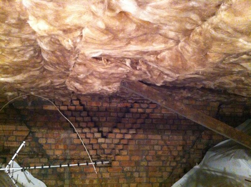

HI there,
So, as part of the EDF free insulation scheme I've just had my loft insulation increased. The original was about 80mm laid between joists and the new stuff is 200mm laid perpendicularly over the joists (see attached photo). I know need to board out the centre section for storage.
Was originally going to install 7" or 8" x 2" cross battens onto existing joists and affix loft boards to these. Having read another post here I'm thinking that I'll use a smaller section timber (to save weight and cost) and simply cut sections of the timber off to use as legs at each joist (see attached drawing ).
Now have the following queries:
-Which option of attached sketch should I use for the 'legs'?
-Intend to screw the boards into the cross battens but how should I connect A) legs onto joists and B) battens onto legs?
-What height above the joists should I aim for given the 200mm of insulation? Should I clear the whole 200mm or would I get away with compressing it by 20-50mm?
Would really appreciate people's thoughts on this as I hope to do it this weekend.
Thanks in advance

Having boarded out three lofts now, my recommendation is to remove the extra insulation from the area you are going to board, lay 100mm cellotex/kingspan down and just lay loft boards over the top. It is way way quicker than adding extra joists, and does not reduce the height as much as mineral wool/fibreglass, which makes getting into the loft easier as well, and does not add the weight of the cross joists to your ceiling. Costs more but if you plan on staying there well worth it. The first two I did involved cross joists, and it takes much longer than laying down cellotex.

As you have already laid the 200mm of fibreglass technically option B is the only one you can take. With option A you be reducing the level of insulation from one that meets current regulations (min 270mm) to one that does not which is illegal as you would be making it worse.
You can buy custom plastic legs to fit over joists and lift you up 200mm, but I worked out they where more expensive that the celotex, though that did include the cost of the fibreglass as well.
You could do a variation on A by getting a couple of lengths of 100x100mm timber to make the legs and then use 47x100mm or perhaps 38x100mm timber for the joists. 100x100mm timber is common for fence posts. That way you would keep the 200mm for the fibreglass but have more stable joists for laying your floor on. The joists in option B won't be laterally stable till you screw the floor down. Did I mention that you don't need to bother screwing the floor down with the cellotex method other than at the hatch :)

I should clarify that both options still clear the 200mm insulation. Option A uses 150x50mm timbers and Option B uses 100x50mm.

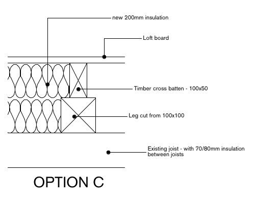

As per attached? How would you recommend fixing the 100x100 to the existing 4x2 joists and subsequently the cross battens to the 100x100?

Get some 38x63mm CLS and screw it to the existing 4x2" joists either side. Then use some 150mm screws to screw the 100x100mm legs to the CLS and 4x2", repeat to hold the joists down.
