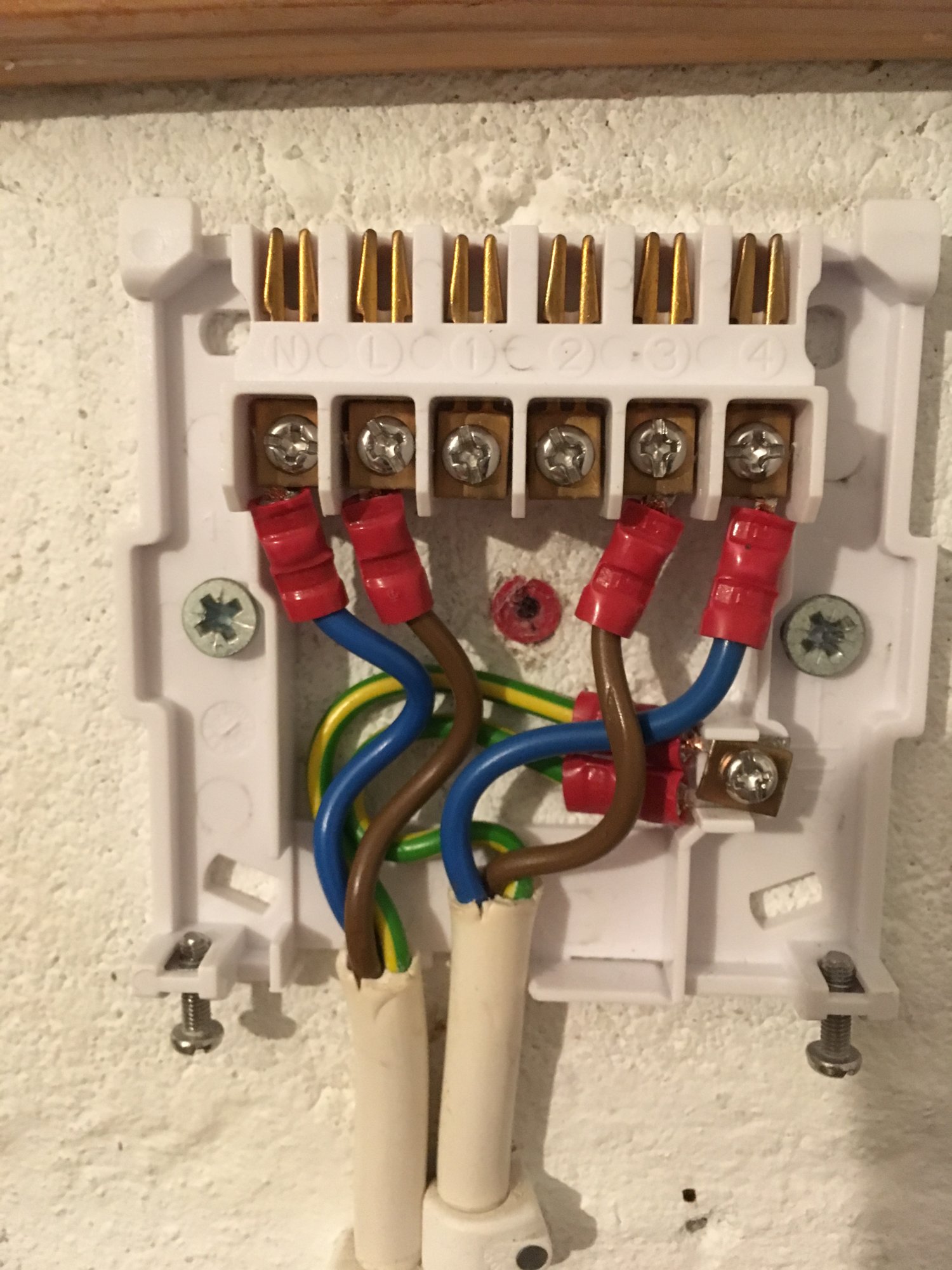

I installed a new hive system a couple of months ago as the old programmer started to give problems , all was working well until yesterday.
The central heating seems to be constantly on .
Would this be down to a stuck valve or something else ?

It is on all the time even when the stat says it is above the set temperature. It is a combi boiler .
I suspect it will be a valve will check them

It’s an oil combi camray 5 ,
I’m starting to think I may have the wrong hive receiver should have a single where I have a dual . Doesn’t explain why it has been working until now though
With the camray a common fault is the diverter valve actuator it could be sending a signal to keep the boiler running.Bob

The wiring of your Hive shows a connection has been made to the hot water control terminal (Brown wire, terminal 3) so both channels of the Hive are being used for something. Nice installation with the cable ferrules too!
I'm not very familiar with oil boilers, as the two guys I used to assist regularly are Gas Safe, so I didn't see oils boilers much. However if your boiler has a pre-heat facility, or some internal storage of hot water that has the facility for external control, then the dual channel Hive would be correct. If so, I would have expected that you will have set the timings for it, so would know what it's doing.
Regarding your fault, I would put my money's on oilboffin's post, he's usually spot on.
I think it is the actuator and the valve , I loosened the valve off as it was a bit stiff but the actuator is struggling. It is now operating as it should just slow to react . New valve and actuator on order .
