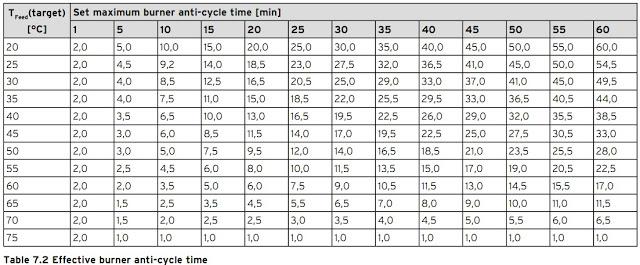

d02 parameter.
Should default to 20 minutes though. Unless you are running your heating very hot at 80 degree in which case it is 2 minutes. Turn it down to 70 degrees and you should get 20 minutes between firing.
Manual says it should be set to 20 minutes. Boiler set temperature is 73 degrees.
How does this setting work? Does it set a minimum time between ignitions?
d.2 is a table that varies the time. However on Vaillant it does not directly relate to the actual decimal value of the parameter. I do believe that the glowworm is based on the Vaillant so you could see if it matches the table. There is a countdown timer that show the actual remaining minutes within the settings of the boiler.
So with it set to 20 you are getting between 2.5 and 1 minutes anticycle. Crank it up to 60 and see if it extends.

I played with the anti cycle d02 setting and increased it from the default 20 to 25. This had the effect of increasing the countdown timer figure from 6 to 7. I don't know if this is minutes, but as the pump overrun timer is set to 5 minutes and the boiler seems to restart 6 minutes after going into overrun it would make sense.
However, the thermostat call seems to override any anti cycle setting.
I lowered the thermostat set temperature below the shown temperature by 1 degree to shut down the boiler. The anti cycle countdown timer duly started to count down. I then increased the thermostat set temperature above the shown temperature and within 10 seconds or so the countdown timer went from showing 6 minutes remaining to zero and the boiler relit.

are you sure you are in anti-cycle mode? What s code is being displayed? You may find that the boiler has not actually cycled. Strictly speaking a cycle is when return has come within the delta of the flow according to whatever the designer of the boiler thought was the time to switch the burner off. To explain, say a flow temp of 65 is set at the boiler when the return gets to 62 the boiler has run out of headroom ie heat input is greater than you are loosing, either via the heat emitters or the cyclinder coil. The boiler will then truly cycle and start the timer. Playing with the roomstat can be determined by the software as something completely different on some boilers depending on the logic on the pcb.
Please don't think that you can also mimic a true cycle by adjusting the flow temp of the boiler as this once again will complicate issues.
example
flow temp of 40 anti cycle set to 60 which is 38.5mins if you then waited 20 mins before turning the flow to 60 which has a timer of 17 mins you wouldn't expect the boiler to fire for 17 mins but it actually already knows it has waited 20mins so you are on on a negative integer of 3 hence boiler fires but the table says it shouldn't for 17mins. So who knows what will happen if you start messing with flow set points.

When the house is heating from cold the boiler gets fully up to temperature and then the stat turns it off when its up to temp. That is a full cycle so when the stat calls for heat approx 10 minutes later the anti cycle timer has gone down to zero and the boiler relights. However, it doesn't take much heat to trip the stat so the return hasn't got up to temperature before the stat trips again and the boiler doesn't see it as a cycle and therefore ignores the anticycle timer when the stat calls again thereafter.
