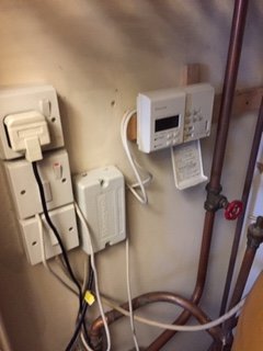

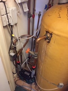

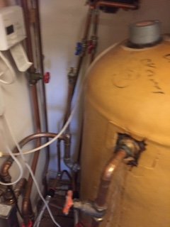

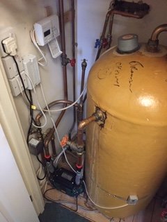

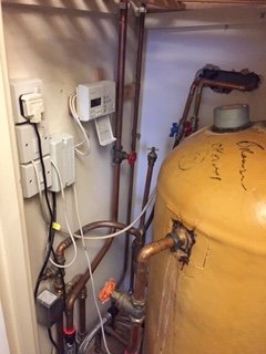

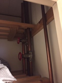

Not sure if these are any use but this is the airing cupboard. Have some pipes to loft and some downstairs.

You do indeed have an indirect HW Cylinder , this will be served by the Combi boiler and the immersion heater is just a back up, you have a control fault somewhere, most commonly a zone valve
Sorry what does that mean? Ihave valves in the airing cupboard and valves by the combi.
The silver box next to your cylinder is a three port valve, it directs water from the combi to heat the HW or the CH or both at the same time, depending on what has been selected, there is either a fault with that or the small grey thermostat on the cylinder itself, you also have a gate valve (manual valve with round red handle) on the flow to the indirect coil, make sure that has not been closed by mistake, for future reference your system is a fully pumped Y plan with Immersion back up
Thanks. What would the fault be doing? Are you saying if it weren't for the fault I could turn off the emersion and all hot water would come from the combi? Why would they keep the emersion if the combi can service the house? surely it's more cost effective to just use the combi?
yes the immersion is only for emergency back up to give you HW in the event that your combi boiler faults
