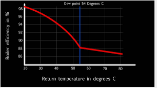

Strictly speaking it's the actual return temperature that's important for condensing, not the drop between flow and return, but they are of course linked. The lower the return is below about 54C then the more the boiler will condense. If both your thermometers are equally wrong ;) then you might have a return of 46C, in which case it should be condensing moderately.
20 degrees between flow and return on condensing boilers is what it should be, in order for it to be most efficient. If you know how to access the D codes, then D40 and D41 will show you flow and return temperatures respectively. 60 degrees on the display will be the temperature inside the boiler heat exchanger.

Right. This morning I raised the flow temperature from 62 to 65. I set the room stat at 25° and ran the system for 30 minutes with just the rads on that we have on in the evening - Lounge (no TRV), hall, downstairs WC and bathroom towel rail which do have TRV's set around halfway. Flow was 65 and return was 49°. I then opened fully all 10 rads in the house, set all TRV's on max and after 15 minutes with a flow of 65°, I had a return of 42°. Not a 20° drop with just four rads but I read the return had to be under 55° for it to condense. Does that seem all okay?

Seems ok, but it’ll just condense less. What about leaving the others on the minimum?
