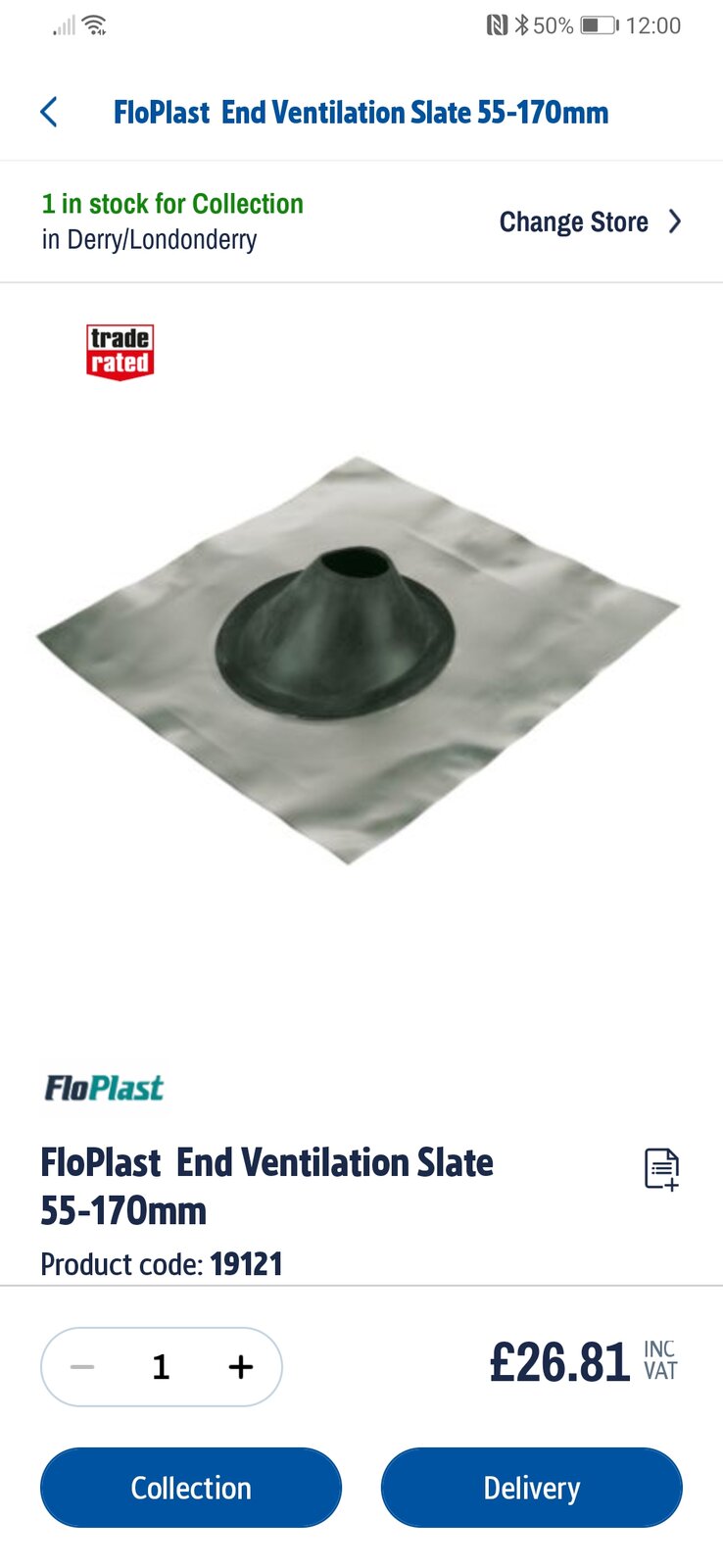

May I ask what the difference is from installing one of these boys as they look a lot easier to install.
At risk of answering my own question, not suitable for a boiler flue as it heats up to much could melt the rubber gasket/seal around it, I read somewhere they are really for flat roofs or soil pipe?
If I had not asked on this forum prior I probably would of went ahead and installed this.
They are actually more difficult to install as the rubber has to be trimmed exactly to be a tight fit to the pipe...the rubber perishes over time and leaks...they can be used with twin walll...the system I have linked to is far superior

The best option has been suggested by another. , lead slate and collar. the rubber one will be difficult, even though it looks easy.
