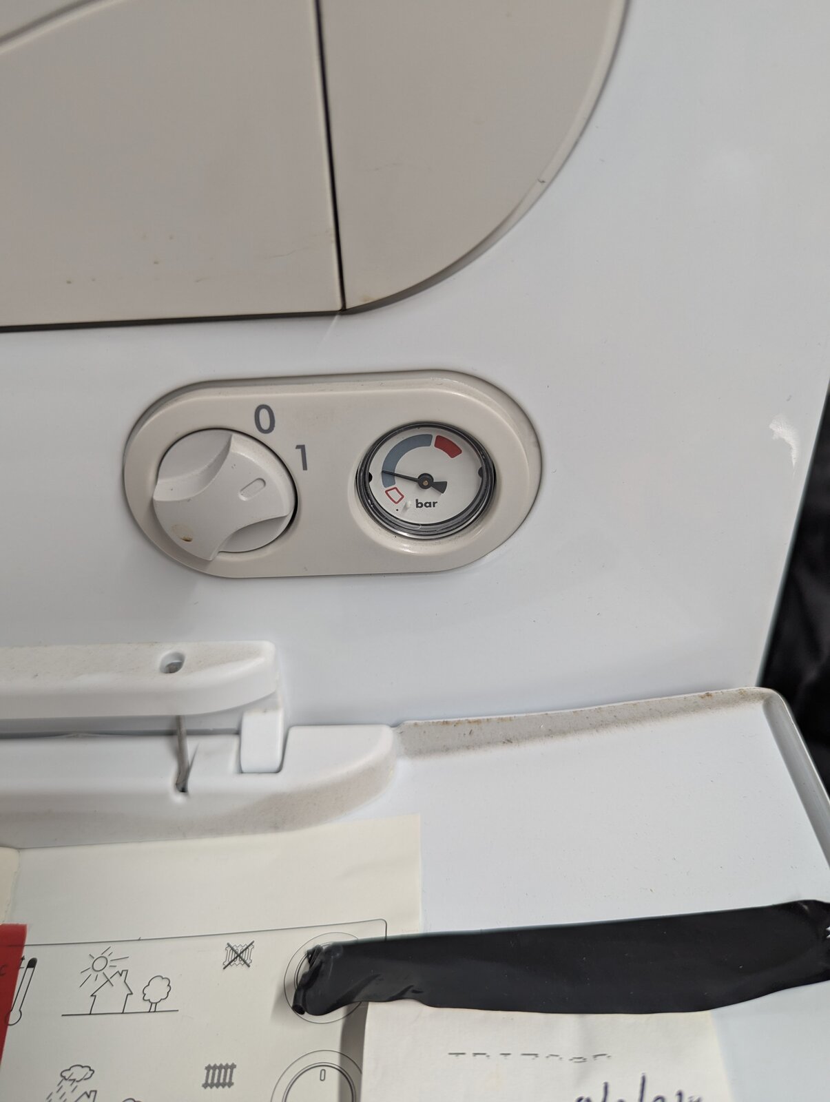

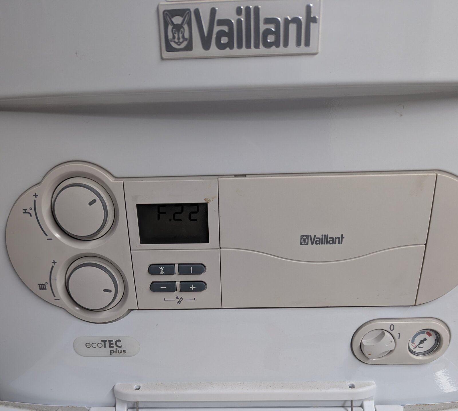

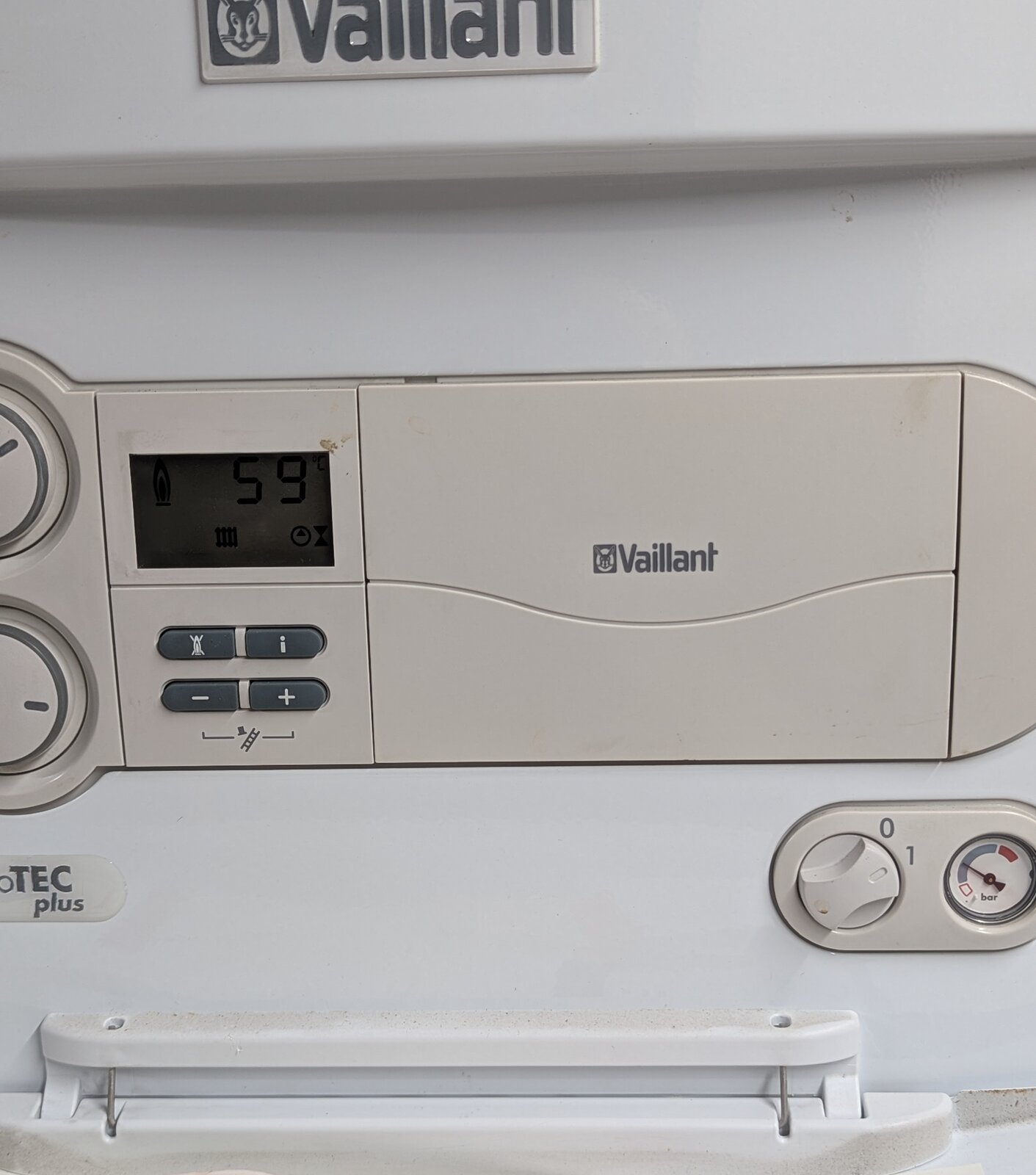

So here's some pics, f22 again this morning, then initial top up pressure and after running heating for 15 mins so a slight increase?
If that's the pressure after about 10 minutes then the expansion vessel is pretty much ruled out - but worth getting it checked

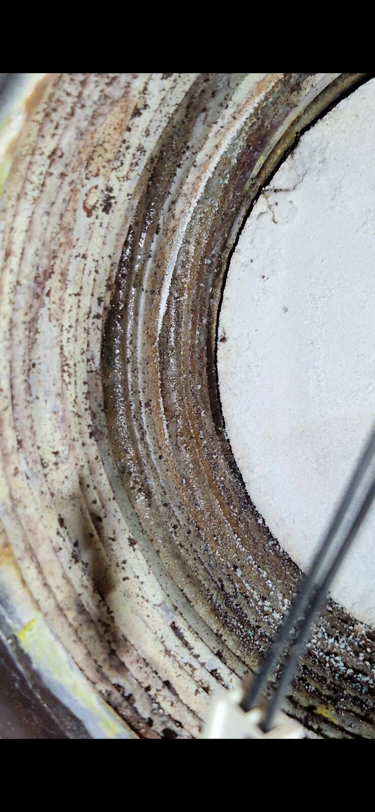

View attachment 375420picture of a leaking heat exchanger in vailant ecotec.
Eventually he will have to open to confirm if it's leaking or not.
To be pedantic that's inside the combustion chamber with the burner removed showing a leaking heat exchanger but I get what you're saying
