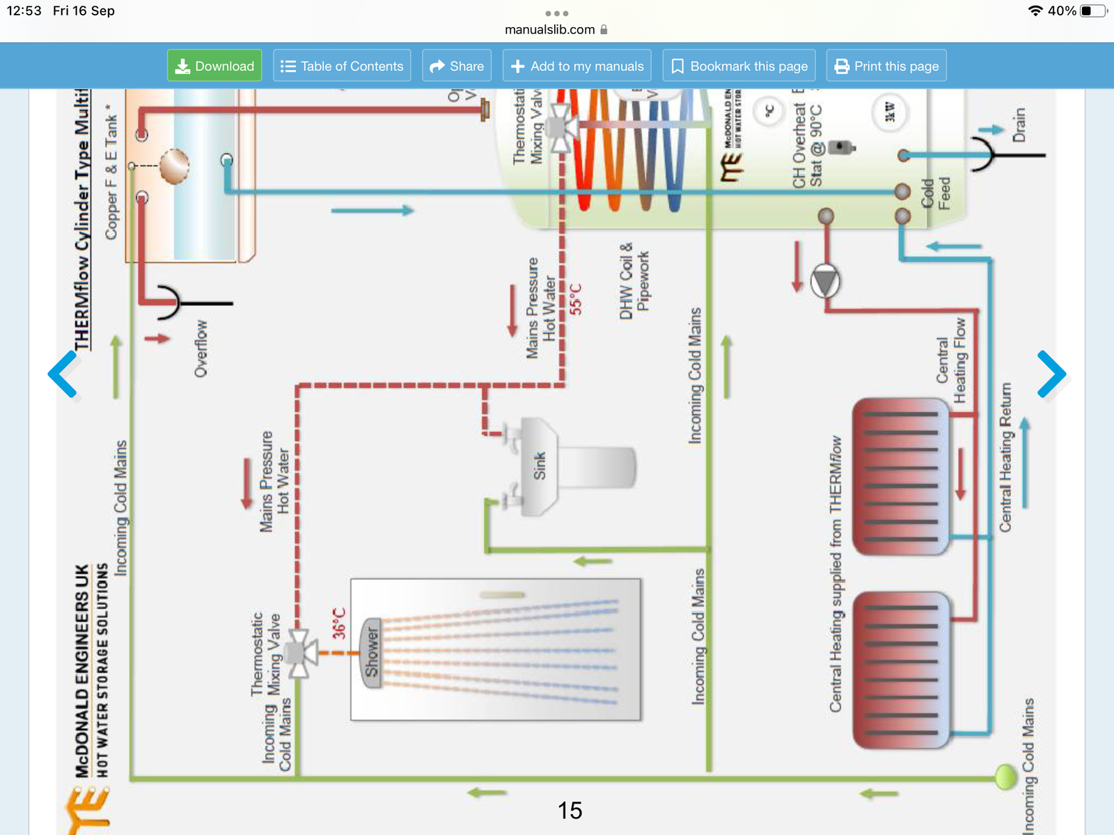

Some details of the system:
Boiler: Worcester Greenstar 8000 Life. LPG. (Sealed system) Only heats the cylinder - no other function.
Thermal store: McDonald Thermflow 250l with F & E tank. Vented
Both units are installed on the ground floor with the boiler mounted slightly higher than the boiler flow connection on the cylinder. There are no external valves in the flow and return pipework between the two units. The 22mm pipework runs from the boiler vertically to the first floor where it runs (under the floor) to the point where it runs vertically down to the cylinder. The flow and return run in parallel. The length is approx. 10m
Electrically, there is one supply only to the boiler panel. There are no other electrical feeds to the boiler. When powered on the boiler is controlled by a stat via a Danfoss programmer which takes its power from the boiler panel.
Normally, in winter months the system works and controls well with no issues. It is less than 2 years old.
In summer, to save costs, the boiler is switched off at the local isolator AND at the db (to avoid it being switched on inadvertently). The immersion heater is then used to heat the cylinder for DHW.
Following some of the earlier comments, I’m now of the opinion that convection is the cause of hot water circulating through the boiler. But.... how to stop it?

Why do you think using electric in summer for the HW is cheaper? Have you taken readings to compare with gas? Electric costs about 4 x gas per kWh, and though nearly all the electric power goes into the water, gas has some losses due to boiler efficiency and pipework heat loss, it's unlikely to turn out dearer. But gas has the downside of heat loss in hot weather might make the house too hot.
I think we've established that the problem is due to convection. Convection flow will be out of the thermostore top connection, opposite direction to the pumped flow. A non-return valve, suitably located, could be the answer.
Draining down every year seems a bit of a faff. I don't know about legality of a manual iso valve, perhaps gas safe guys can comment. An alternative could be a motorised valve (as Jeff said), with limit switch to fire the boiler only when the valve is fully open (as on an S-plan system)

Thank you all. I’m impressed by your expertise and advice.
To summarise my understanding of the issue based on the comments:
1. The boiler is slightly higher than the thermal store resulting in convection of hot water running in reverse via the boiler flow. This is enough to cause a constant flow of hot water through the boiler.
2. The valves within the boiler panel are slotted but were too tight to turn. Logically, as was suggested, closing the valve would stop the circulating hot water but I don’t have the confidence (nor the experience) to try forcing it.
3. Adding valves (NRV, 2 port v/v etc.) seems to offer the best solution and l will discuss this with the boiler engineer on his next service visit.

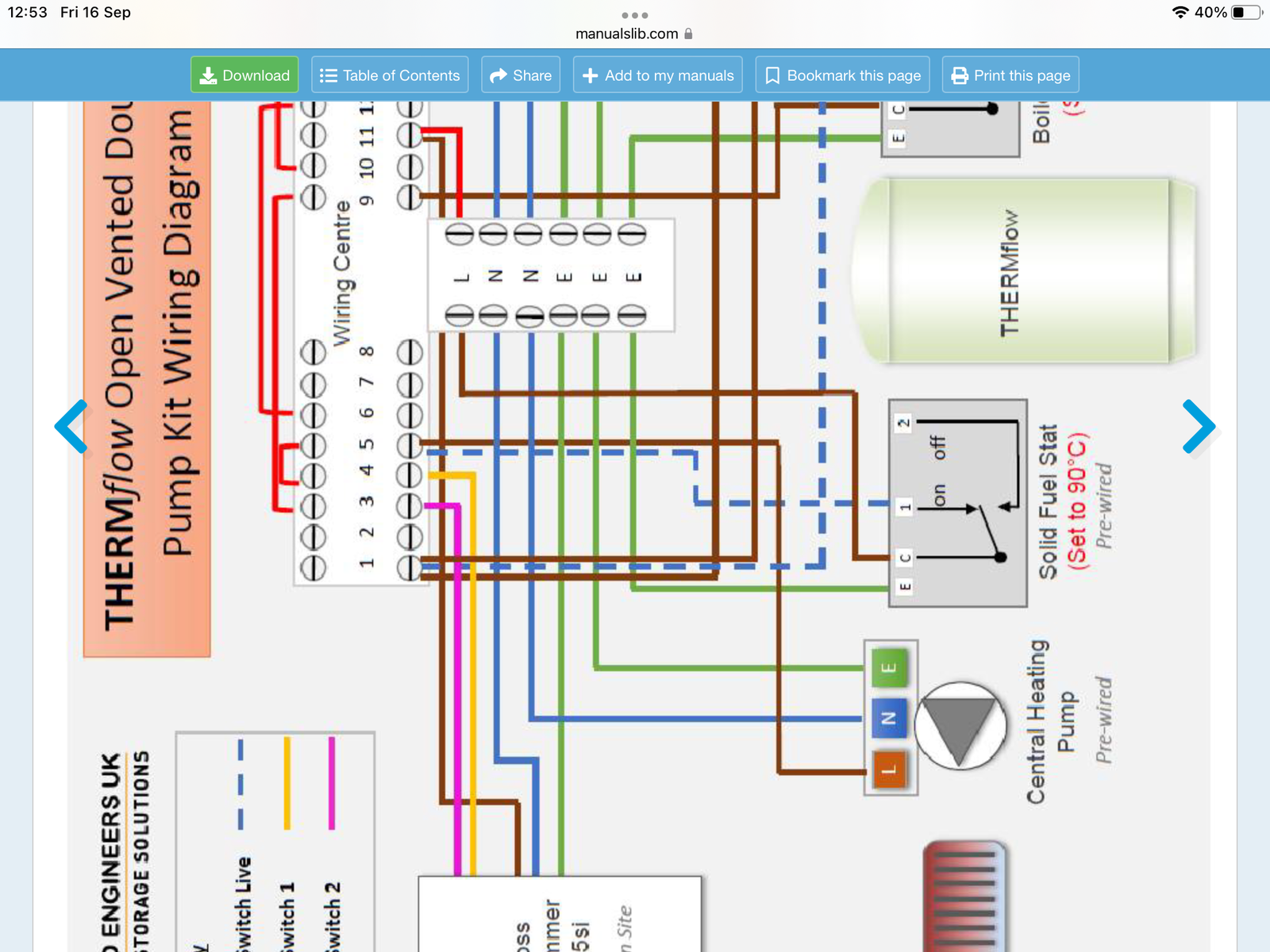

Suggest you look at the manual for the cylinder.
Please explain how the operating details of the cylinder affects the OP's problem - pipes between the boiler and cylinder getting hot when the cylinder is heated by electric?
Can you respond to some of my comments on your earlier post?
