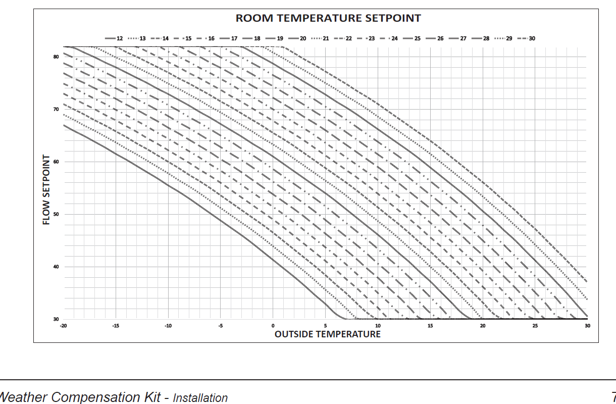

I’ve noticed over the last couple of days, my boiler is short cycling.
The weather comp has been showing 11deg, room stat is set at 20 deg.
When the room stat calls for heat the boiler fires up and it seems to settle down to a flow temp around 45 deg
But after a while the boiler stops firing but continues pumping and then the boiler fires again but sometimes for only a minute or so….and the flow temp at this time has dropped down. I’m guessing the boiler can’t modulate down enough, but I’m not sure if there is any mechanism to reduce short cycling. The upstairs TRVs were all on low, around 1.5 so I’ve turned them up, maybe that will help (not sure why).
The boiler I have is the Ideal Vogue gen 2 18kw with a modulation ratio of 7:1 it’s a typical 1960 build semi with 8 rads, not sure if heat loss
I did wonder if the 15kw model would’ve been better, although I’m doing a garage conversion with 3 more rads this year so.

There's not much difference in the minimum output between those two boilers. In nominal terms anyway. I suppose proportionally, yours is 20% higher.
Are you sure it has modulation ratio of 7:1, I've seen a min output of 5.9kw?
Edit: yes, think it is ~ 3.5kw.
Do you know what weather compensation curve its on?, it may be curve 20?
It is set on curve 15, I think, the menu isn’t all that clear.
If I understand correctly I need to have a higher curve number to raise the flow setpoint.
Judging by the graph there needs to a compromise between keeping flow rate set point at highest outside temp sufficient to minimise short cycling and the flow rate set point at the minimum temp staying low enough so boiler return temp is below 56deg so boiler condenses.
