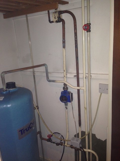

Can we have some pictures of the pipwork etc in the Airing cupboard please for clarification? If you do have an air seperator, (the metal can I spoke about), these are notorious for blocking. Whilst the pipework either side may well still get hot, if the flow of water past the blockage is poor, then it will lead to the circulation issues you have described.

here it is :-)

Looks like its already been replaced once! Try a magnet, see if it attracts. Notorious for blocking, those things, you may be better off removing it completely and making a 'H' out of the pipework.

I have a magnetic timer in my kitchen, i've put it against the air separator. Didn't seem to particularly attracts but now the timer is quite heavy so maybe should try with a lighter magnet...

Maybe a silly thought but if i have a solid block in my air separator or nearby, could I try using a drain cleaning wire from the F&E pipe down to the air separator? (although I think in the loft the pipe has a 90 degree or so angle so might not be easy...)
Not such a silly thought ! You could cut the vent pipe above the waterline in the F+E tank then use the wire - if you get a good one with a cranked handle you can agitate the end around in the air separator. Just replace the pipe using a compression coupling.(y)
Was thinking that maybe I could access it from underneath, i.e by disconnecting the pipe between the air separator and the pump (where it join at the top of the pump) and use the wire from there to try and remove the block and make it fall into a bucket or something...
