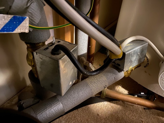

Have a look near the hot water cylinder for valves like this...
There look like 2 - one going into the cylinder and one not....

One of them is most likely the problem, as you seem a bit unsure maybe best to get someone in.
Disconnect the valve for the heating (remove the power wire) and see if the boiler switches off.
If it does that's the problem, get a new valve head and install, though check the valve in the body isn't seized
Dumb question but i'll check - Is the heating valve the one adjacent to but *not* connected to the inlet to the cylinder?
Just want to be sure that it's that 'other one' in the pic or its likely to be elsewhere in the house....
The heating one is the one nearest the camera, on the left in your photo, which is probably the one which has stuck.

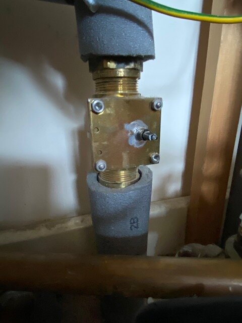

Isolate the all the power, then see if you can remove the actuator (that is the silver coloured upper part) entirely from the water valve. Usually they are fixed by a couple of screws. The actuator operates the valve by rotating a D shaped spigot sticking out of the valve - see if that spigot is reasonably free to move. You should almost be able to turn it with just your fingers, but may need a pair of pliers. Try refitting the actuator, make sure the cable comes out of it in the same orientation as it was removed.
You may now find your heating works normally. Report back.

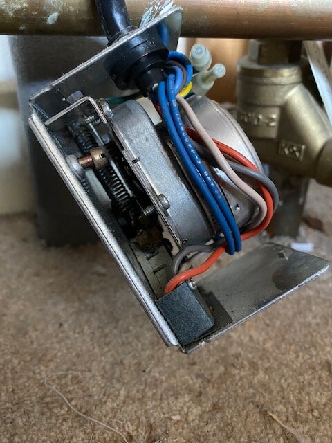

Your actuator will likely be what is called a spring return actuator. When powered, when heating is demanded, a motor drives the valve to the open position against a large spring. When heat is no longer needed, the motor power is removed and the spring causes the valve to close. The actuator has micro-switches inside it, which trigger the boiler to run, when either the CH or HW valve is in the open position. You CH valve was stuck in the open position, resulting in constant heating run.
In normal operation, you can hear the valve run for a few seconds with changes in demand when the thermostat clicks.

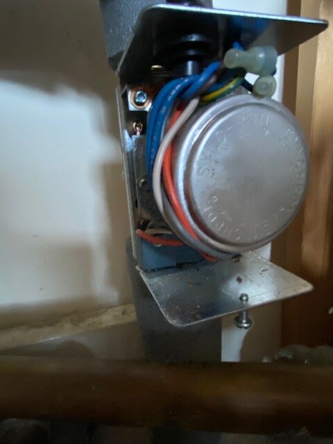

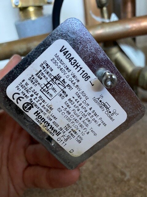

Ok thanks - progress. I took the actuator off and the valve moves easily with my fingers.
I re-fitted the actuator and then turned the heating on - no noise.
I turned the hot water on and the other valve/actuator makes a definite click/noise both turning on and turning off.
So do I conclude the actuator is dead? It definitely has power.
