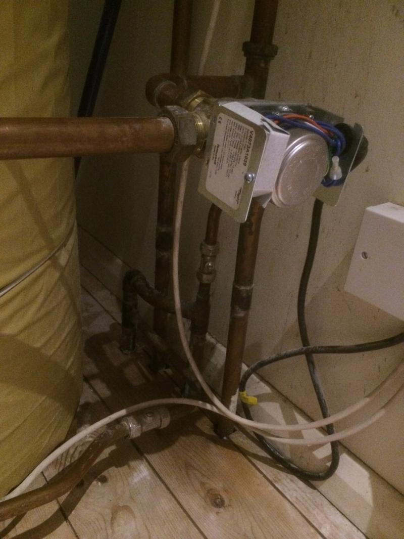

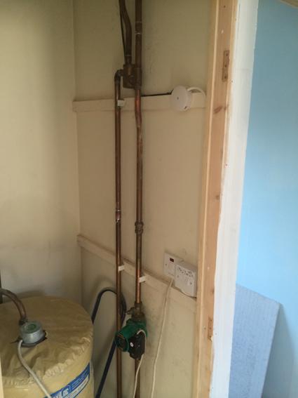

More info about the system, please.
Make and model no of all components,except boiler and HW cylinder, will do for a start.
A pic of the cylinder cupboard, so we can see how everything connects together, would also help.
That's the old pump. New one is a Grundfos.
