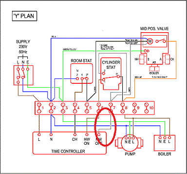

The wire highlighted in the diagram below, that links the motorised valves grey wire, (and the cylinder stat satisfied terminal) to the programmer HW OFF terminal 1, is what you are missing.
Apparently so (see below). So what do I do about it now?

what is the grey wire from your Motorised valve connected to ?
Grey wire from 3 port goes to blue wire from cyl stat - no other wires exit from this part of the connector block, so the mysterious wire that 'should' go the terminal 1 isn't there.

No you do not have a priority HW system, you have a system that is wired wrong
AGAIN wire colours mean diddly squat, is the blue wire connected to terminal 2 on the Cyl stat ?

It is not clear to me which terminal is which on the stat, but assuming it is correct - You are still short of one wire linking terminal 7 in the joint box, to your timer's HW Off terminal.
