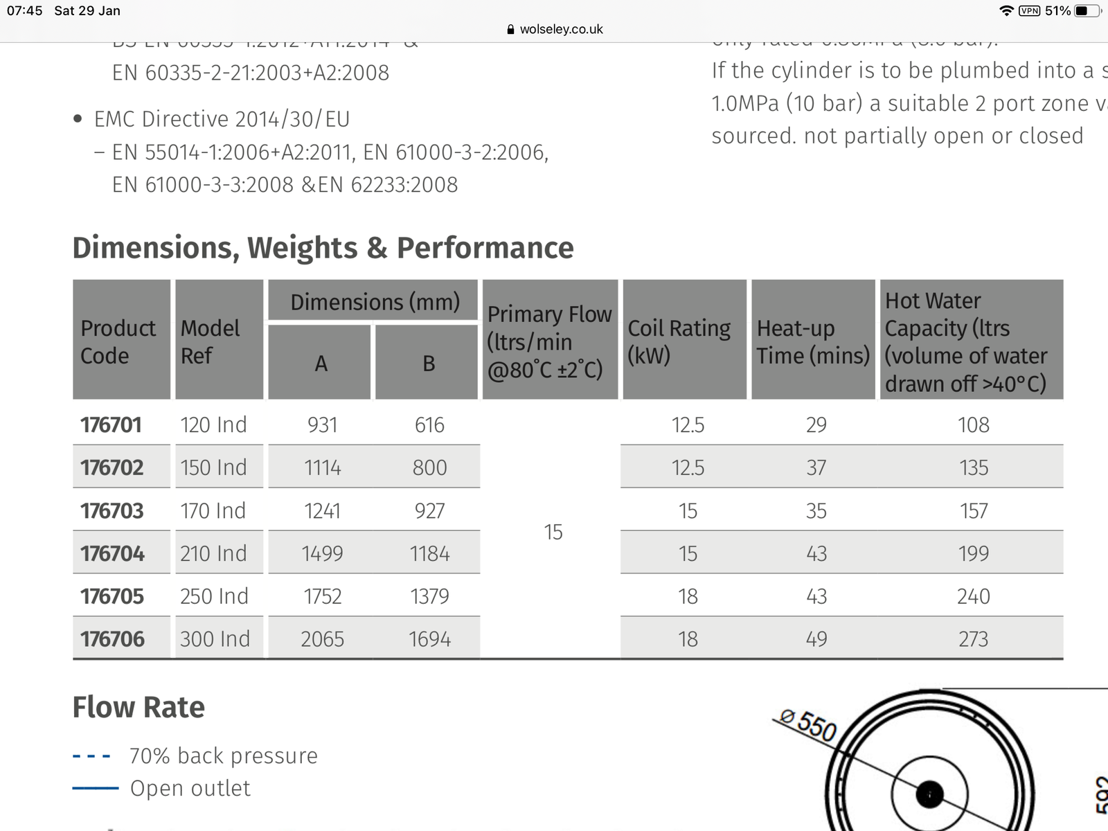

Look at the coil spec in the picture below
117 litre cylinder heated to raise the temperature by 50 degrees
=6.8 kw/h
just because your boiler is cycling does not mean the coil is rated at same input as the immersion heater
Boiler switching off for three to four minutes means boiler is letting the cylinder catch up.
BTW, 6.8 kw/h is the energy required to heat 117 litres of water by 50 degrees C. 6.8 kW consumed for 1 hour.
The load, ie the indirect coil, could well be say rated at 18 kw. Boiler initially will run at full power until the secondary water temperature starts to rise. Same scenario where a big pot of water will take all the energy from a burner, even a BIG one, but to maintain temperature at target point, burner can be at minimum flame.

Forget the 3kw figure. That is for the immersion heater
Then forget about the vented boiler and unvented cylinder ‘compatibility’ as unvented cylinder is unvented on hot water side and not the coil that is connected to the boiler.
If your cylinder coil is rated say 20 kw, run the boiler to heat radiators and cylinder at different times so boiler is not like a candle in a big room

If that was the case why may cylinder manufacture say water in cylinder will be hot in say x minutes but immersion heater is only 3 kw.

Just because your cylinder is not making proper use of boiler output does not mean that is the norm, neither is furring of the coil across length and breadth of the country.
I quite agree, and if it caused me a problem I would do something about it, but it doesn't. No doubt mine had higher input when the cylinder was new, probably the figures on your chart will drop off when they're a few years old.
