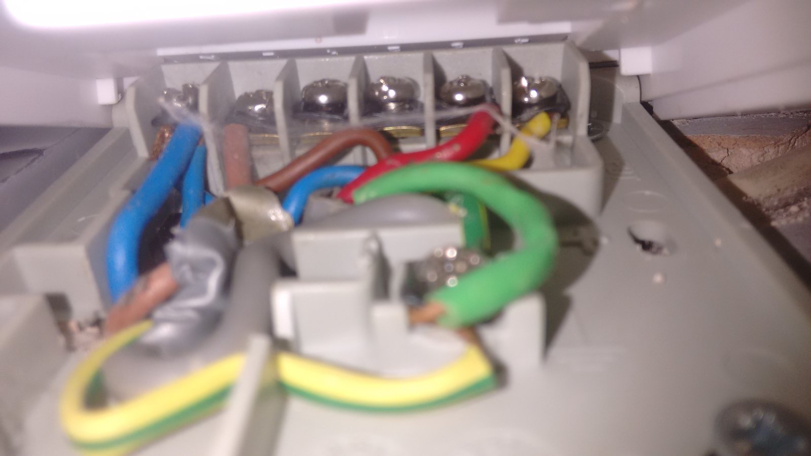

Check on the boiler wiring panel (turn power off first) and look and see if there is a red link installed between SL and 9, in fact if you can take a pic and post it of the boiler wiring
Thanks again for the reply.
Unfortunately the tiler decided to seal in the programmer with grout when he did the kitchen but after breaking some of the tiling away underneath to get at the screws I managed to take this photo looking up at the wiring from the bottom of the programmer.
Sorry it's not great but from the wiring diagrams I found online it seems to be correct?
N L 1 2 3 4

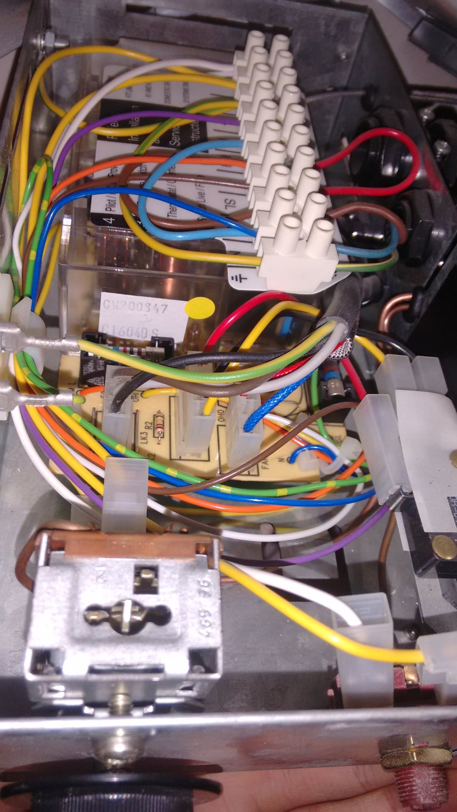

I meant the wiring panel on the boiler itself, with your installer saying you have to have HW and CH together, I am wondering if the Gravity hot water link has been left in.
Ah ok sorry picture of the boiler wiring below.
Also I tried to turn the CH on without the HW and it wouldn't fire up so the programmer must need both to be on for CH to work but HW will work albiet with the problems described in the original post.
OK it is as I suspected your boiler is wired wrong, if you have 2x 2port valves then the pump has to be wired into the boiler and That red link needs to be removed and your external controls wired through there, I think you might need a proper engineer as I think the rest of your wiring is slightly wrong too, but your boiler id defiantely wrong and that is why the water is getting too hot, @stem might be able to run through how to wire your external controls in correctly, he has a lot more patience than me
Hi Ian, Thanks again for all your help with this. I definitely don't want to be changing any of the internal boiler wiring myself so I will get an engineer in ASAP and I'll have them check the external wiring at the same time, hopefully I will be able to get the panel open without removing any tiles :)
it could just be connecting the two orange and two grey wires from the zone valves into the terminals when you remove the red link, but you must get the pump wired direct from the boiler for your system as that controls the pump over run , you dont need that on a gravity hot water system, make sure you ask when you call if they are familiar with wiring S plans systems
