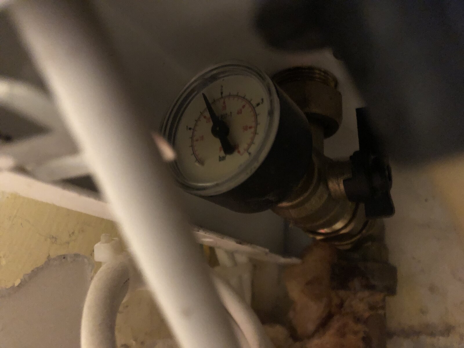

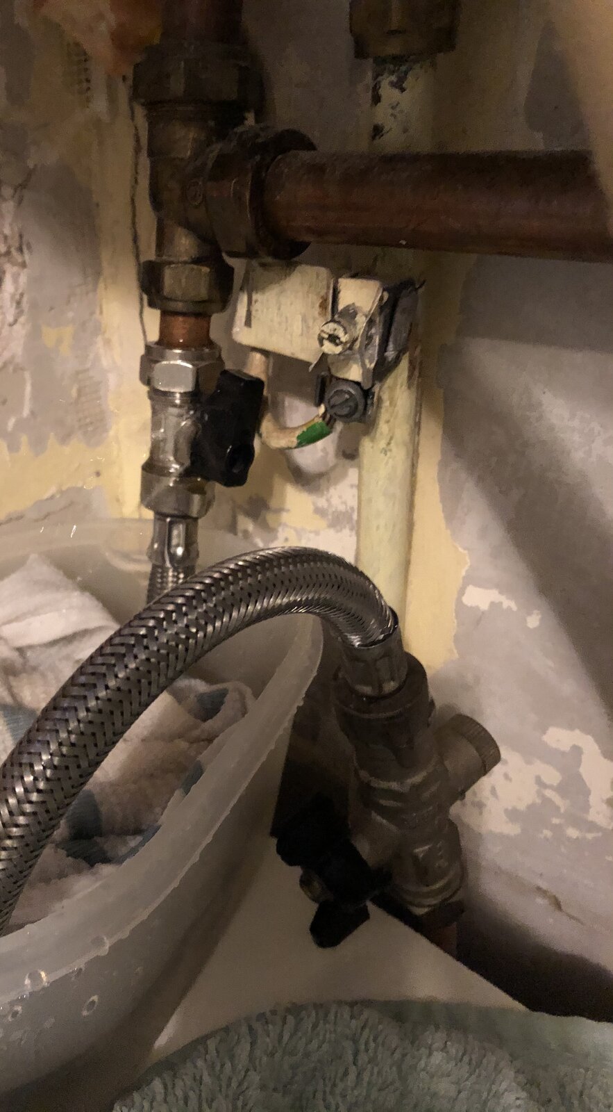

Boiler pressure gauge at 0
right put the one at the guage back to the position it was in , but leave the other two like that
You mean open? See images please

Regretting bleeding out two radiators! Now none of radiators will be heated!
And I’ll suffer in the cold! What have I done!!

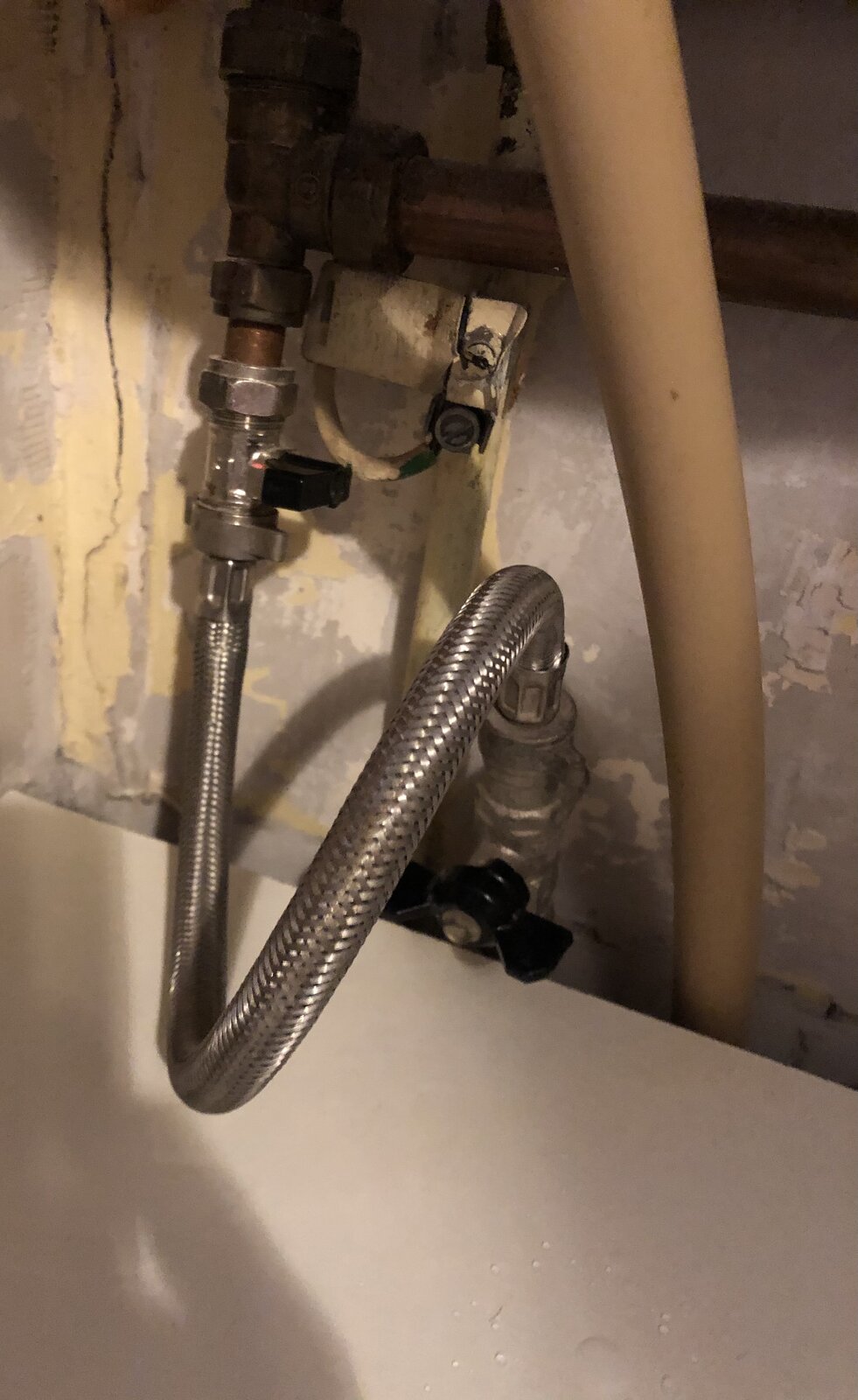

Does the black handle on the lower end of the Flexi hose ,feel like there is resistance when you turn it ,or does it feel very loose ?
If the latter ,it may not actually be turning the shaft beneath it.
Or your non return valve is stuck closed.
Does the other black handle on the other end of the Flexi feel very loose ?

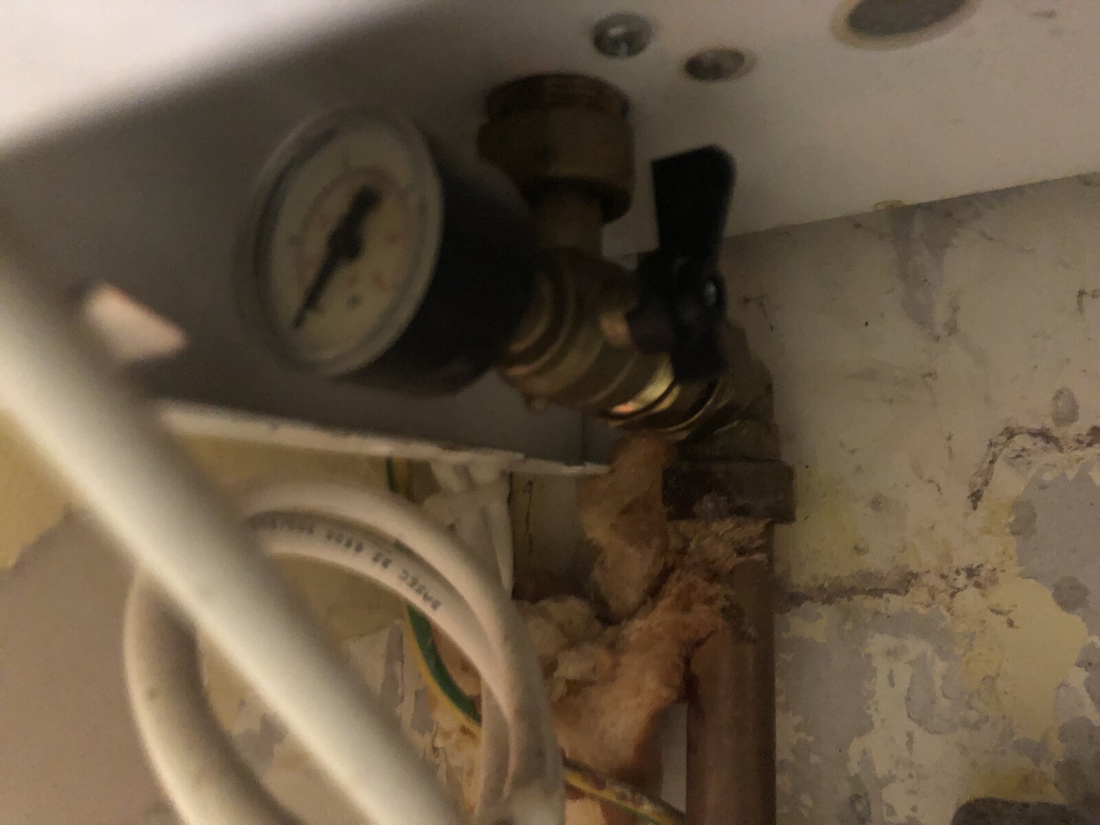

I turned on the boiler and pressure gauge is looking better. why would it not show me this reading while at off?
Sticky valve. When pump started its kicked it into life. I assume boiler is running now and rads are heating .

Have you closed both valves on the hose ?
Start a new thread on the pump issue ,and give more details of what it is connected to .
Go to your local plumbers' merchant and buy a "15mm filling loop". Have that ready for when next you have that elusive plumber over.
And for future reference, if you're not sure if a 1/4 turn valve is open or closed, turn it 45 degrees - it will be open then. Listen for the roar of the flow of water, then turn one of them the rest of the way...if the noise stops then you've just closed that valve, if it carries on then you've opened it.
