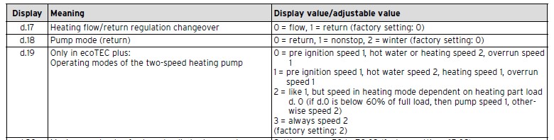

Setting d.19 = 1 should mean that everything is on low speed but I'm not sure if there is any way to check pump speed?

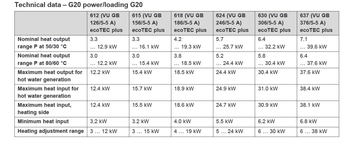

Looks like you havn't got the pump speed parameter.

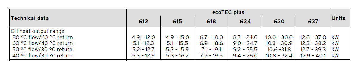

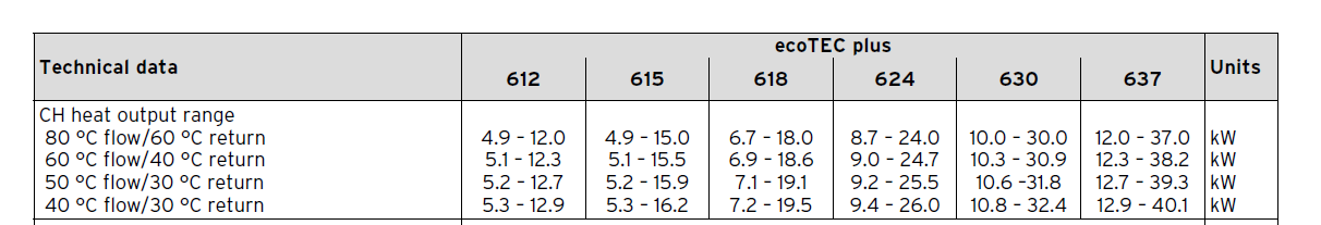

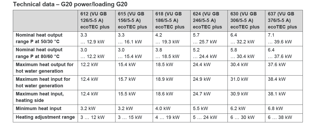

Also looks like your minimum output is 12.0kw, probably why your boiler cycled after running for 1.5 hrs with everything on this morning, not much you can do about that except to get all settings as best you can to get it to refire without constant cycling and get a continuous run for 3 or 4 minutes at least as this has only a very small effect on boiler efficiency.
The attached is the boiler you have, I think?.
  • Vaillant Ecotec Plus 637 OLD.pdf

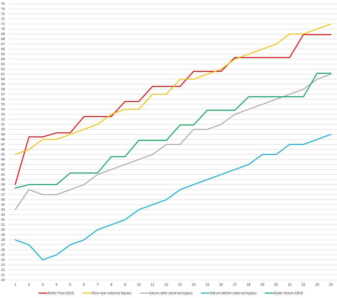

Well wasn't expecting that. Looks like the external bypass is letting the flow through.
The temperature just after the bypass is near enough the same as the boiler reported return temperature and not the same as the return temperature from before the bypass about 50cm away from it
I wonder if it was broken when we had a power flush done recently?
Interesting, so the return after the external bypass at 61C is a mixture of the system (rads+UFH?) water at 49C mixed with external bypassed water at 69C?. and since the ebus boiler return temp is also 61C then absolutely no internal bypassing which probably makes sense since the circ pump is on its low(est) setting so pump head not enough to open the internal bypass.

The ABV is one of these Honeywell DU145 ABV
The test was with just the radiator demand on with probably most of the TRVs open. The ABV says it is set to 6 bar but the top comes off of it so I've tightened it until I can feel it click which I assume is now at 6 bar
Also Vaillant Technical Support has confirmed my boiler can only modulate down to 12kW!

Its probably knackered or some crap under the seat, I would install a manual bypass with it or without it as the boiler internal bypass is quite adequate IMO.

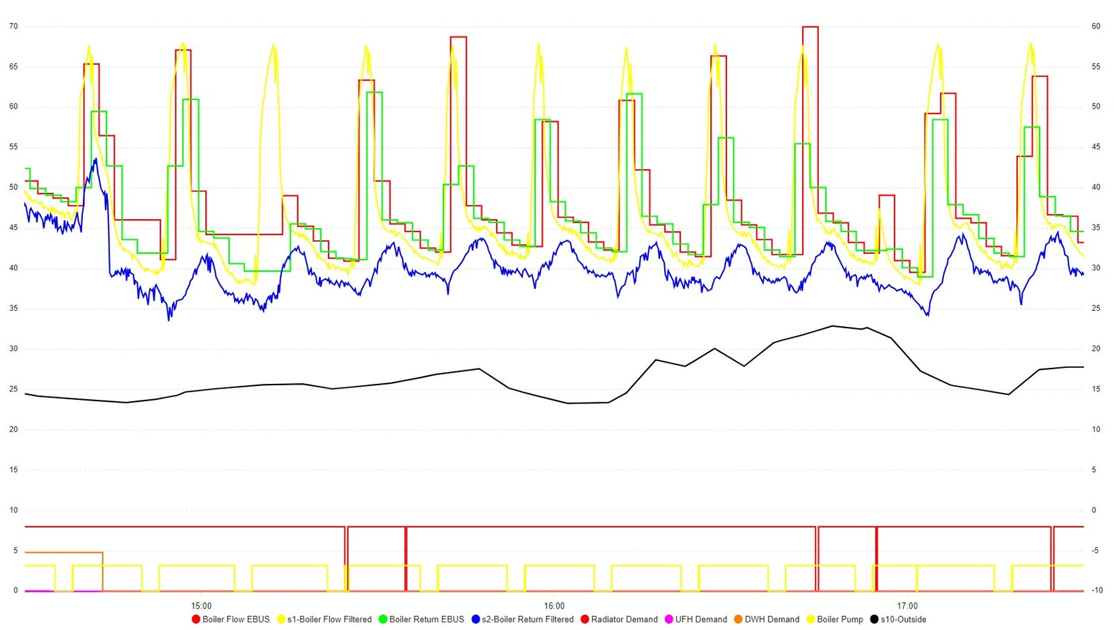

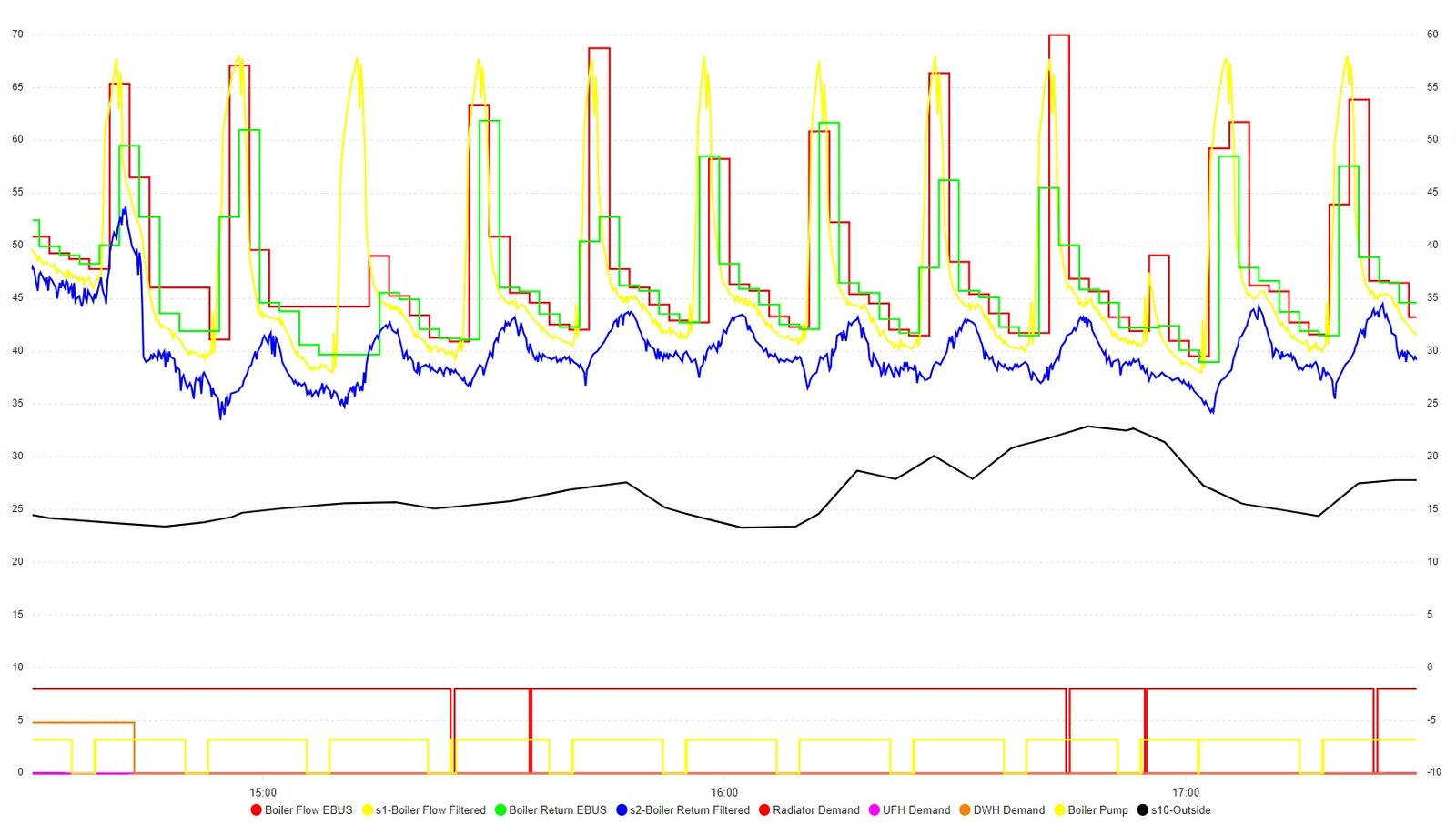

Tried setting d.1 pump anti cycle to 10mins (from 5) and d.2 burner anti cycle to 60mins (11.5mins for 65 flow target) from 20mins
It looks like it is cycling over 12 mins period and pump running for 9/10 mins after burner switching off so only 3 min burn at a time
This is slightly better than the 7 min cycle with a 2 min burn for the d.1 = 5 min d.2 = 20 min settings
Changed d.1 to 20 mins to see what effect that has as d.2 is at it's max. Will post that when I have results
20240324 3min burn 10min pump anti cycle 2 min (12 total) burner anti cycle.jpg
d.1, pump overrun time, probably won't make any difference as its only used when the room and cylinder stats are both satisfied or programmed off. Once you sort out that external bypass then more water will pass through the rads and should result in lower flow/return temperature after recycling, they seem to be ~ 47C/42C ish now at the end of the recycle time?.
The boiler cycles horribly most of the time as you can see on the right hand side of the chart due to the boiler being oversized so not exactly efficient and condensing as much as it should. Turned boiler down to 12kW (lowest it will go) but still cycling so I'm trying to understand it a bit more before justifying the cost of converting to a modulating controller as these apparently modulate down to 6kW
Plumbers fitting oversized boilers seems to be a general problem. I have an Ecotec 424 which can only modulate down to 6kW but the setting goes in 1kW steps up to "Auto". Strange yours has a lowest setting above its minimum power. Anyway, like you, I put a temperature monitor on it. I discovered that it doesn't behave properly on Auto and set it to 8kW. Once the house is warm, the highest average power output required this winter has been 3.5kW. I have 12 radiators but maximum sustained power with all rads fully open at F=70, R= 50 is about 10.5kW so a higher power setting is nugatory. In practice, my system is usually satisfied before F reaches 70.

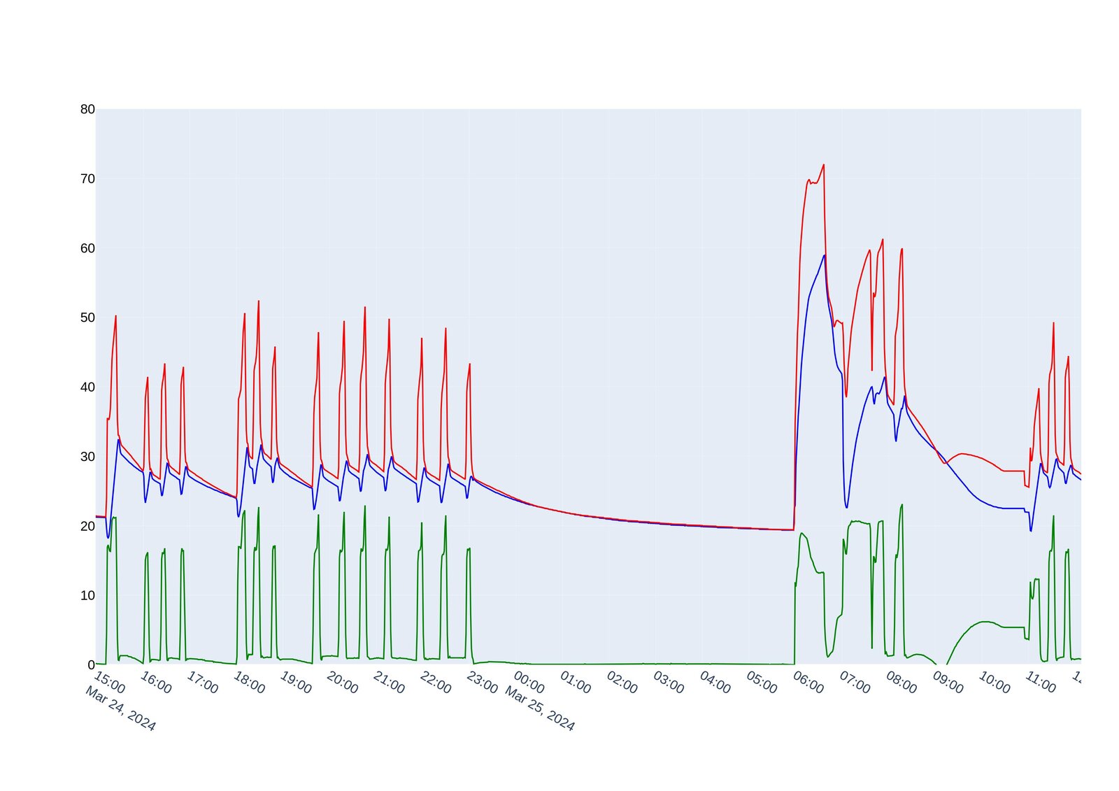

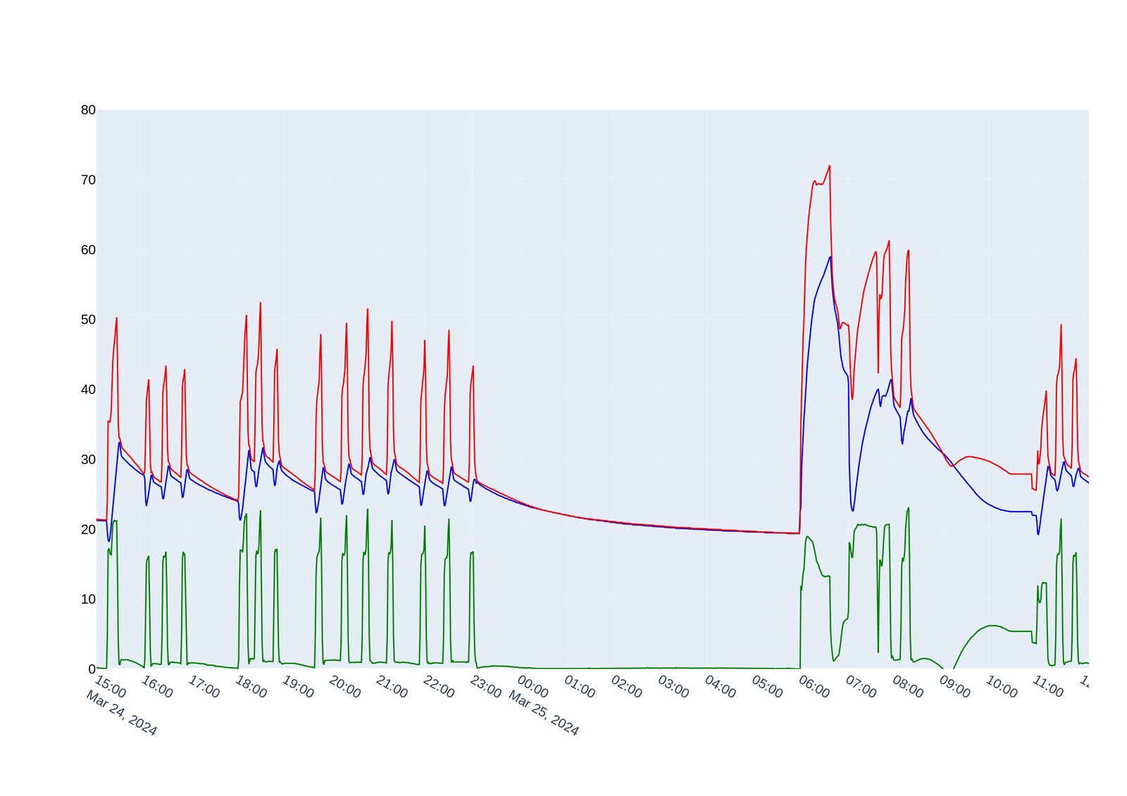

This is a 24hr plot from my boiler taken today. It always starts up at 6kW then ramps up after 5 minutes. This is easy to see on the green line. At 6.00 is a water heating cycle. At 7.35 there is 3 minute dip from a thermostat quirk, not a boiler cycle. At this point, return appears to level out in the 6kW region so this may have been a stable point at the instantaneous TRV settings (the TRVs try to find an average point and never swing quickly). Between 7.05 and 7.36 the green line shows that the F-R difference is completely steady, even though F and R are rising. If I change pump speed the green line shows a very clear effect.

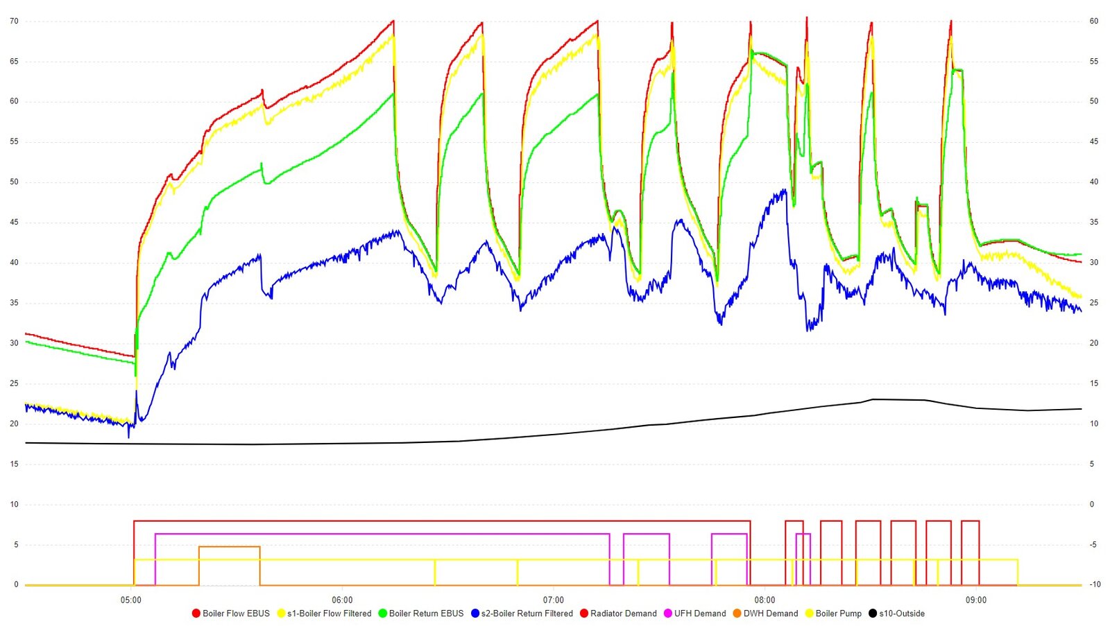

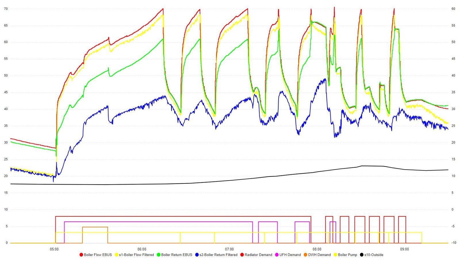

This morning the pump was on continuously as the house warmed up with 11.5min boiler anti cycling periods between. 11.5mins is the max at 65degC target so I may try reducing the target temp to 60 to get the anti cycling up to 17mins but need to fix the ABV over easter first
There is a very marked difference in the two trends, the one immediately below is exactly as I would expect on recycle, ie the flow&return temps merge shortly after the recycle starts but the bottom trend (from post #26) is different with the flow&return temperatures falling in steps over time?
The parameters difference is I think that the bottom trend is with d.2, the recycle set time set to 60 minutes and the top trend additionally has d.1, the pump overrun time extended from10 minutes to 20 minutes, is this correct??
My understanding is that the pump runs continuously during the recycle period (with pump overrun having no effect) and the pump runs for the overrun time and then stops when all zones programmed off or all stats satisfied.
You might try it with d.1 returned to its original setting and see does the trend then revert to looking like the lower one.
