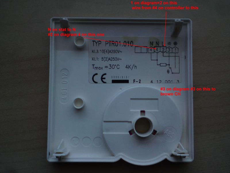

The Potterton roomstat terminal numbers are different from the diagram; here's a key:
Diagram = Potterton
1 = 2
3 = 3
2 = 4

the black is not used just had a look.there was a few wires in the wrong terminals acording to the diagram.just turned it on,the only problem looks to be with the room stat and CH zone valve.it is a myson power extra with a power indicator and it seams to be on all the time even when i turn stat down it is not closing the valve :?: does this look correct
You want the live feed from the clock ch on to come to number 2 on your roomstat, from the switched out which appears to be number 3 on your roomstat to then go the live on your 2 port ch valve.

thanks for the reply.when you say#3 on room stat to live on CH zone valve,do you mean motor open.because on the wiring guide thats what brown is.

thats the vavle wiring guide and it matches the s plan diagram,its a myson power extra valve for the CH and has a neon indicator which illuminates when valve is open and off when closed.now at the moment it just stays on even when i turn down the stat which should close it,any idea's why
Im not familiar with your thermostat itself, but their all pretty much the same.
Yes from #3 on room stat to brown motor open on CH Zone valve.

Does your stat have a rotary dial and does it click when you move the dial manually?
its all up and running fine now.i got broke off when i was doing it yesterday and put a wire what has no power in it into the stat and left the one with power out ,found it has i checked again and it all works like it should.thanks all for your help. :D
